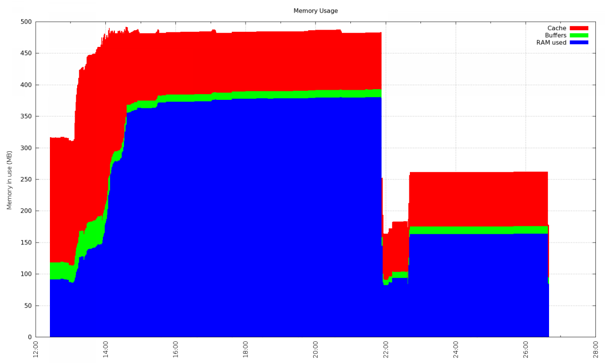

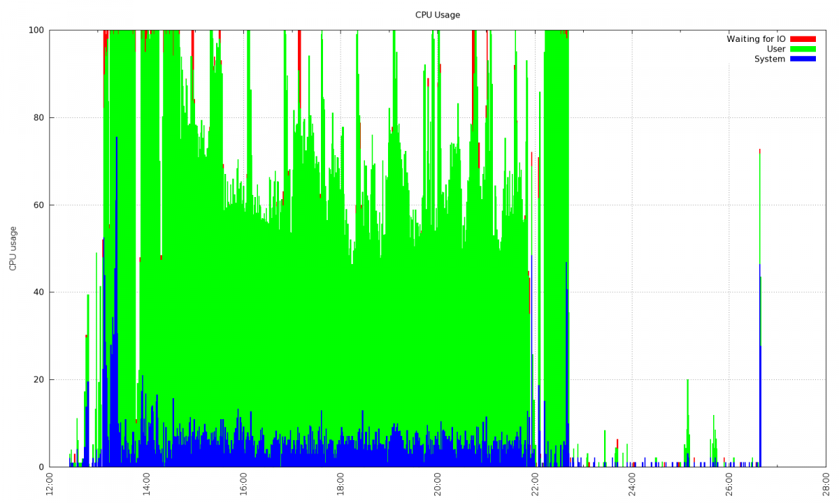

Downloading the newest version now. Just attached some plots from the old one in case anyone is interested. Run in OpenBox with CPU at 1.2 GHz and sysspeed at 440 MHz. Stayed steady at 15 FPS except for dropping to 8-9 FPS a couple times when a lot of chunks were loading (I think).
