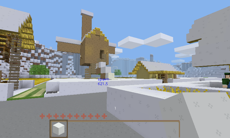

Runs very well on my CC with 4.04.00.01 drivers. Haven't built anything but walking around seems very fluid, also for chunk generation.
