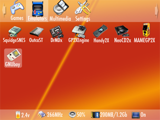

Looks ok but it really doesn't make good use of space. There are still only 6 things on screen to choose from and it is too linear. This means alot of scrolling to get to what you want. It looks PSP ish. Just because the PSP does it like that doesn't make it the best solution though.
A more practical grid like system where you could have multiple icons that can be selected by moving up,down, left, rght would make getting to things faster than alot of scrolling in 2 directions. Plus catagories on the top bar allow you to filter the things that you are looking for. You can also see alot more of what you want on screen with this matrix than just having a strip of 6 items that you have to scroll through and then having a large dead area on most of the screen. Use the space we have to make displaying your stuff and selecting. With the method below you can see 28 items instead of only 6. This way you can see all of your stuff and don't have to scroll alot to see what you want. What you have is just different but doesn't really give any more functionality or show much more items on screen than the default launcher.
There was a discussion about this and the style below was found to make much better use of screen space.
This screenshot looks nice and includes some elements that I had planned to implement in the future.
In my case there is only one vertical line for links because I needed the space in the middle for a big screenshot but it may not be that useful...
I'll seriously consider of changing the interface to be more like the screenshot you posted.

3. I agree with DaveC that using screen space for more icons (though not necessarily packed 50 to a screen) is a better use of space than the big screenshot.

I agree with daveC that more options on the screen would be great, but I also think the screen shot idea is snazy. Maybe a compromize can be reached between the two.

If I understood it correctly, DaveC's mock-up gives the ability to set the clock speed (and volume, by the looks of it) of the next app to run.
This seems to be an excellent idea, as there's no need for the menu to be at 266MHz ;)

You have to remember that this will be used over and over to launch apps.
The big screenshot may be nice the first few times you see it but after awhile after you get used to it and tired of it and you will just want to see more apps and not some big screenshot taking up most of the screen like a pop-up ad. I think after you load a NES emu a few times you will know what it is without seeing a huge picture of it ;)
The more apps that you see on screen (within reason, 100 would be too much, 28 like my example seems to be a good balance, not too many, not too few) will mean that you don't have to scroll around to see what is on your card and where it is. It is also easier to get to because a grid system is more "random access" and much less serial. This means you can get to the row and column by simply moving the stick in that direction. If you implement scroll wrap it further reduces the number of "moves" needed to get to your app.

@DaveC: I'm already redesigning the interface and it may be difficult to let the title of the link fit in 40/50px like in your mockup. Any ideas?
If you need such a long title you could have it pop up along the bottom of he screen instead of the CPU speed, battery, memory etc are when you select a certain icon in the matrix. Those things at the bottom now in the example really aren't needed. Short names would be used for the icons like the example.
