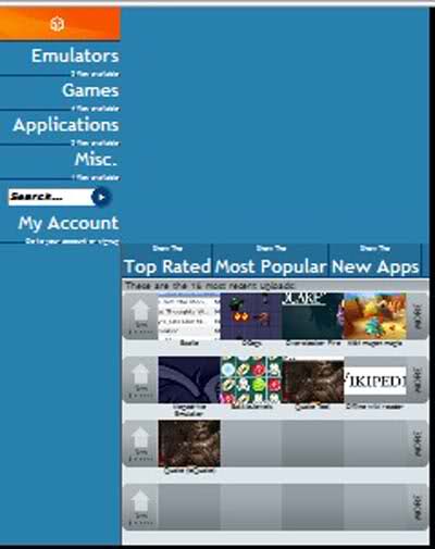

Interesting Firefox zoomout effect on the page: (I tried it to see it closer to the size it will be on a Pandora screen, I don't have any Iphones or Nokia N800's :P)

in regards to firefox zooming. its not a feature that you will really be using on the pandora :P ... anyway i could fix this
