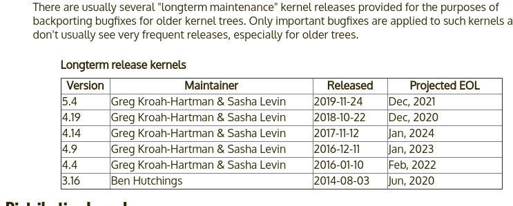

...but kernel 4.14 will be supported till the end of 2023, so enough time to fix the tiler-problem or do we need a higher kernel version for other reason?
True, but every new release kernel adds more and more stuff on top the previous one.
So updating the TILER stuff from 4.14 to 5.5 is probably a lot more work than from 5.4 to 5.5, as more stuff has changed.
