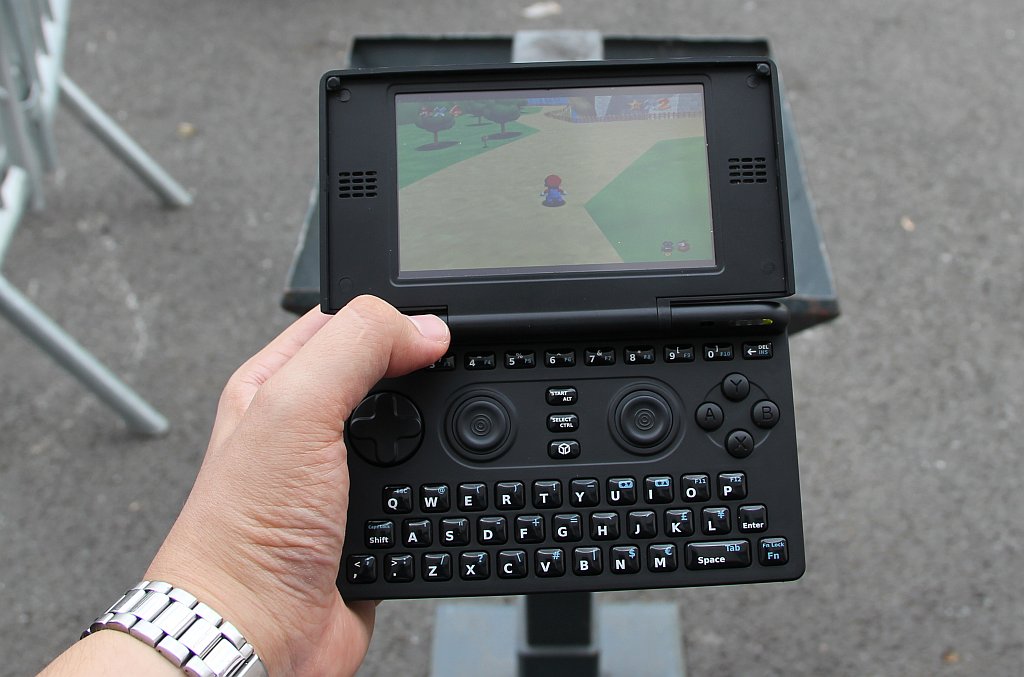

It's the face button farthest to the right that's the biggest problem unless we want to extend the case easterly, which would then make the inner keys like Start much more difficult to press.
This pic shows we can either add two face buttons upward or to the left of the A and Y, if we're feeling adventurous with the design without adding dimensional width. Increasing the size of the case instead would mean we're leaving pocketableville and encroaching on netbook territory.
I don't have a Pandora handy and I'm curious if you Natsu or anyone else feels two extra buttons added as in the "Genesis" layout might be possible and workable with a right thumb on real hardware. ^_^
I don't either, the thumb shouldn't be able to go as far as the ring around it. The Genesis layout should work. That said, if we get rid or move the del/ins and move the buttons inward a little, it should fit similar to what I shown. Adding a bit more width won't hurt either. 3DS XL style. :P
No. In fact, it's actually quite unnatural to move your thumb in that direction. The buttons need to move in a Southwest to Northeast slant to follow the arc that the right thumb traves when it pivots around the joint. This is essentially 3 rows of 2 instead of 2 rows of 3.
