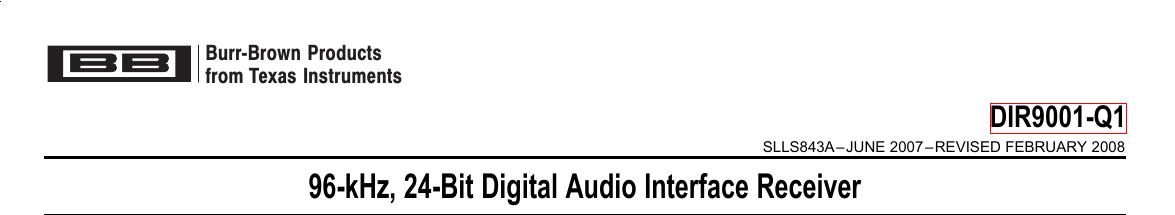

				An audio DAC can always only do one frequency and nothing else. Everything needs to be converted to it...some of this may be a bit over my head, or perhaps I'm miss-interpreting something, but does this mean the audio chip can currently only support nothing but 96kHz 24 bit audio because certain parts of the api aren't quite up-to-date or because the audio chip can't handle anything more/greater than 96kHz 24 bit audio without down-converting it? this sounds troubling...
Is it this chip ?
You should try that one day, but I wouldn't be surprised, if you report bleeding ears.48 goes into 96kHz a lot easier (just repeat each sample twice)
For the conversion, the chip we use can use an internal hardware. This setup is called the ABE / AESS (ABE is Audio Backend).
So basically, for the current kernel, only the driver for the DAC exists, not for the ABE. So any conversion needs to be done by the software stack, which needs processing power.

Can someone update this page https://pyra-handheld.com/wiki/index.php?title=Audio with information about audio chip.No, we're using the TWL6040.
