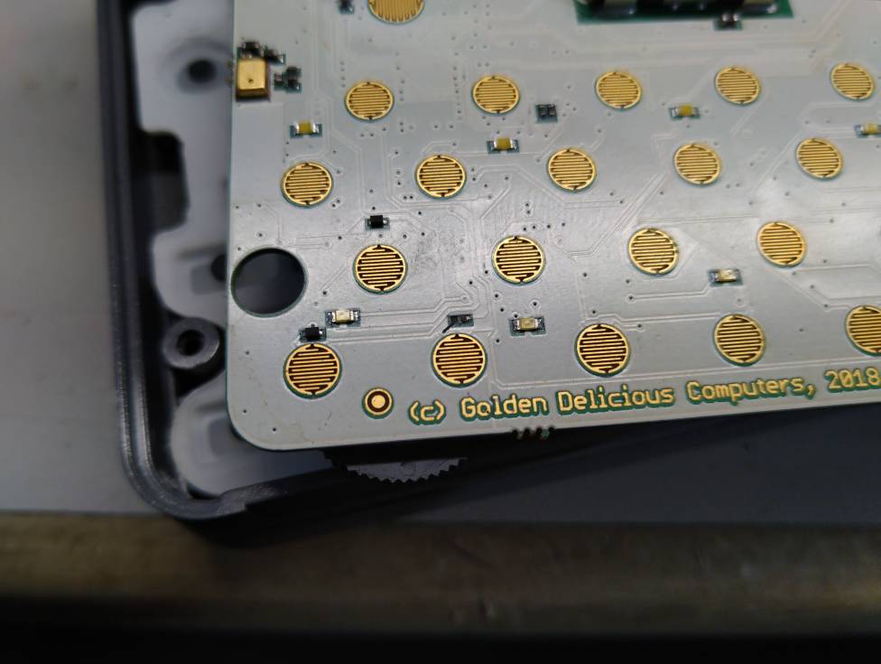

Quick update:
The first prototype preorder has shipped and should arrive on Monday.
Four more are planned to ship on Monday - we just had a few issues flashing the OS on the internal eMMC. It flashed but it doesn´t boot so we probably have a bug in the flasher script.
I´m having a few issues with two more where some keys are not working. I fixed that successfully on a different PCB - but these two have the problem that the diode is not missing from the board - the trace has been ripped as well. See it on the second key from the left...
No idea if I can fix that, but I have some more boards left to test.

On the major plus side, the benefits of repeatable (and automated where possible) testing are abundantly clear !

Also, please note that they won't ship necessarily in order - as there are some various configurations of the PCBs the preorderers wanted, so no need to hold on EU units if those work fine and I need to fix some US boards.
Additionally, I've put the PCBs into the units and then started to fix them... I don't plan to mix and match them, so the order can be a bit different.
I think yours is included in Mondays shipment (if we can get the eMMC flash to work until then, but it should be something simple).
