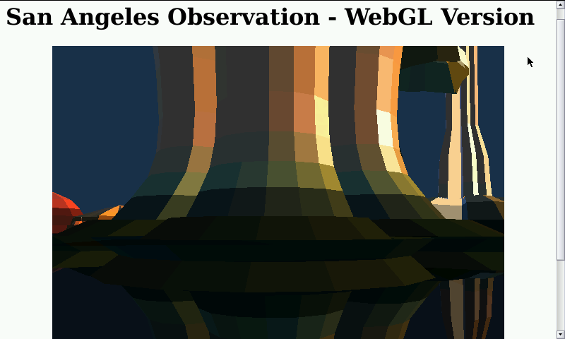

Build 02 is on the repo. The Profile wizard should work now. Download are temporary donwloaded inside appdata/palemoon/tmp and WebGL is activated. WebGL is kinda slow, because it's offscreen rendering using PBuffer. So don't expect more than 12~15fps on a Gigahertz. But it works.
Build 02
  • Fixed Profile wizard
  • Redirected tmp download to appdata/palemoon/tmp
  • Enabled WebGL
