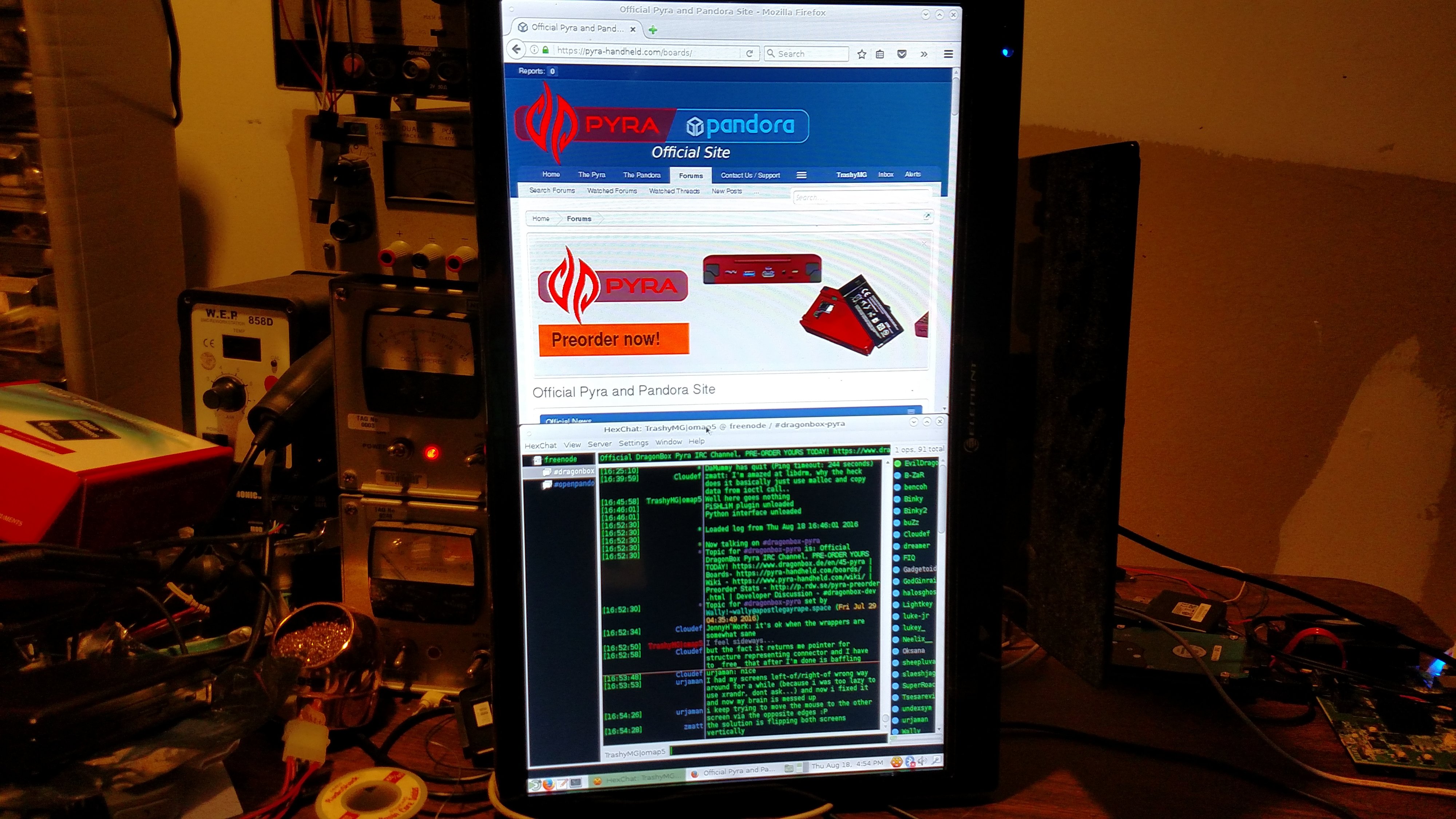

Played around with the new TILER enabled kernel, thanks to zmatt and aTc updating the Pyra Debian repo. Sorry for the audio static.
Eh? I tried to follow IRC, but last thing I've seen was that it was working but crashes with fbturbo in X...?
That was 5 days ago
Did you fix that?
Yes, and it was celebrated 19 hours ago. You missed the party. There was cake. It was delicious.
Also I posted that I fixed the problem on the pyra kernel mailing list and cc'd you.

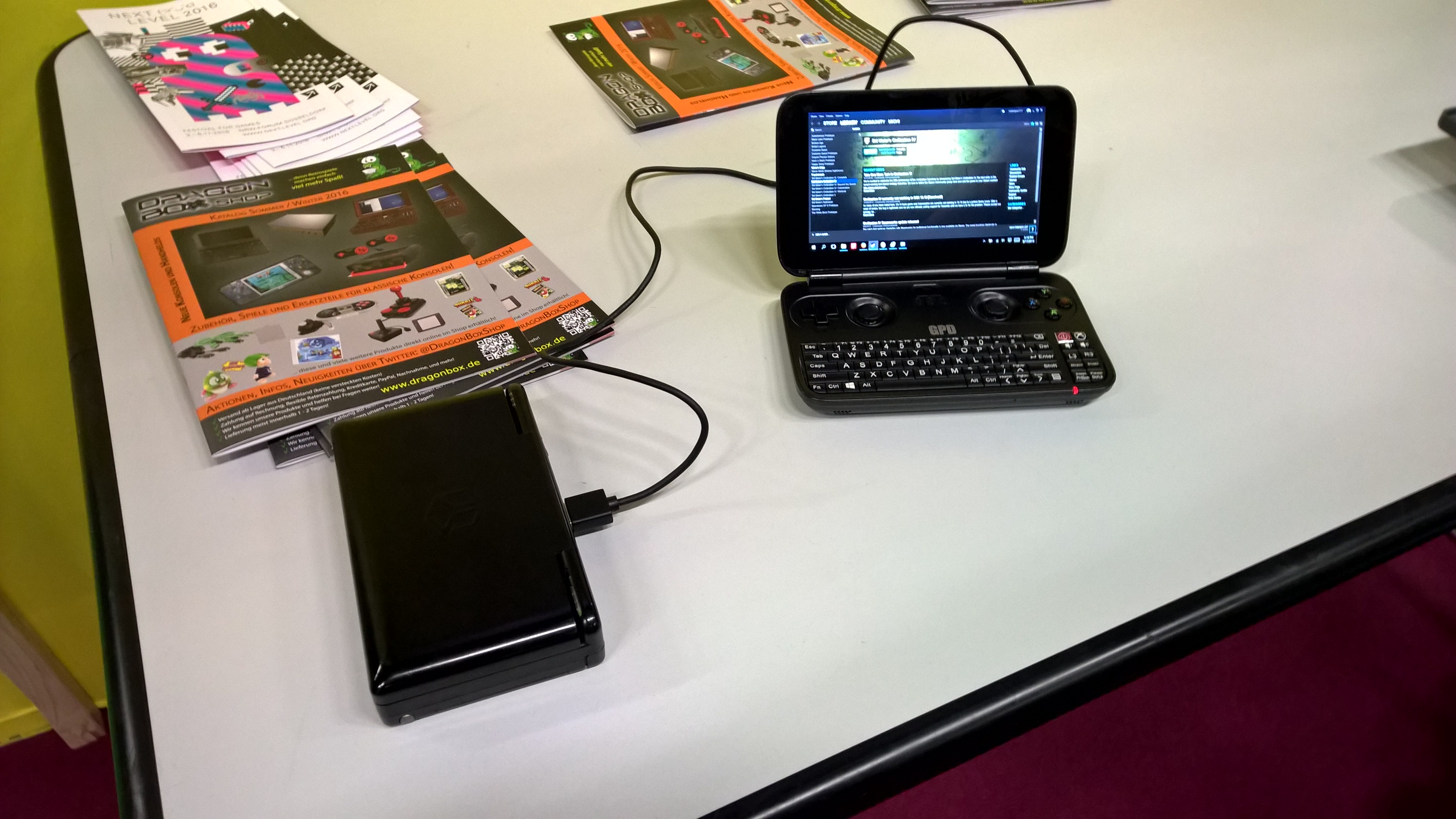

On the main stage (table next tot the booth) there were the Pyra and the GPD-Win, the GPD-Win had an additional battery pack as it ran out of power (also the Pandora could charge the GPD-Win).

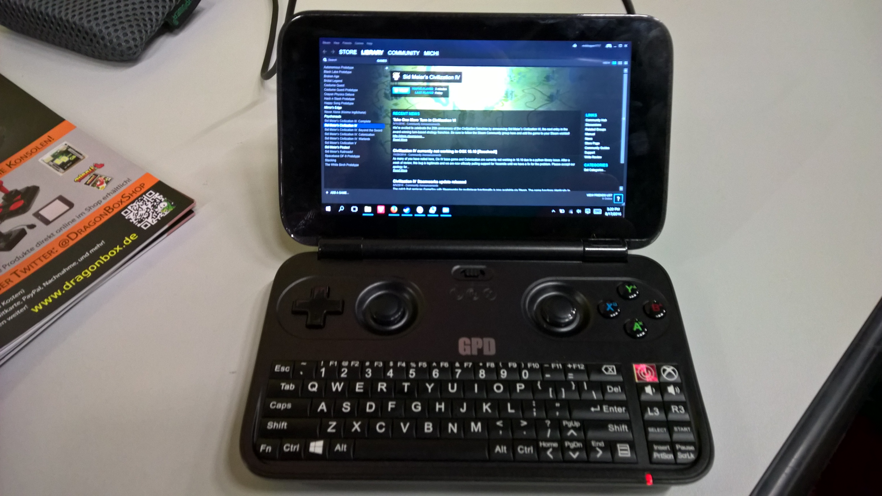

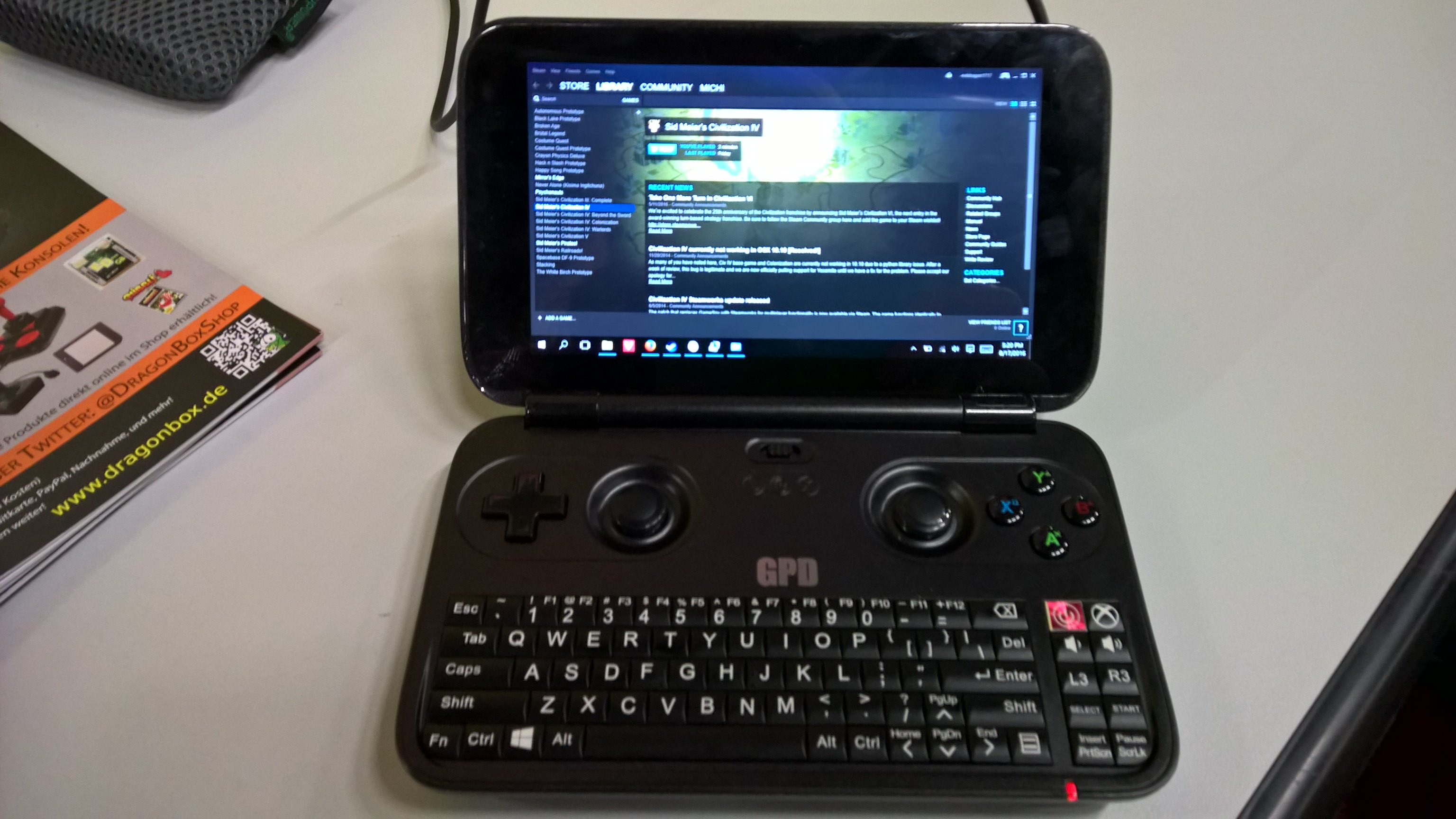

The GPD-Win was also available. First impression was that it looked more shiny, which looks a tat more sleek then the Pyra, and it felt a bit lighter. When holding it I noticed it was a bit warmer then the Pyra was (didn't notice any heat from Pyra btw).
Steam was open and I notice that was hard to read from the display, but you could configure font size if you would dislike this. I noticed as I could read clearly from the Pyra screen (the unit still had the discolorating touchscreen) but not from the GPD-Win, but I guess that's fixable as both devices have 720p screens.
The keyboard is default lay-out, which in my case makes stuff easy to find, but it's so cramped it makes it hard to type. The keys did feel plastic-like, but worked. The triggers felt really flimsy (big plastic buttons that react late), while the Pyra ones felt they reacted faster and has less travel.

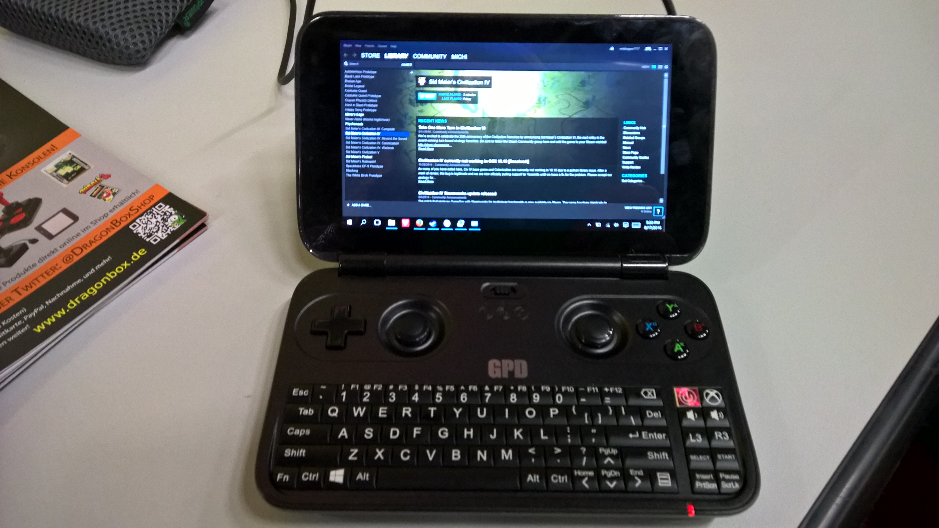

The GPD-Win (you've seen the Pyra, right?)

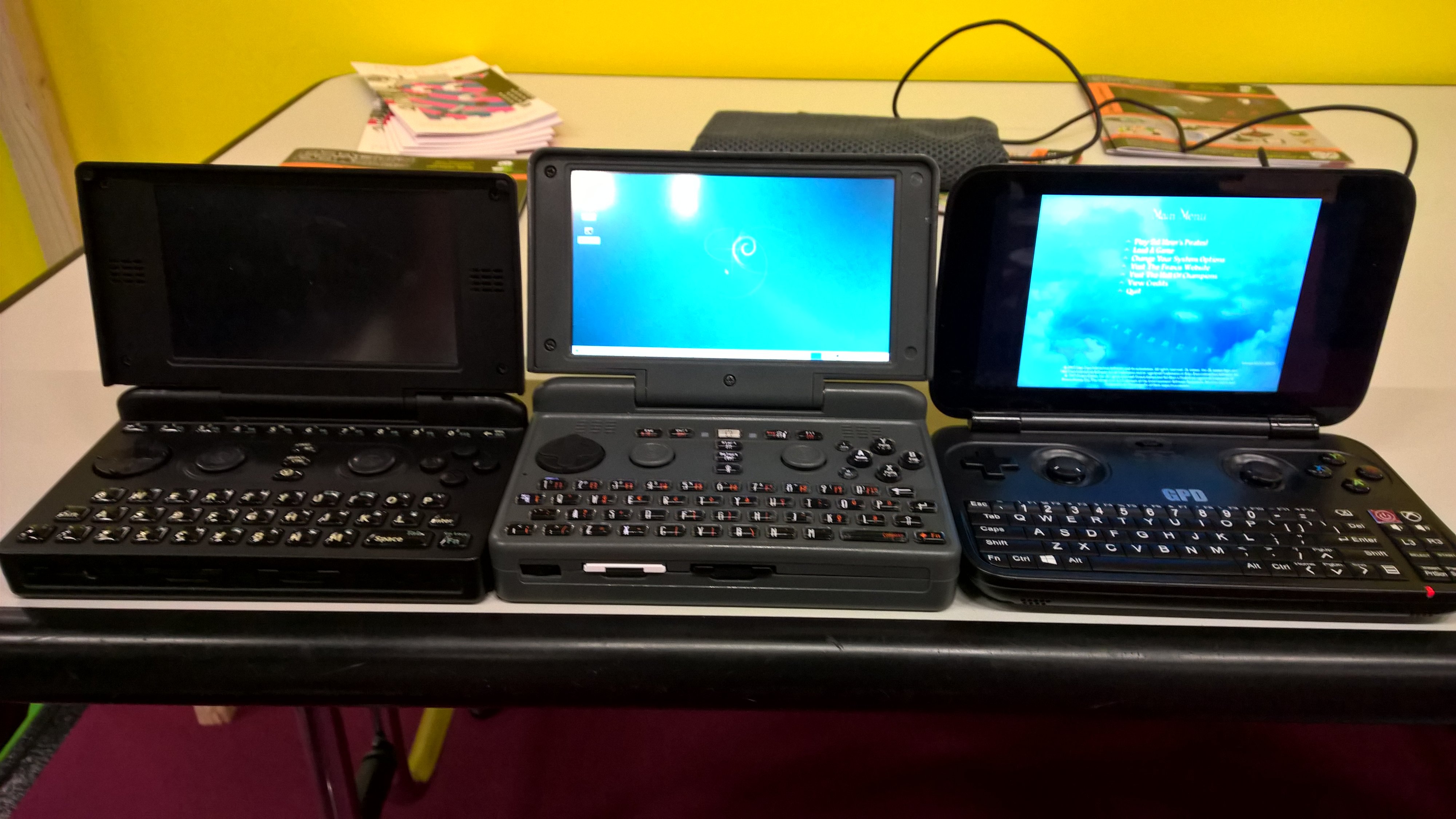

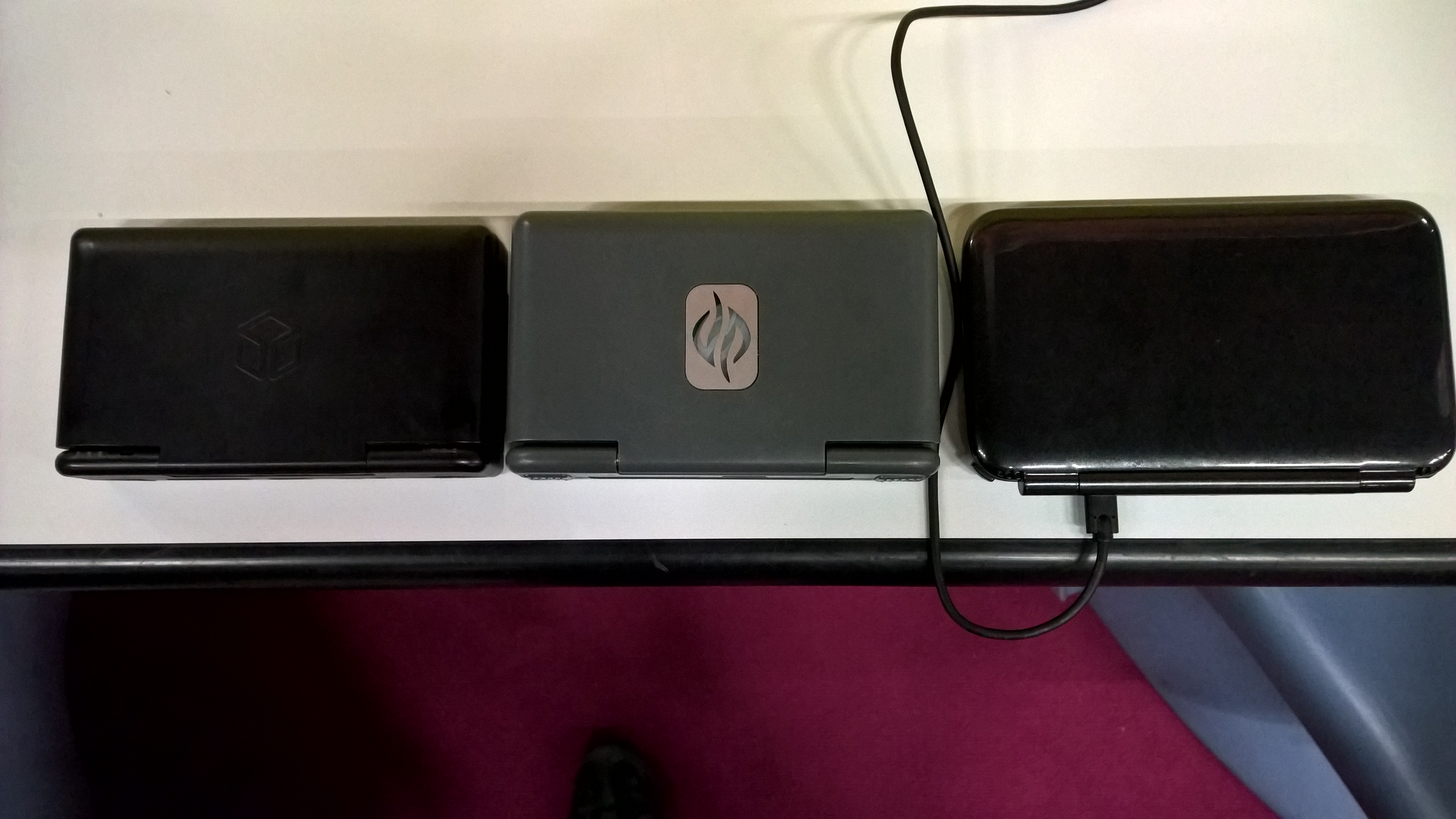

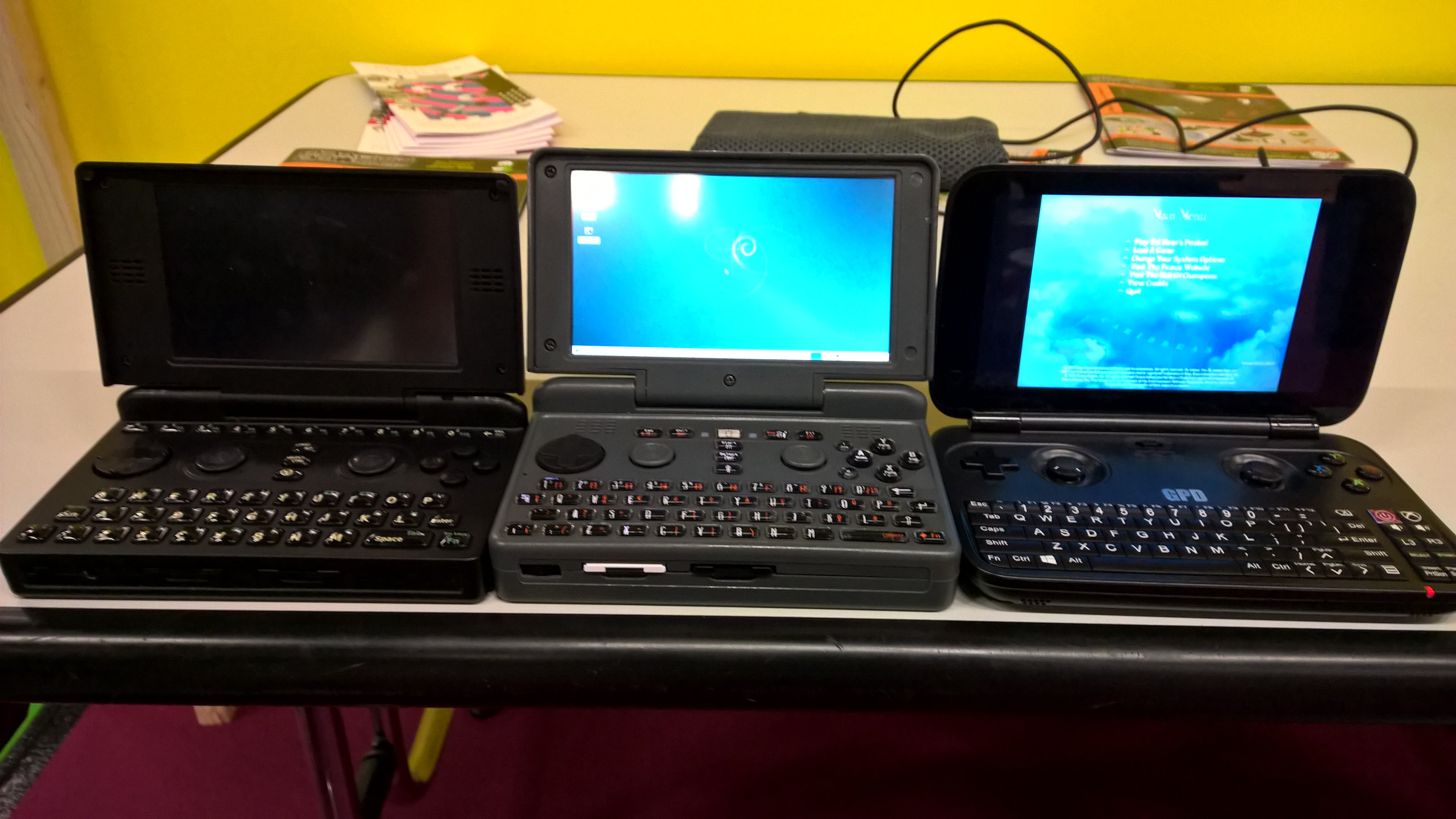

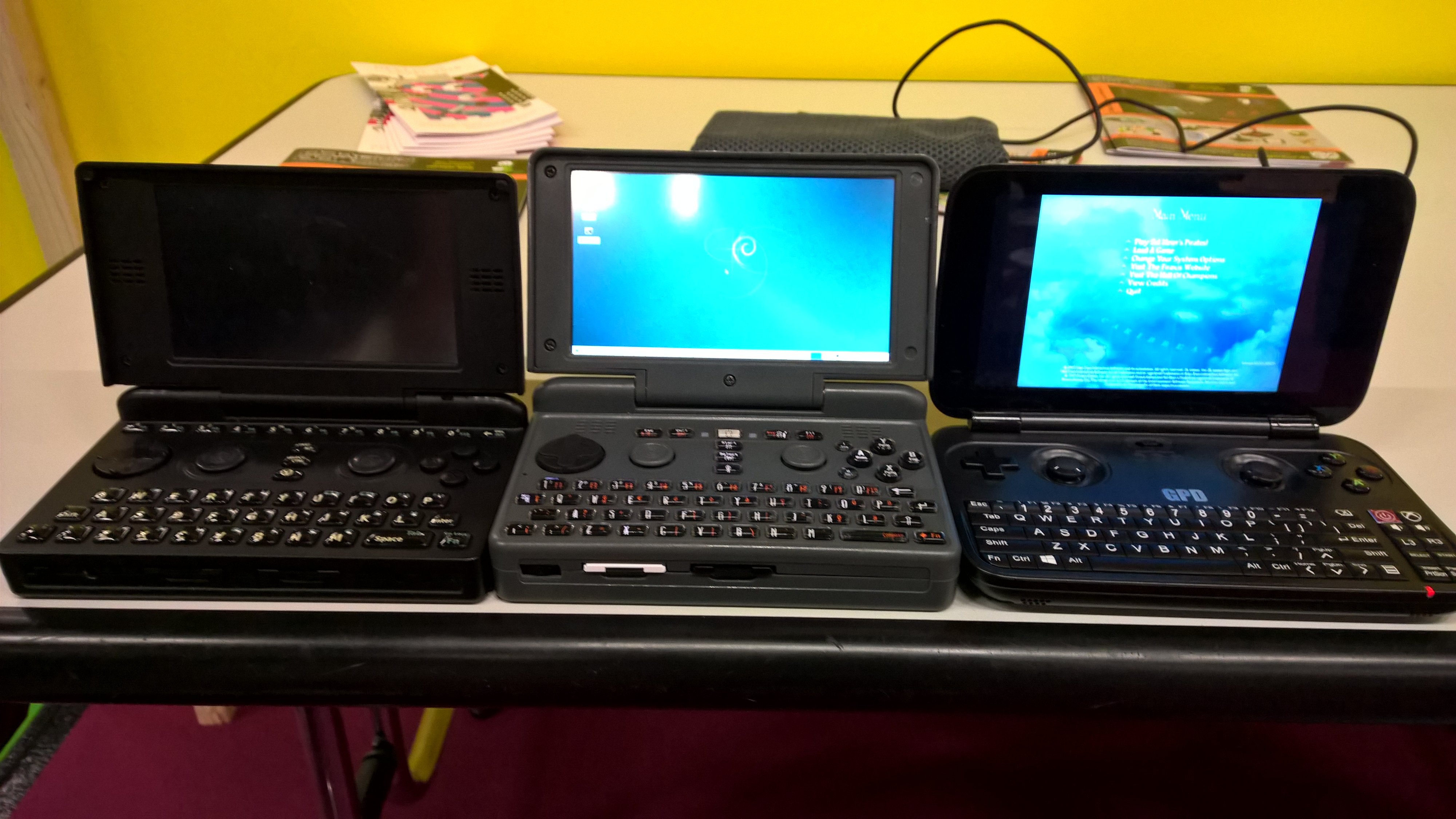

Groupshot, my Pandora, the Pyra and the GPD-Win

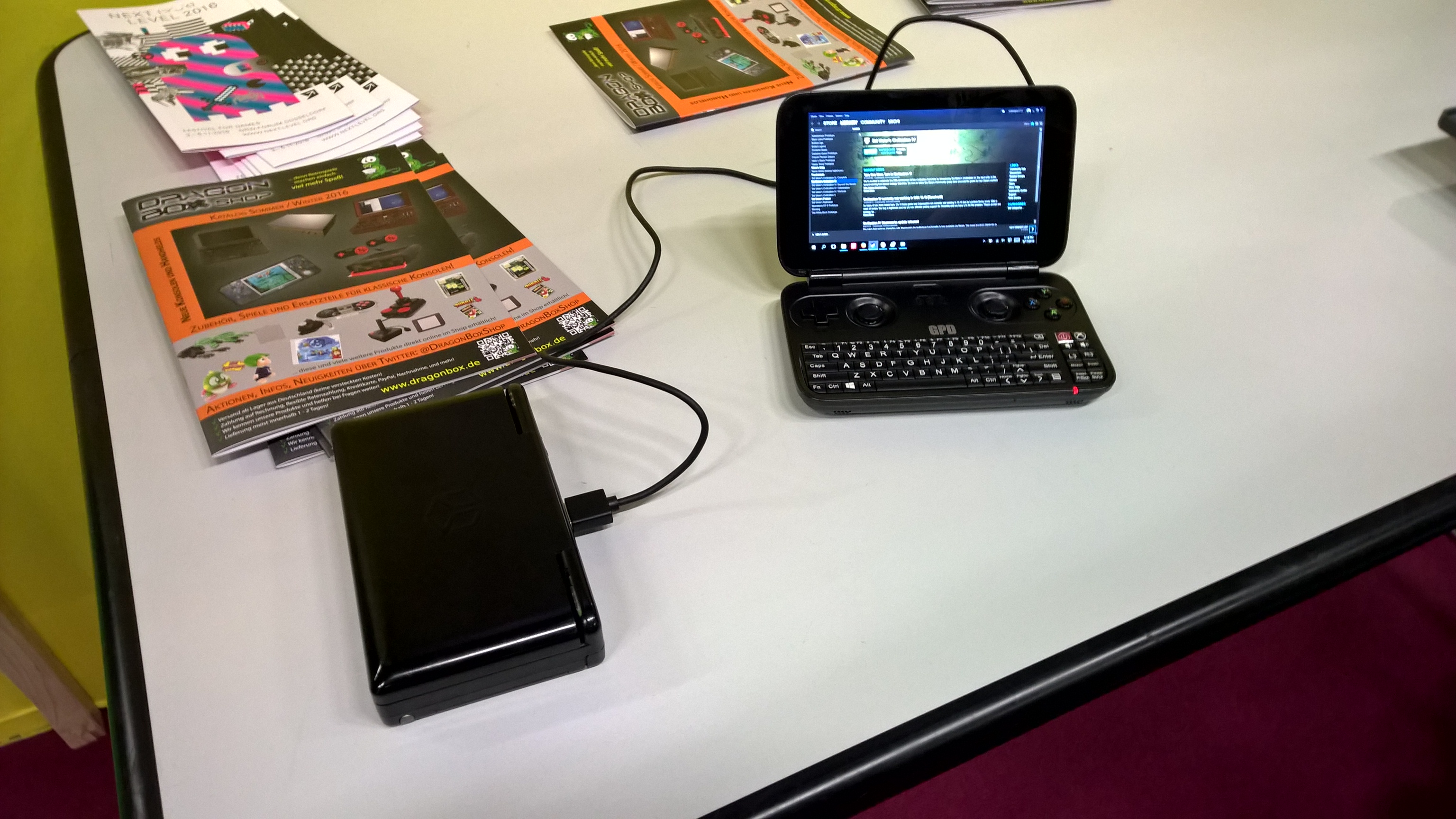

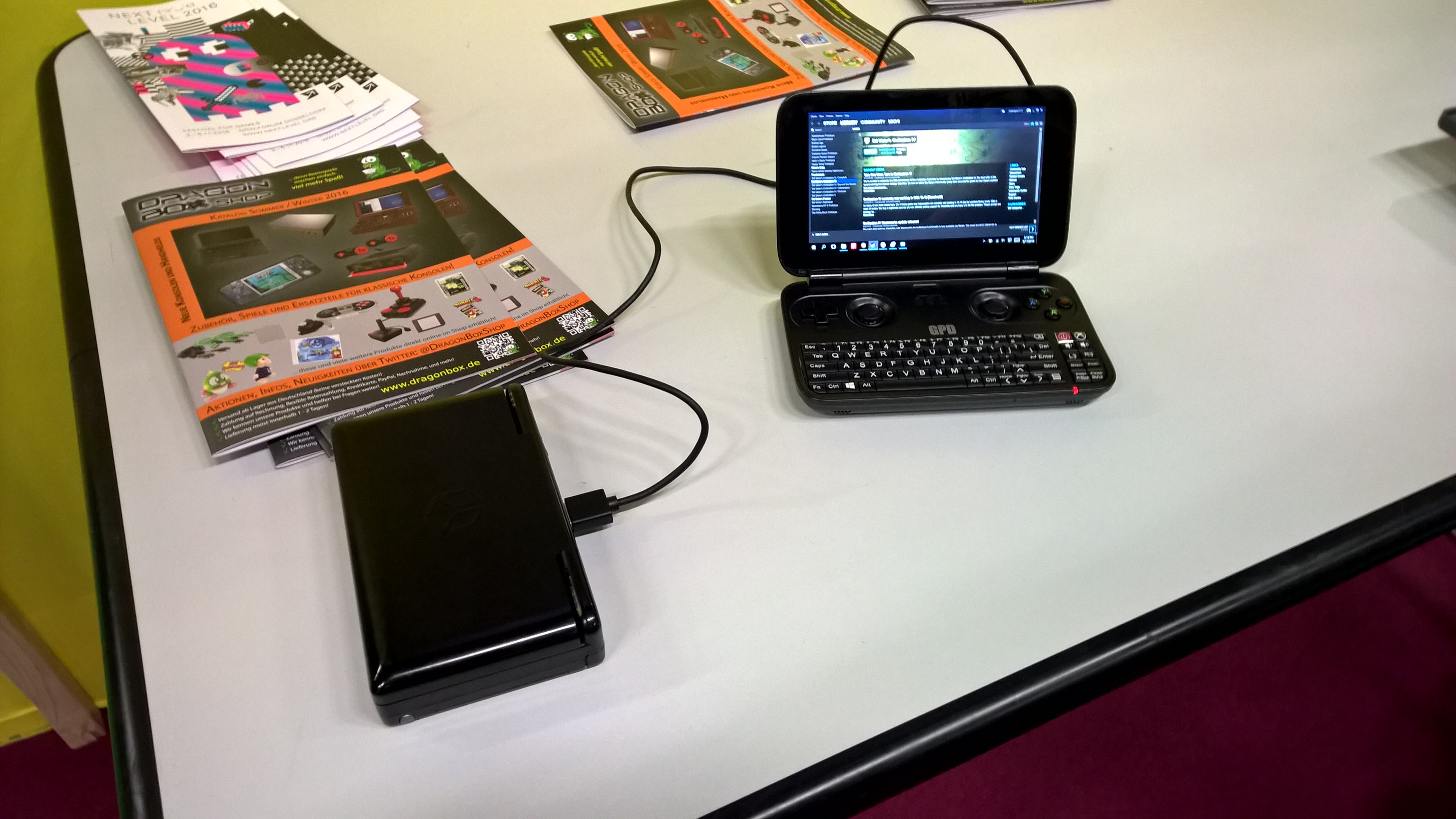

Need some more power GPD-Win? Did you know you Pandora can be used as a charger?

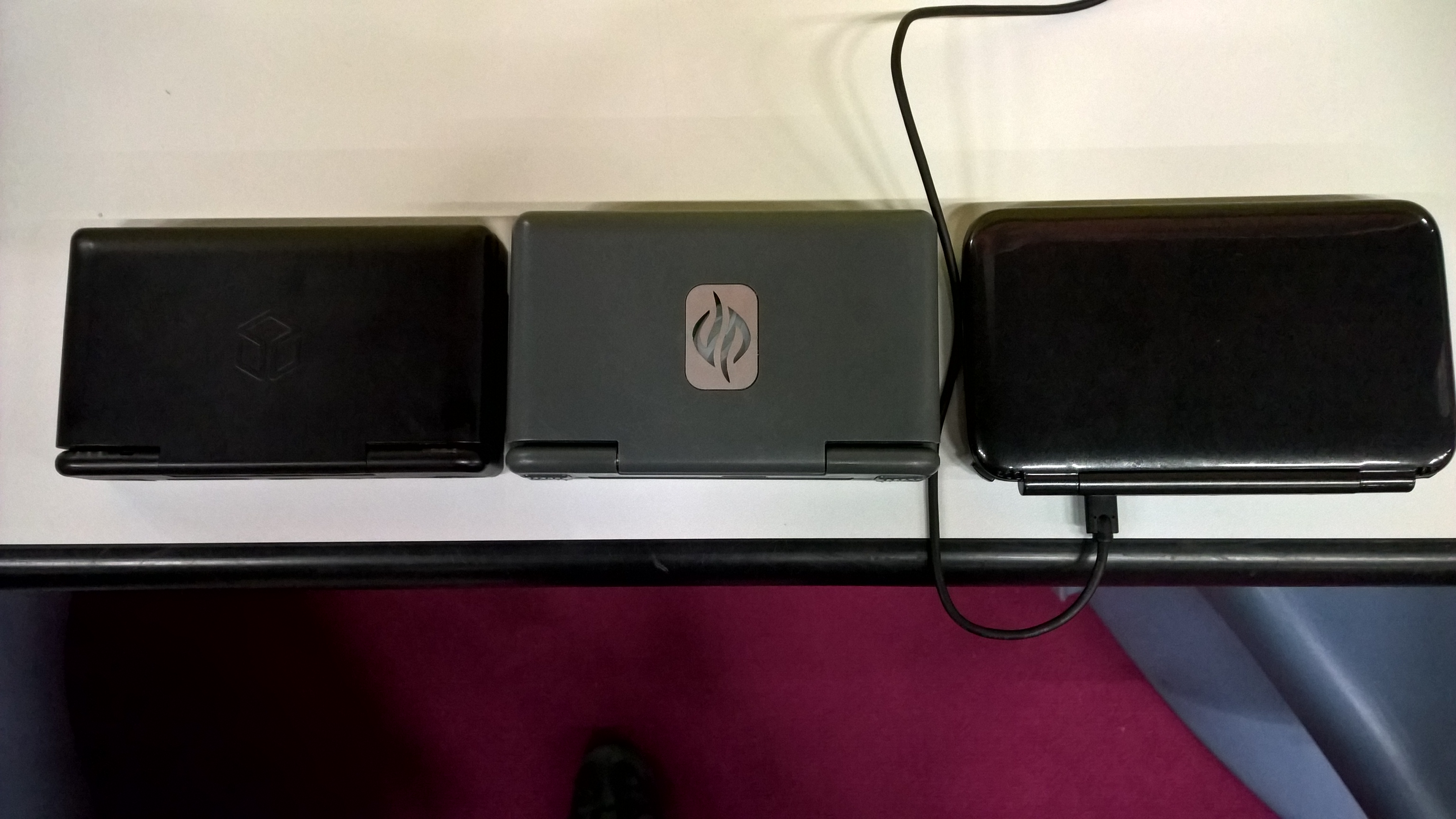

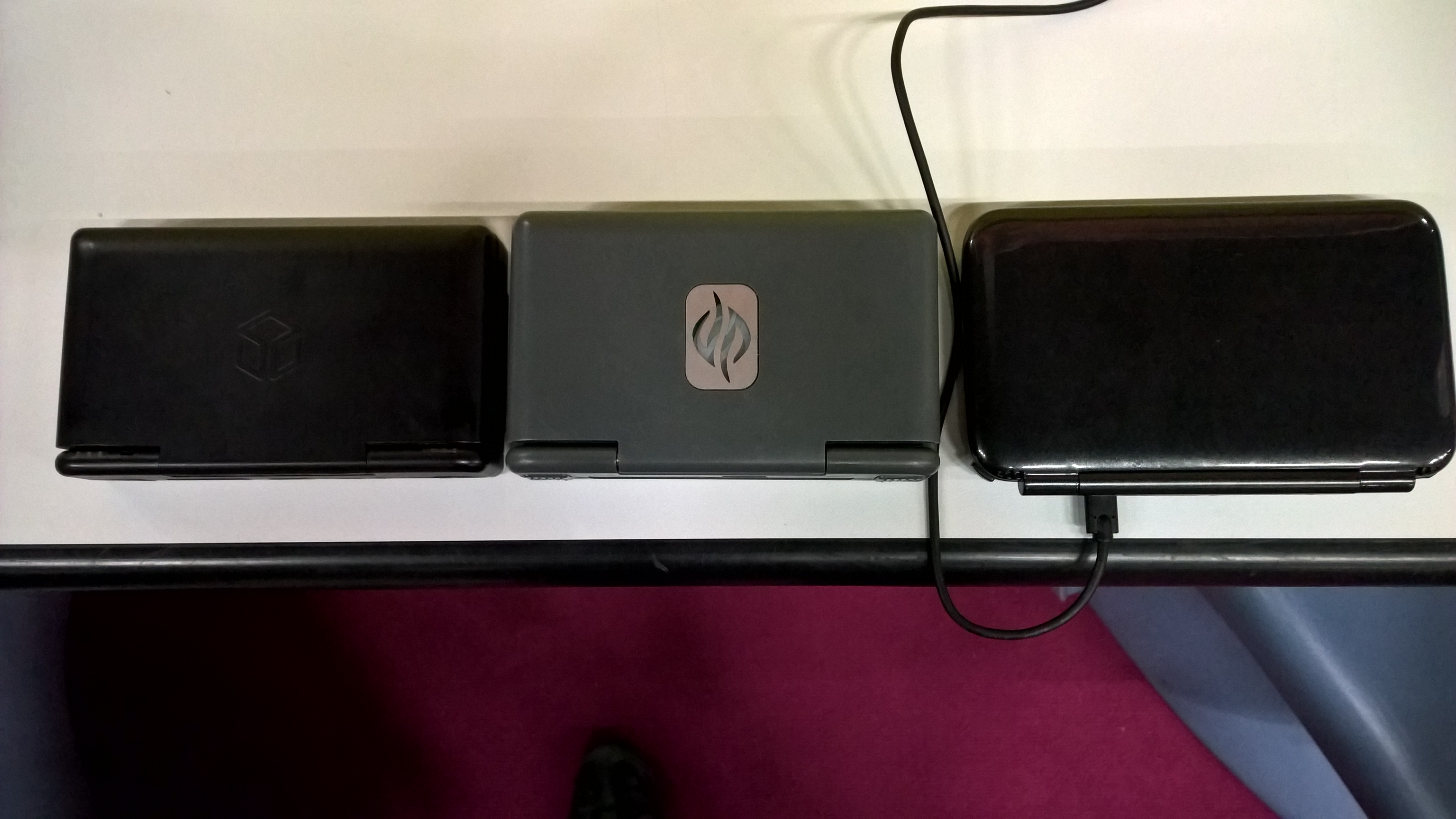

From the top (the Pyra logo fell off)

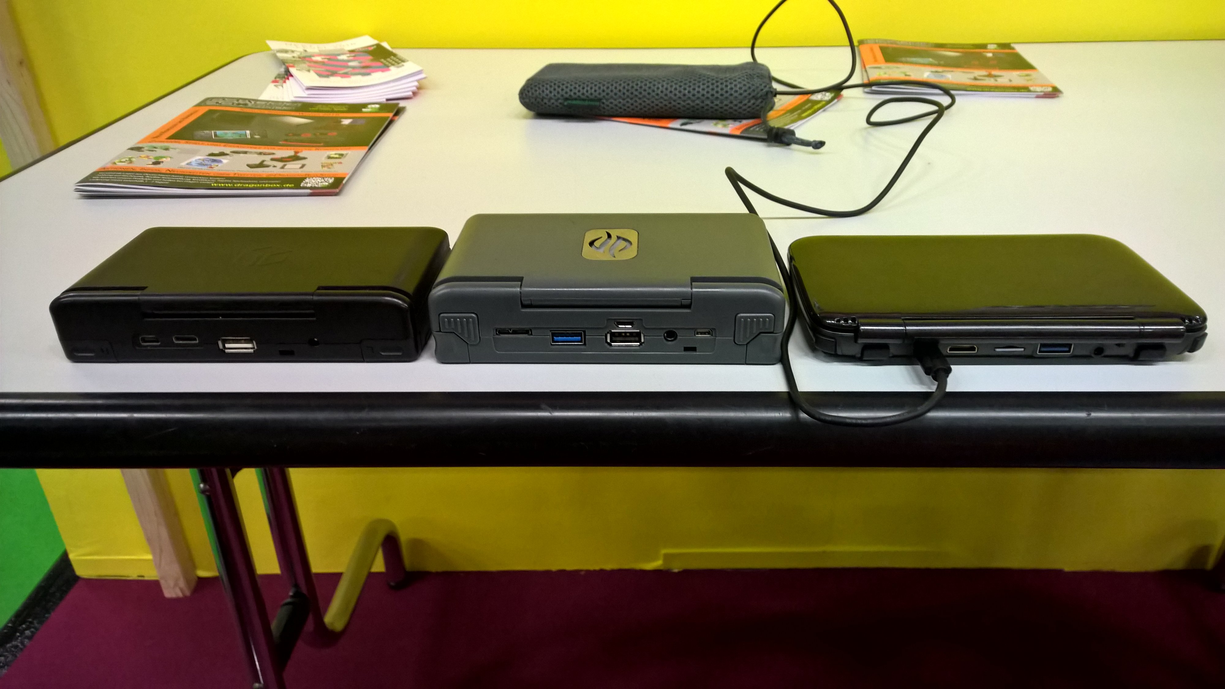

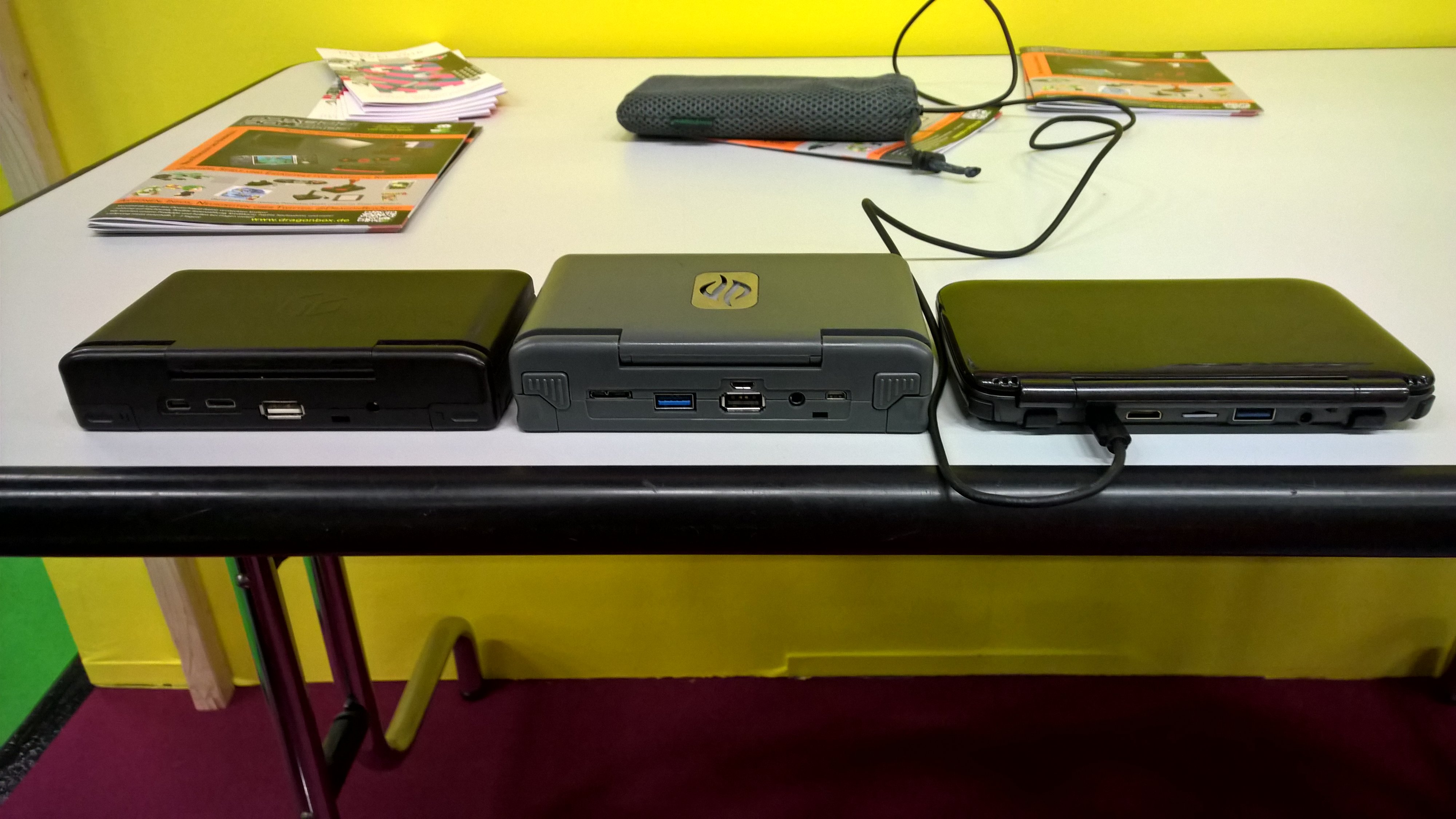

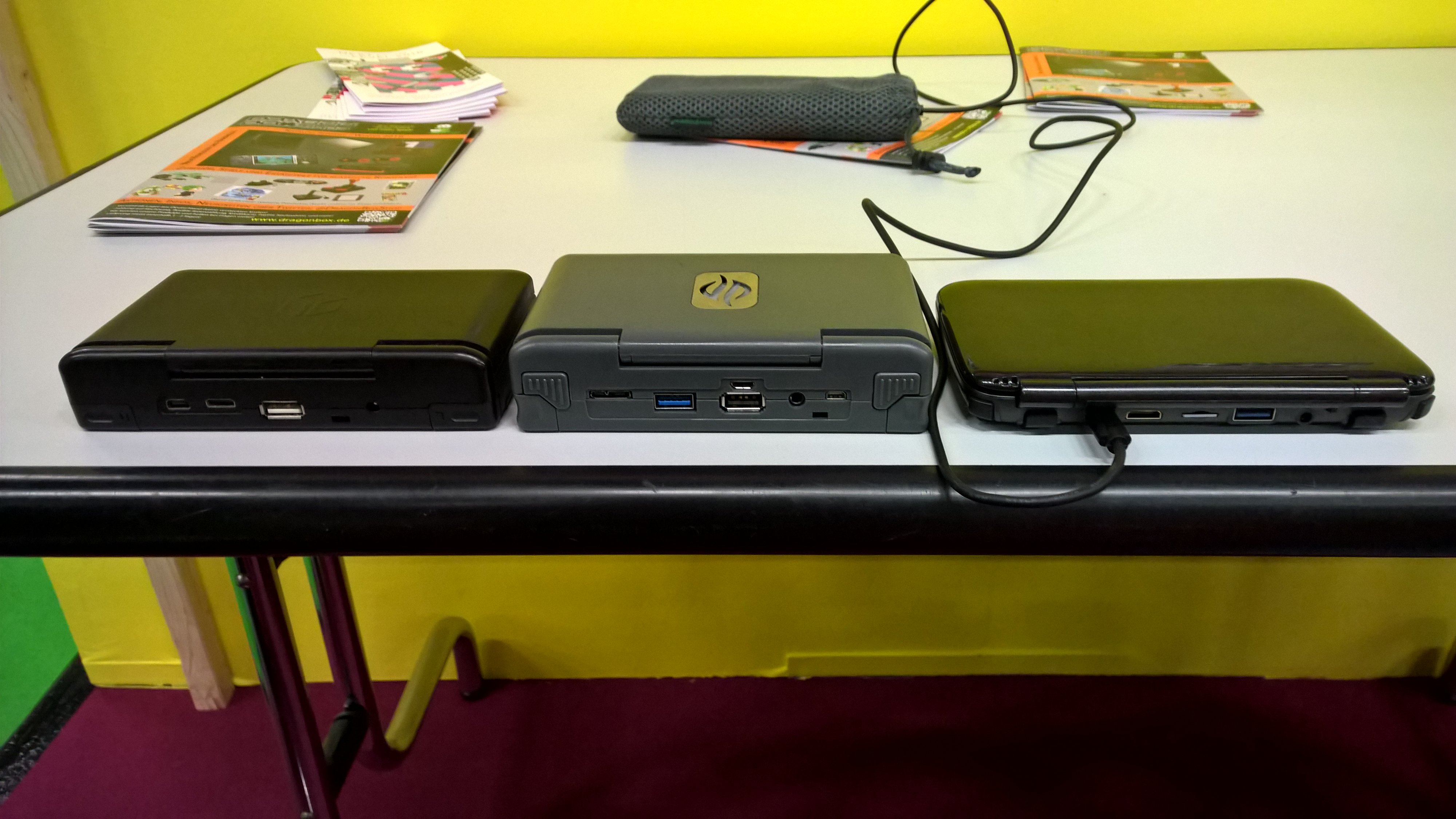

Showing the ports on the back (Pandora/Pyra/GPDWin)

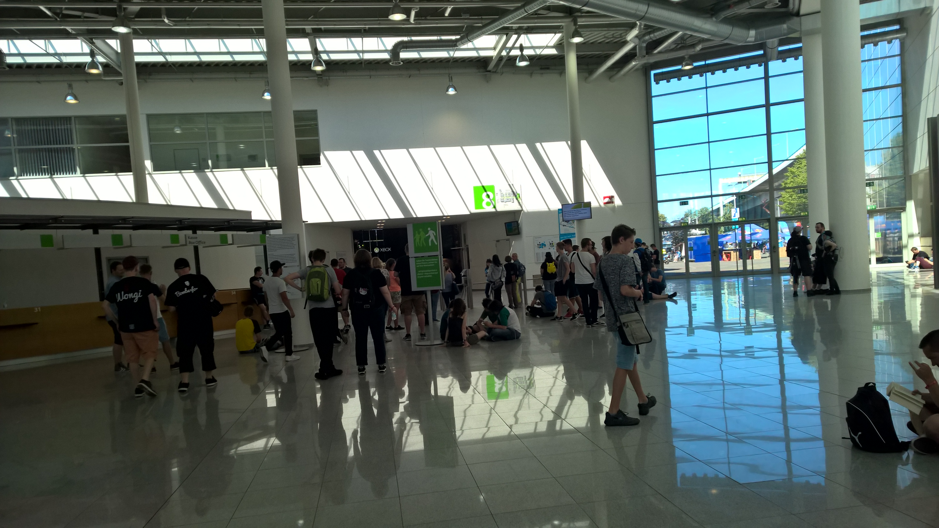

[doublepost=1471478971][/doublepost]In case you ever wonder: Is it busy on Wednesdays?
This was the line when entering the north entrance at Kölnmesse for me today.
