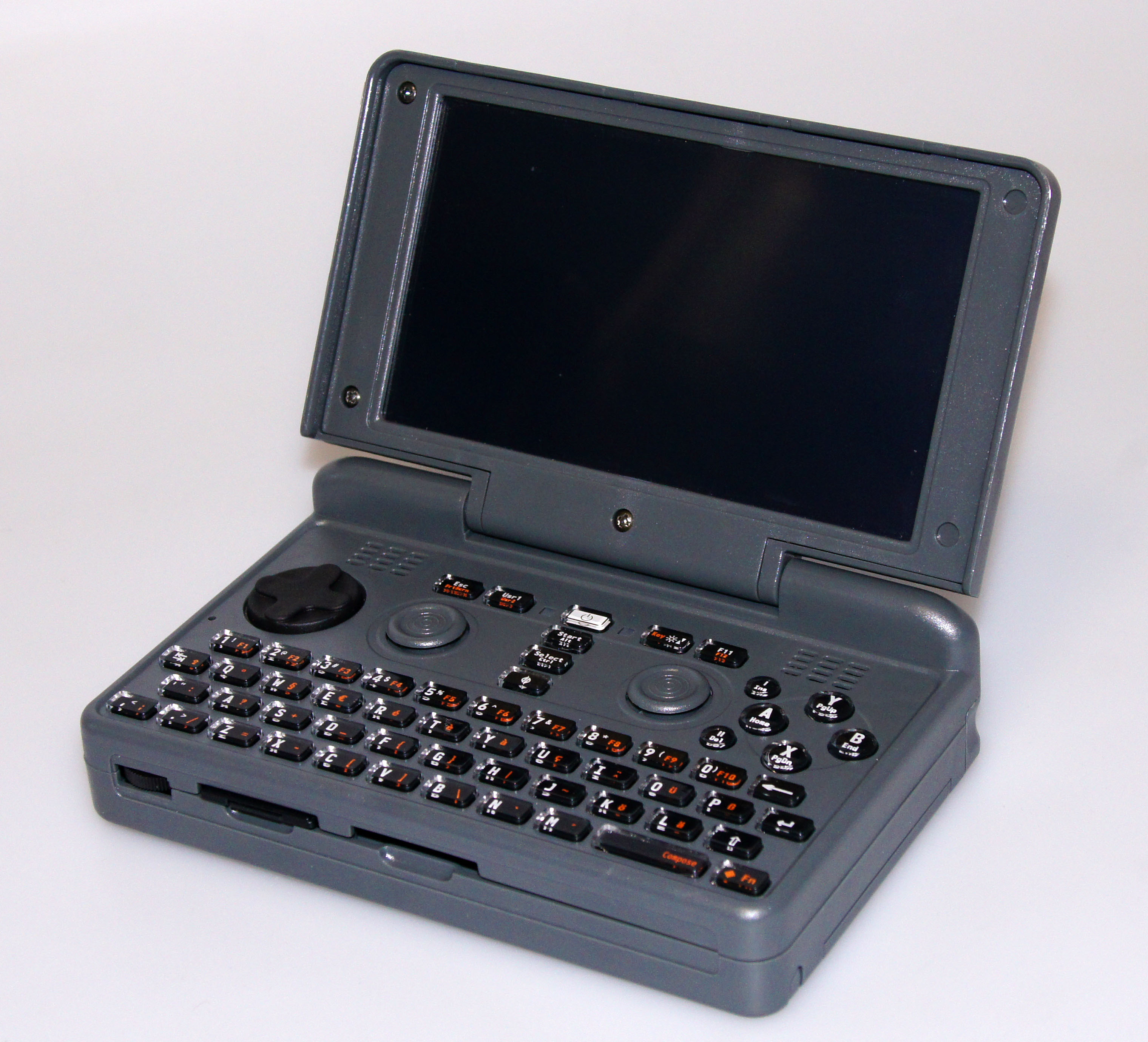

Here are some pictures of the two cases I received. One is gun-metal grey which doesn't look too bad, but for my opinion, it would look better if it's darker.

Okay, before looking at the pictures and the video, here are some VERY important informations:
- The cases are almost done, but not 100%. So some areas still have some gaps. Don't mind them, they will be gone in the end.
- Especially the front looks bad (with the bent case and a huge gap): This is because the protoype PCB of the CPU board is colliding with the Wifi chip (an edge needs to be cut out there), so that additional height pushes the whole case open. This will NOT happen with the finalized PCBs
- You can see shrinking marks and discolorations on the cases. This is because the mold is not yet hardened and the machine has not been adjusted. Want to know more details? Read the spoiler. Otherwise: Just be assured that the cases will NOT look that ugly when they're finished

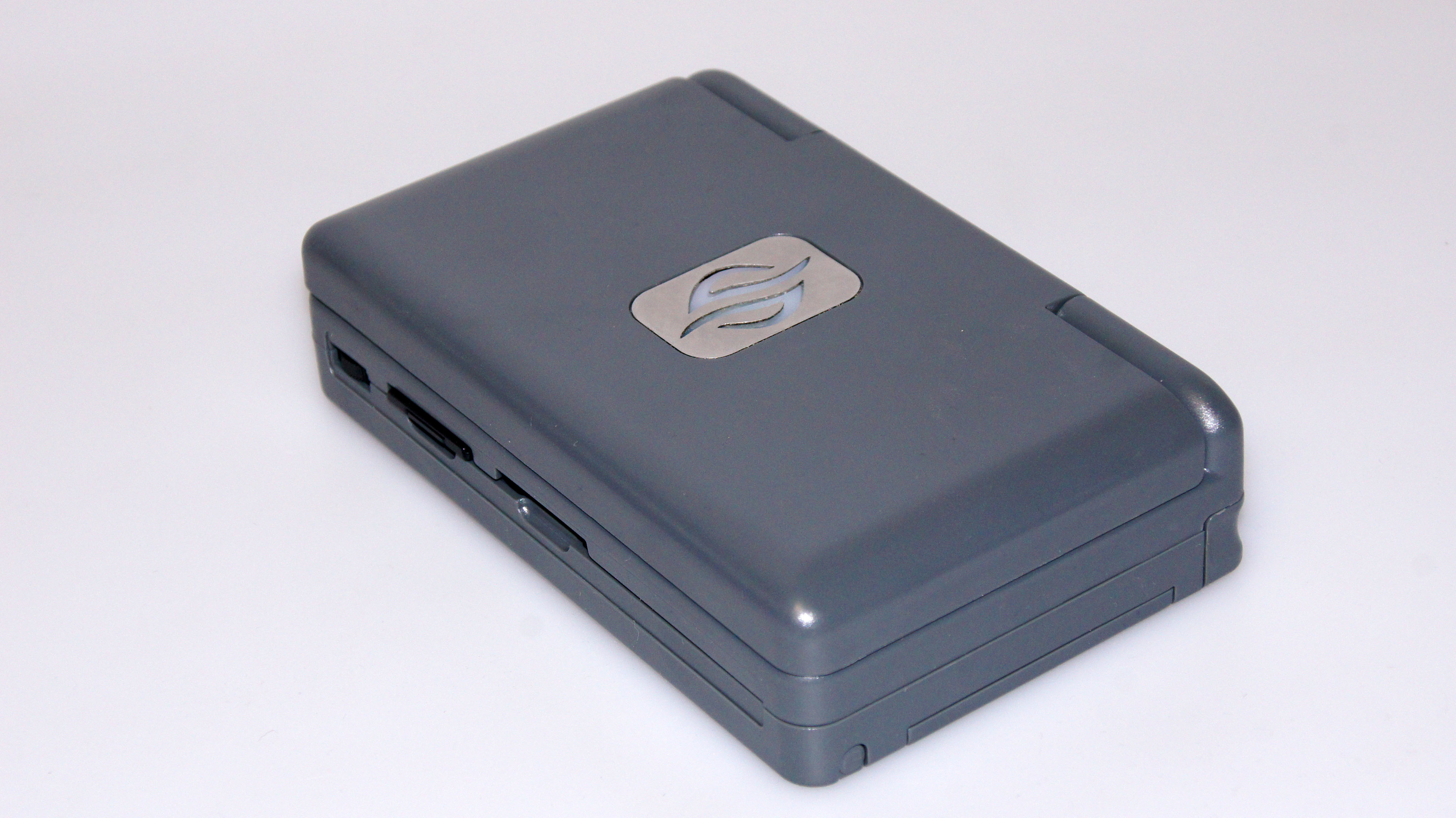

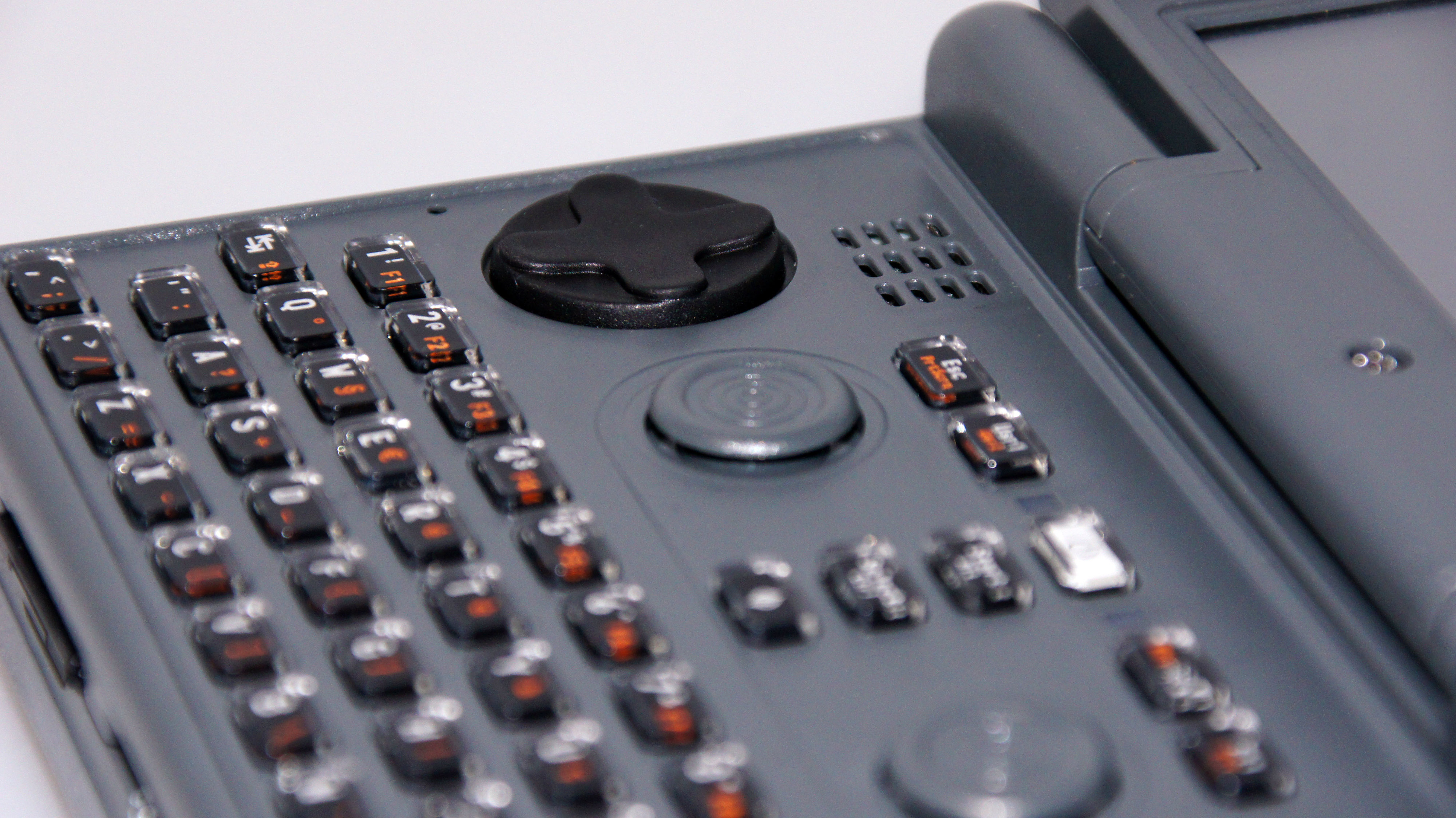

![GMClosed.jpg GMClosed.jpg](https://www.pyra-handheld.com/boards/data/attachments/28/28554-dd6e36de9a4b33cd8ef2e6dad252f564.jpg)
![GMOpen.jpg GMOpen.jpg](https://www.pyra-handheld.com/boards/data/attachments/28/28555-19a05f0f9997d4f6e4c15434157048ae.jpg)
![GMSide.jpg GMSide.jpg](https://www.pyra-handheld.com/boards/data/attachments/28/28556-a0383a2c7a38df1cdcb31621f2b21d9e.jpg)

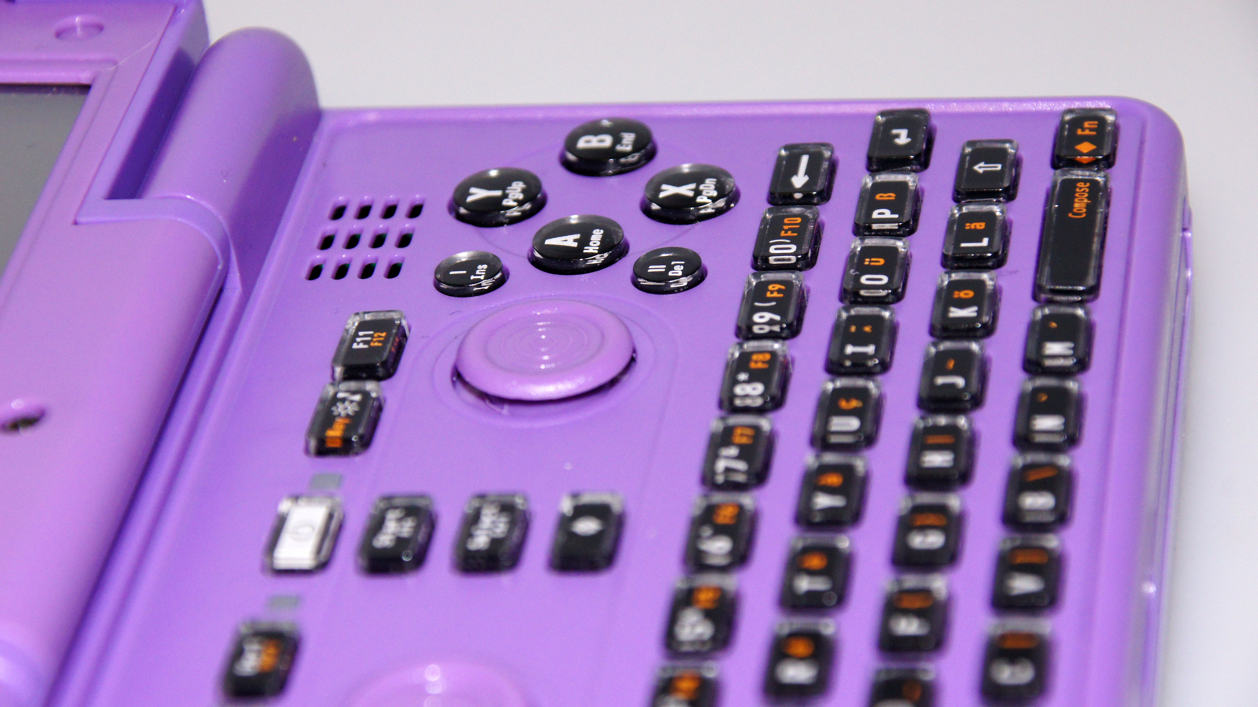

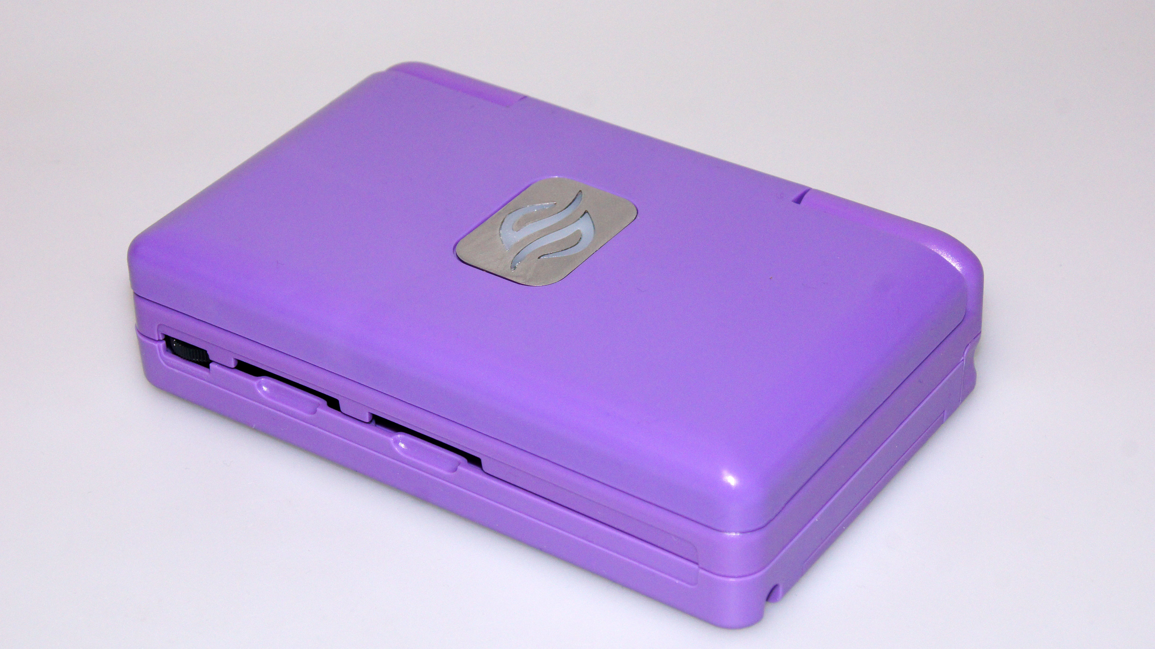

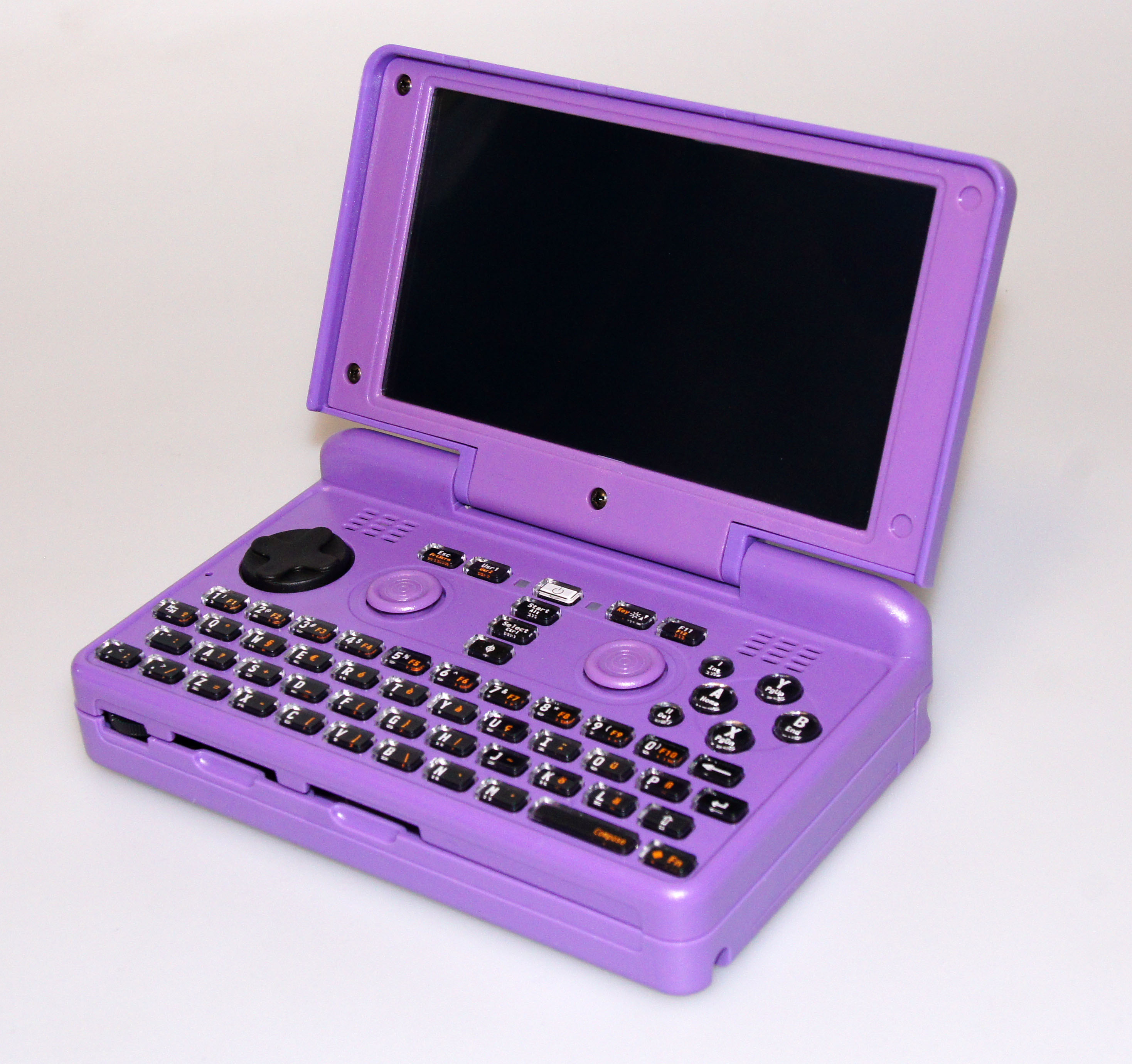

The second one is a violet one. That's not a color I actually wanted to use, but it was the color one of the Pyra Prototype orderers wanted to get
It will truly be a very unique device
![VioletClosed.jpg VioletClosed.jpg](https://www.pyra-handheld.com/boards/data/attachments/28/28557-e03b940d25d2ea848361d8f4dfcb285a.jpg)
![VioletOpen.jpg VioletOpen.jpg](https://www.pyra-handheld.com/boards/data/attachments/28/28558-11c356efcbfb66a1b599ceca276a1ba9.jpg)
![VioletSide.jpg VioletSide.jpg](https://www.pyra-handheld.com/boards/data/attachments/28/28559-07759aa941e60a6d8d9ffb3c917da60c.jpg)
