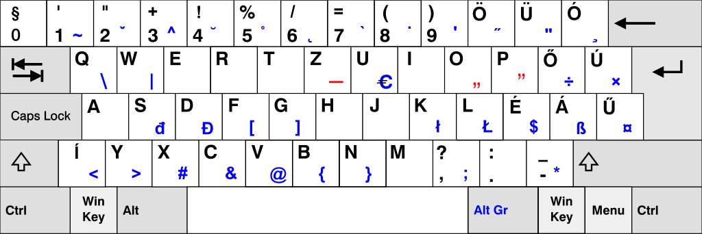

Anyway, I insist that for many languages, just the P+2 and L+2 are not sufficient. For example, take a look at a standard Hungarian keyboard:
Note that it has 9 pre-accented letters (Í É Á Ú Ó Ö Ü Ő Ű) as well as a whole bunch of dead key diacritics (on the number row).
For someone who needs to input Hungarian, my proposal offers everything in one or two thumb presses, without needing to remap anything. I don't know what you're supposed to do in comradekingu's layout.

Hungarian is a non-example of why 2+2 doesnt work, because it has 12 keys on the ASDF, we only have 11 total. The +4 idea stems from how it incorporates most languages. Thats where the monies are, which difference is between shipping one thing or the other. People pay to be thought of. Even if they buy it anyway, it adds value for free. That is not a perceived value. Perceivably its better for english people if they never knew how or why it happened, which is how id like to keep it. People should not have a good reason the layout.

According to US standard http://www.brianhetrick.com/kb/ we use AltGr positions for other symbols, so this is a hack. Therefore meta.
All these are dead-key  ::: most used ::: may be wrong about this
` (grave accent)                           Meta+7  à è ì ò ù À È Ì Ò Ù (this is a swipe-combo)
~ (tilde)                                        Meta+4  ã ĩ ő ñ ũ Ã Ĩ Ő Ñ Ũ (may change to 3)
^ (circumflex)                                Meta+6  â ĉ ê ĝ ĥ î ĵ ô ŝ û Â Ĉ Ê Ĝ Ĥ Î Ĵ Ô Ŝ Û (this is a swipe-combo)
* (asterisk)                                    Meta+8 å ů Å Ů  (To my knowledge only used by scandinavians, which have dedicated ring above letters)
( (left parenthesis)                       Meta+9   ă ğ ŭ Ă Ğ Ŭ
- (hyphen)                                   Meta+AltGr+9  đ ħ ŧ Đ Ħ Ŧ   I can use AltGr+h for ħ  and +f for đ
\ (backslash, reverse solidus)      Meta+shift+(L→1) ą ę į ų Ą Ę Į Ų
| (vertical bar)                              Meta+altGr+(L→1) ā ē ī ō ū Ā Ē Ī Ō Ū
: (colon)                                       Meta+shift+(M→3) ä ë ï ö ü ÿ Ä Ë Ï Ö Ü Ÿ
' (apostrophe)                              Meta+5 á ć é í ĺ ń ó ŕ ś ú ý ź Á Ć É Í Ĺ Ń Ó Ŕ Ś Ú Ý Ź   (this is a swipe-combo)
" (quotation mark)                        Meta+2    ő ű Ő Ű
, (comma)                                     Meta+(M→1) ç ģ ķ ļ ņ ŗ ş ţ Ç Ģ Ķ Ļ Ņ Ŗ Ş Ţ
< (less than sign)                          Meta+shift+(M→1) č ď ě ǐ ľ ň ř š ť ž Č Ď Ě Ǐ Ľ Ň Ř Š Ť Ž
. (period)                                       Meta+(M→3) ċ ė ı ġ ż Ċ Ė Ġ İ Ż
/ (slash, solidus)                            Meta+altGR+(L→1) ł ø Ł Ø
Remapping is a hack anyway. If the label says [ { and when you press it, you get Ü, then something non-intuitive is going on anyway. There's no way around that.
