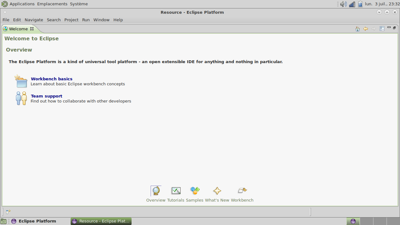

Ok, Eclipse works. Again, it's just a matter or "sudo apt install eclipse".
Only openjdk is there for now, not sure if the perfs are good. I haven't done anything with it. I'll try to use it a bit tomorrow...
(I know, I launched 2 of them)
OpenJDK should be fine nowadays, unless you use JavaFX or some oracle-specific stuff. The performance difference isn't significant anymore AFAIK.
Perfect, thanks!
OpenJDK is perfectly fine for me! A JDK for Arm doesn't exist that long, iirc. I'm surprised, that it works out of the box.
