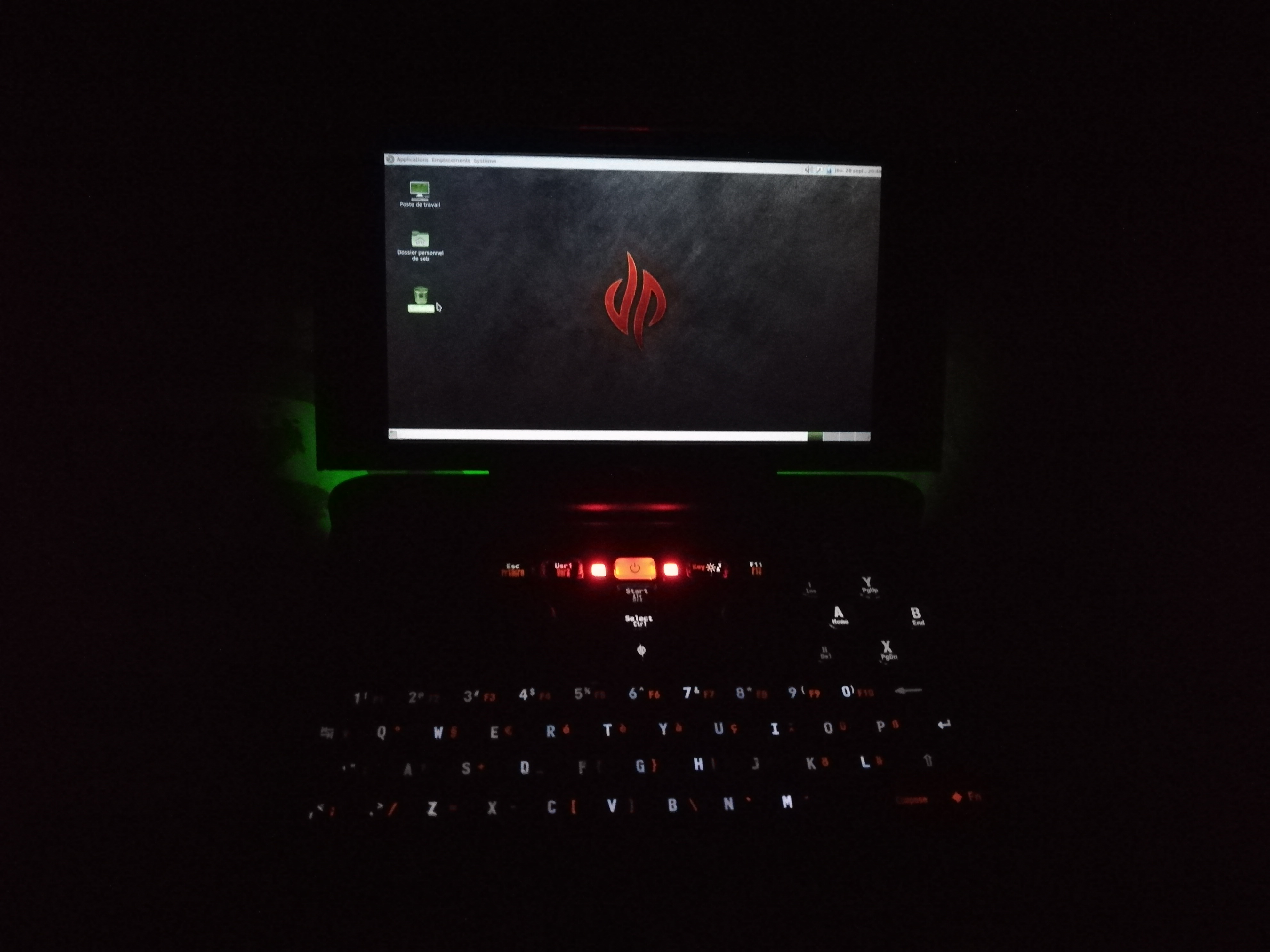

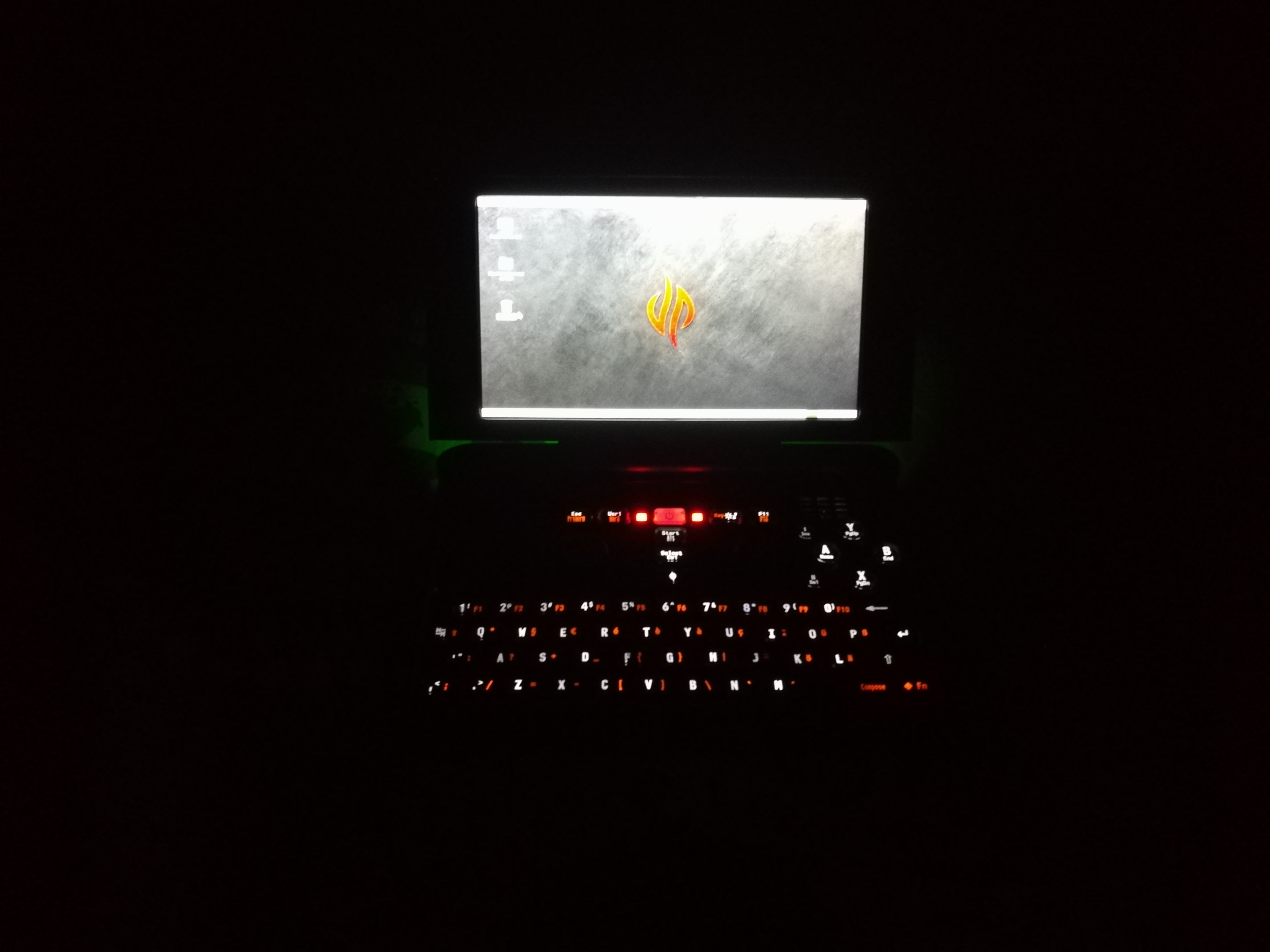

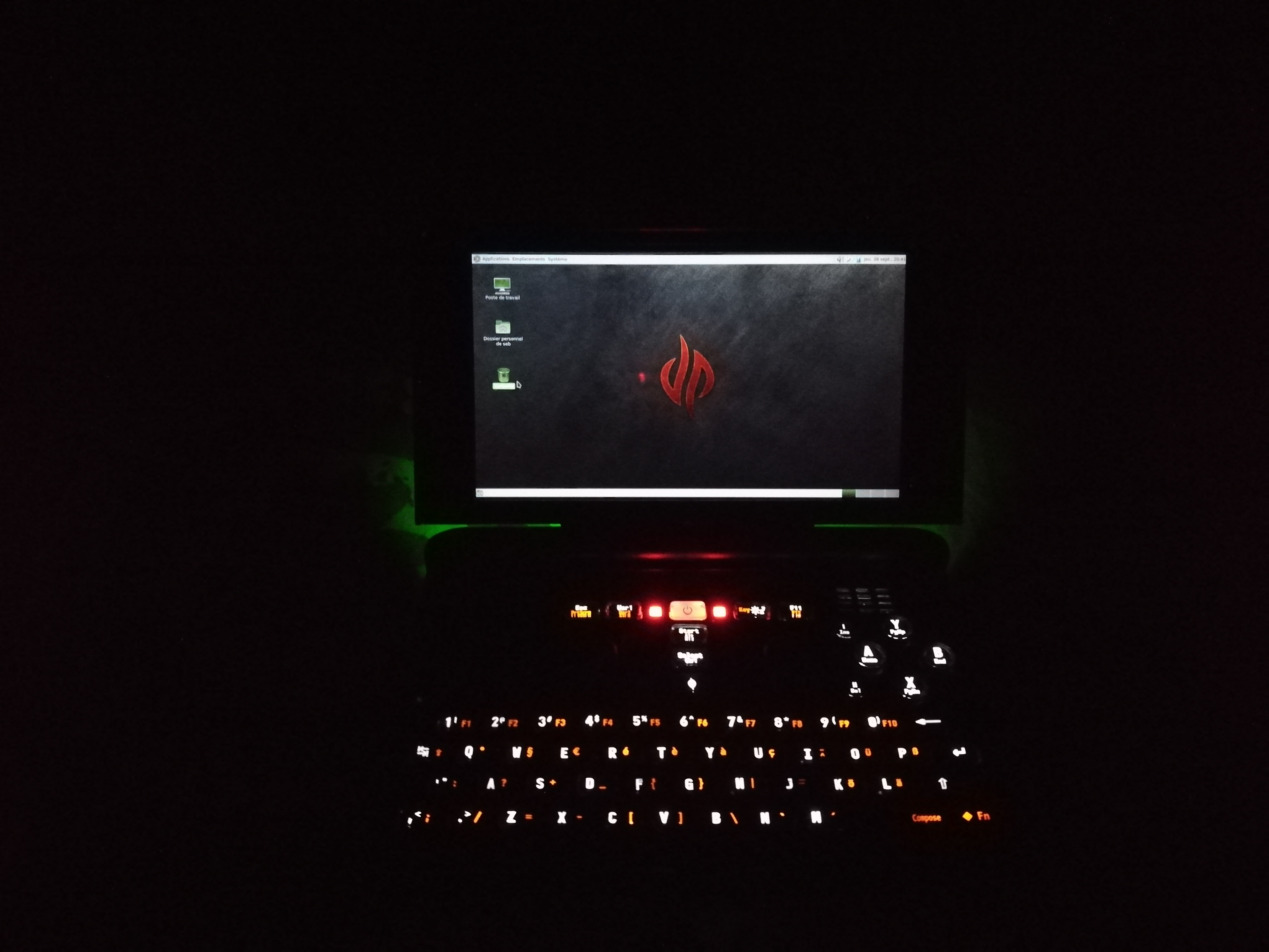

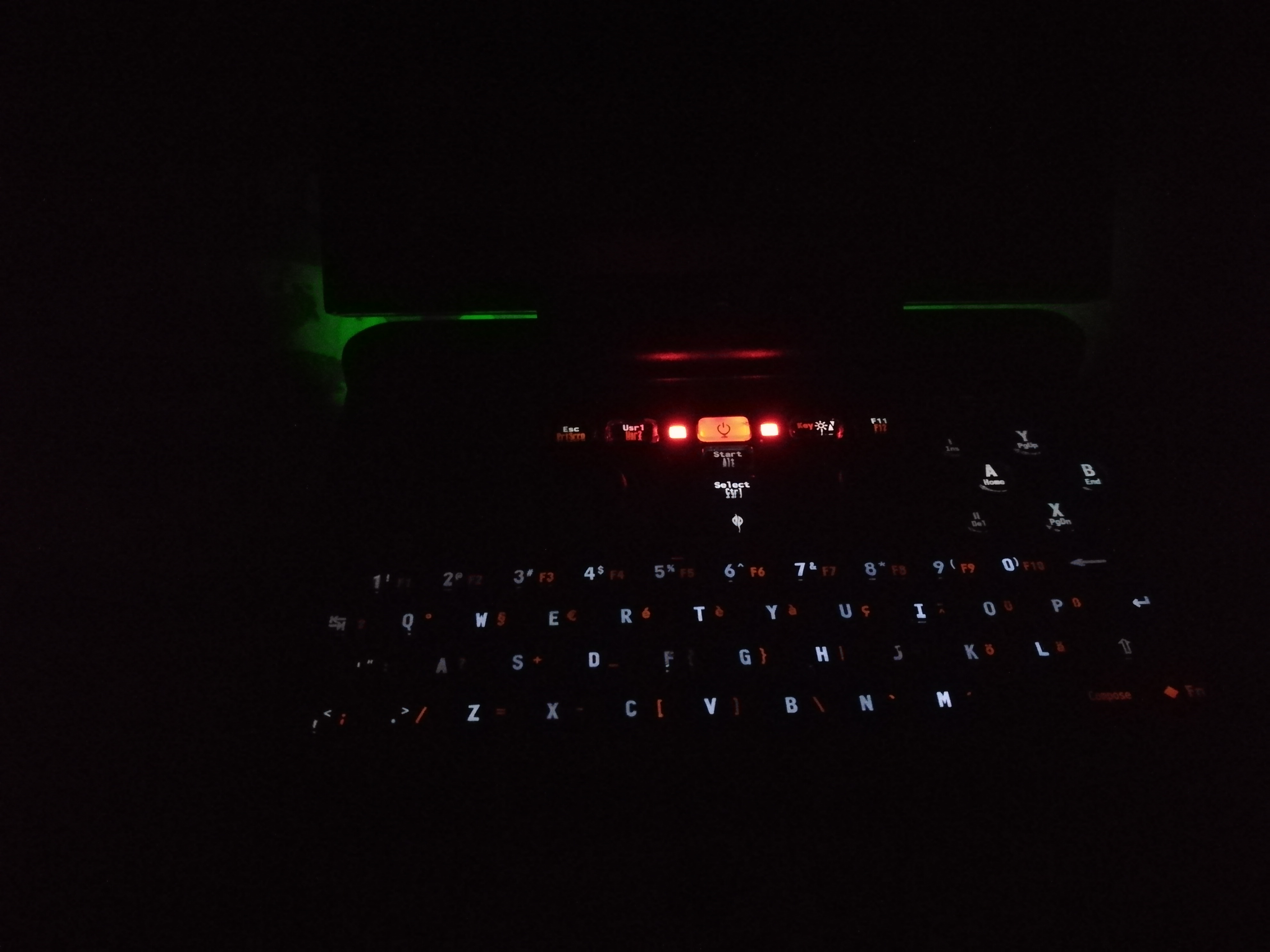

as aTc added askarus script for sceen and keyboard brightness, I toyed a bit with that today. From the bright most to the darker settting (well there's a level bellow : off)

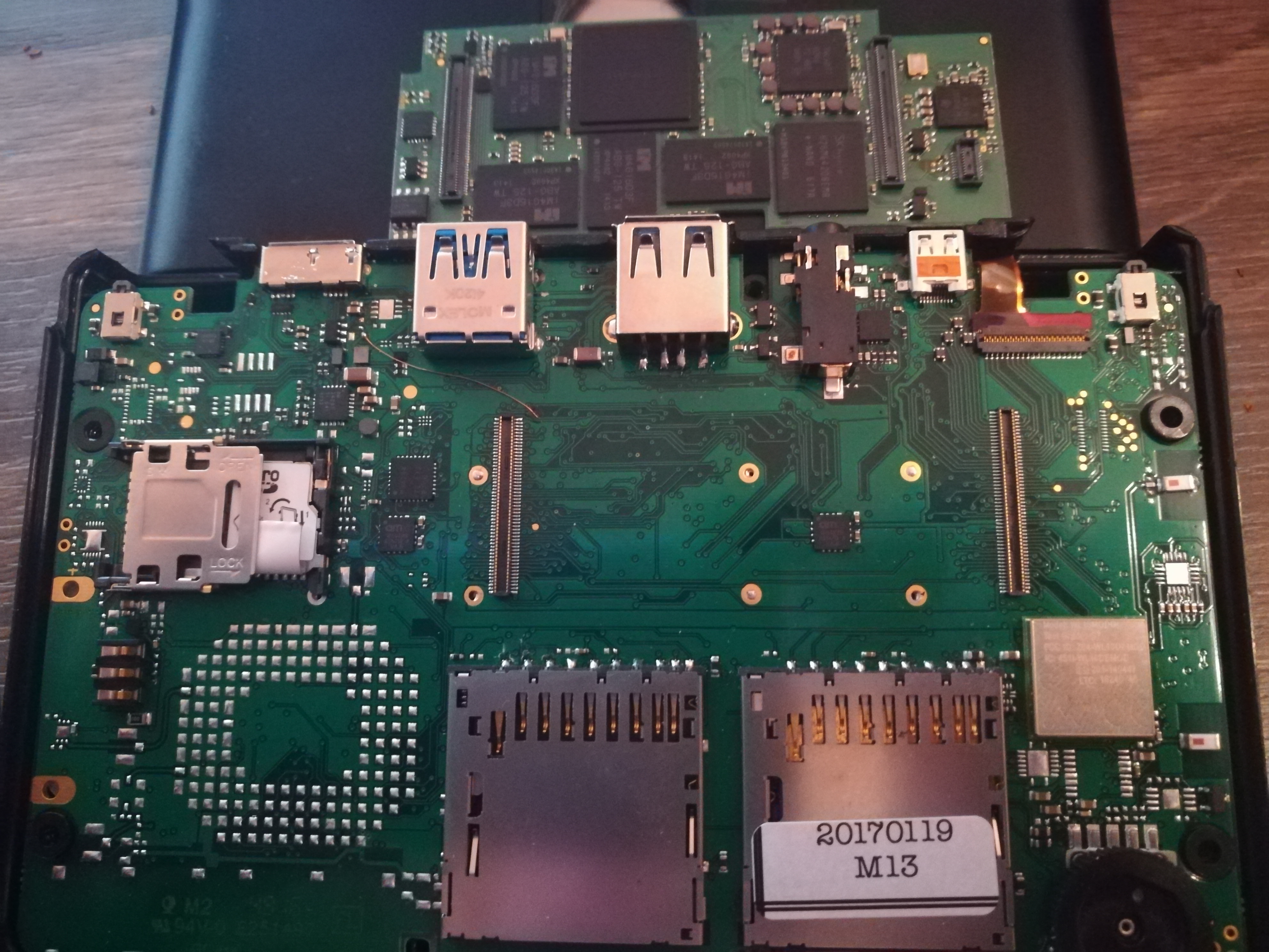

Beside these little shots, I've opened the bottom part of my pyra too as I promised. I took the cpu board off, removed the main board took a pict and put everything into place. easy as cake. and the device is still working. I think there's no way to make all this any easier. great job ED you're building the most user servicable handheld in the world... and by a huge margin !
What's this wire for? Just curious
As I said a number of time, my board is from an old revision that was a little buggy. That's an hns' fix for this board. The fix is now part of the new board revision.
It's just cheaper (and faster) to fix old boards manually like this to send to devs (like me) than order a new batch of boards
