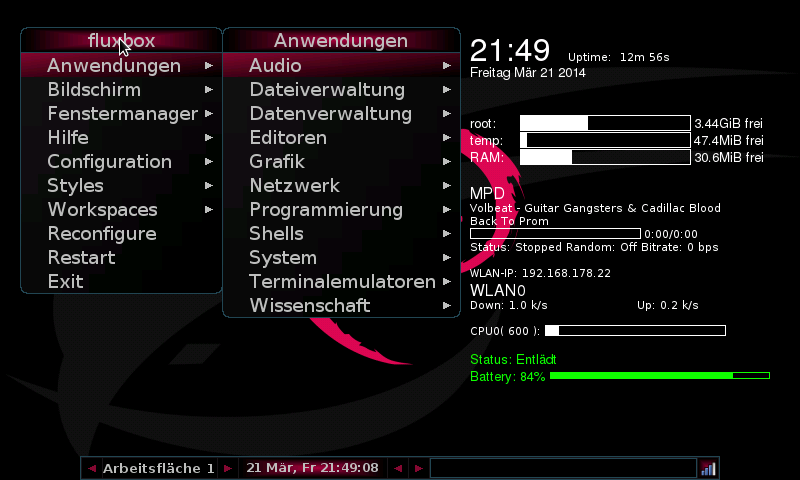

Back on duty,
i continue working on pandian and play around with fluxbox ( see image below, for further discussion )
next step is creating the debian-packages ( and the source-packages ) and of course write an cpu-settings-tool
