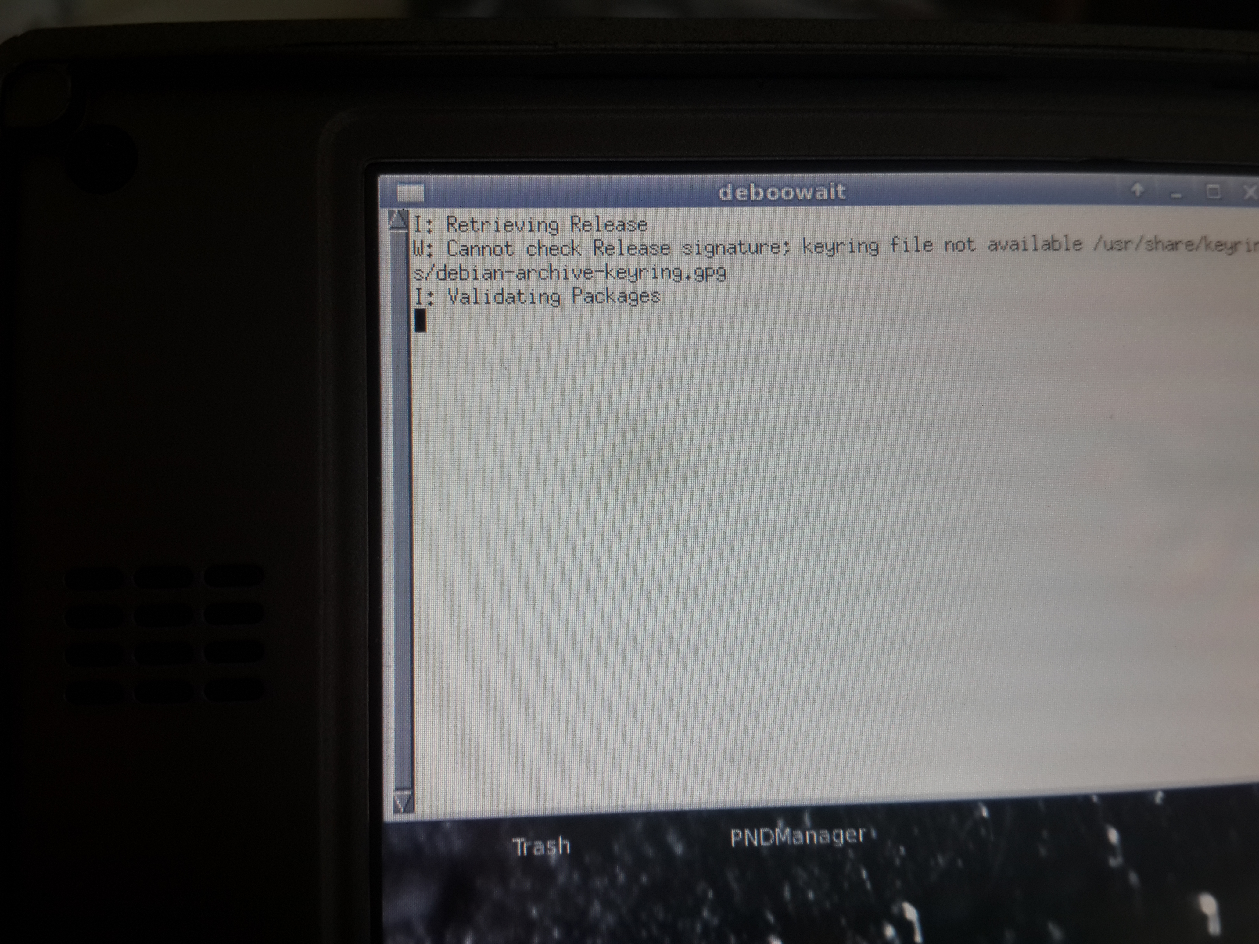

I am trying to install PanDebian and fix my Pandian sd card for about 3 months and no success. Rather than talking, I will post here some pictures.
First image is the result when I try to install Debian Wheezy Chroot. I think we already know it is a bit problematic.

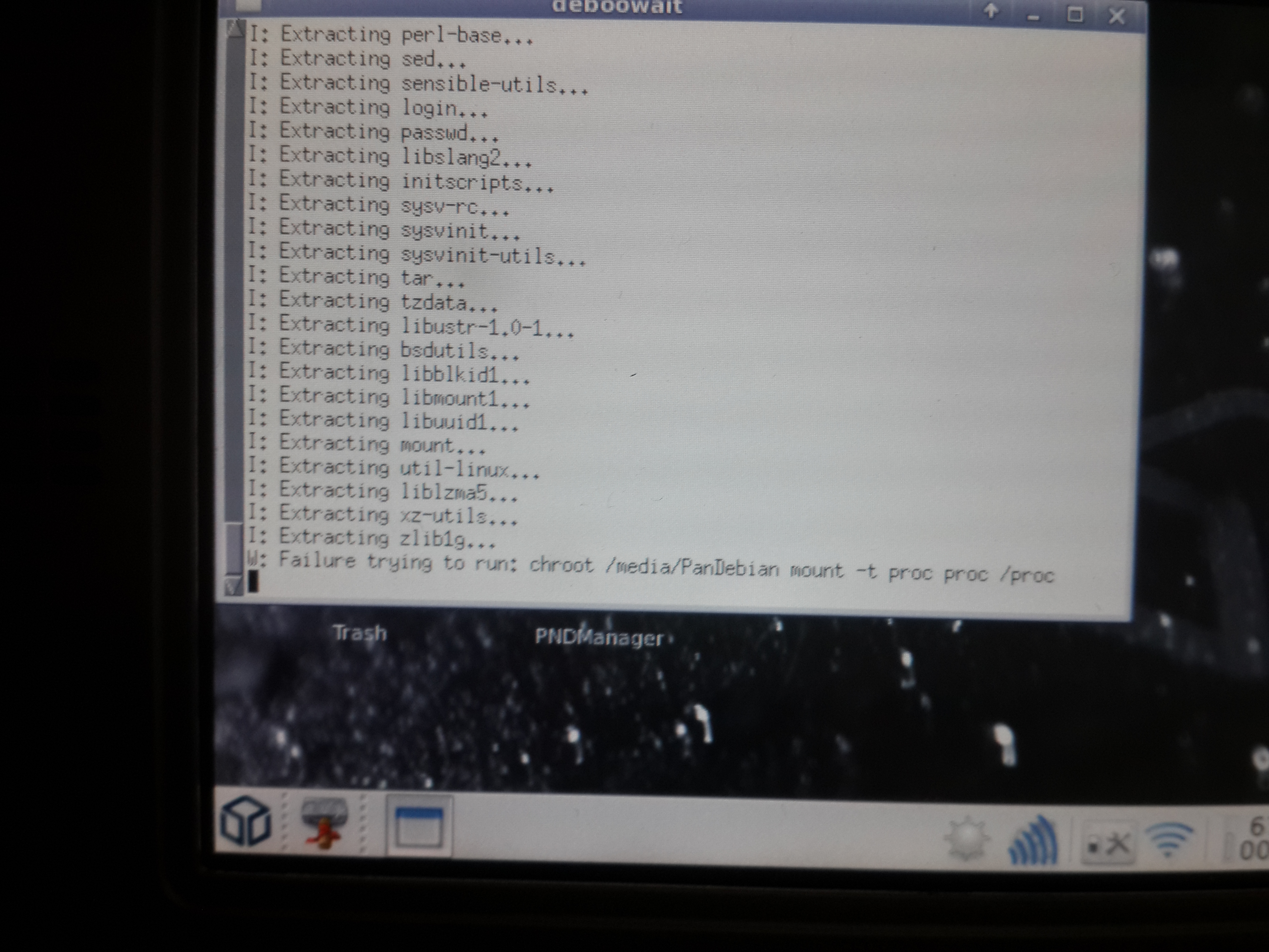

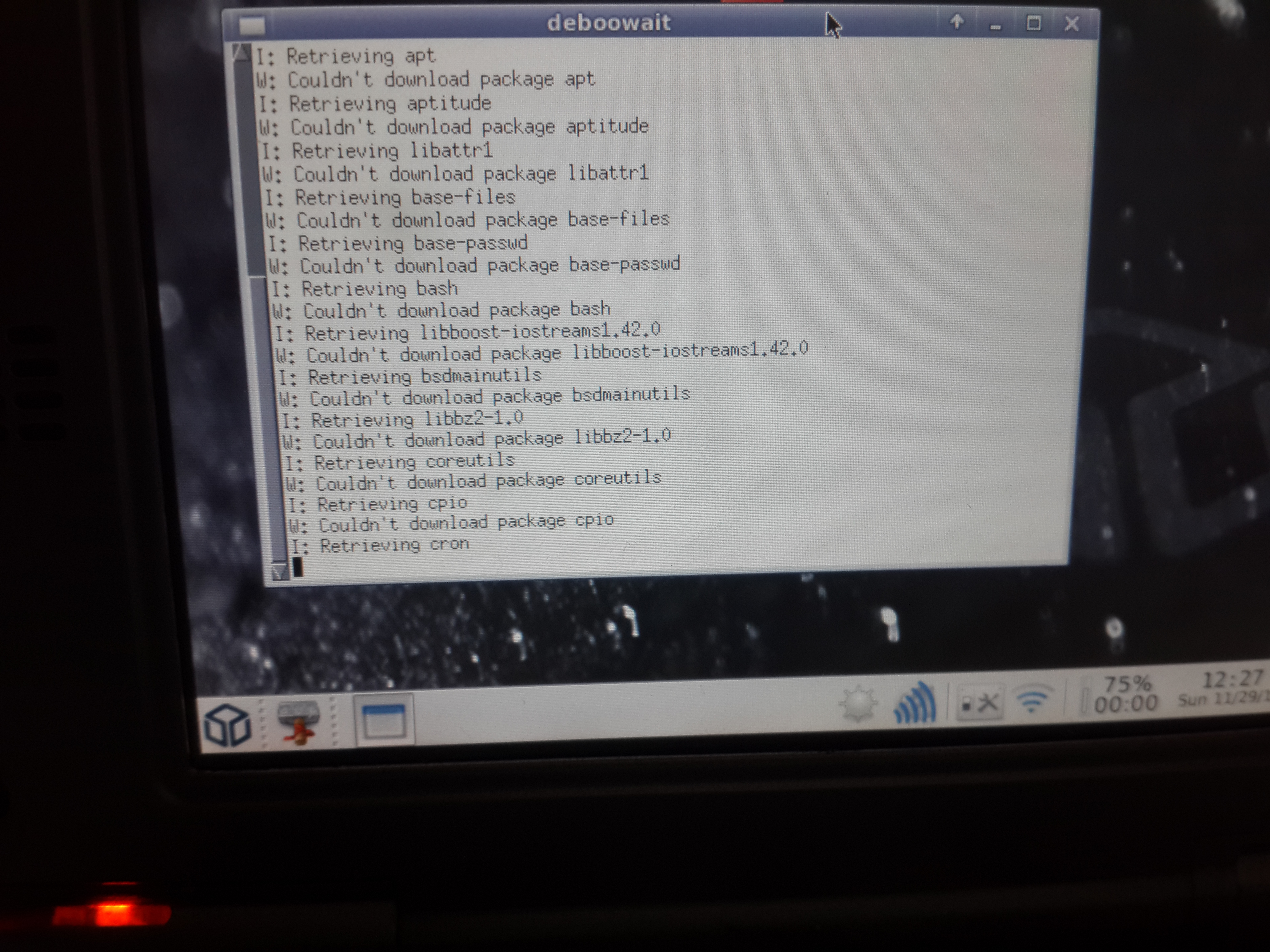

Second image is the result when I try to install Debian Squeezy Chroot. I just don't understand why it can't download these packages. My internet connection is just fine (it can download Debian Wheezy without problems).

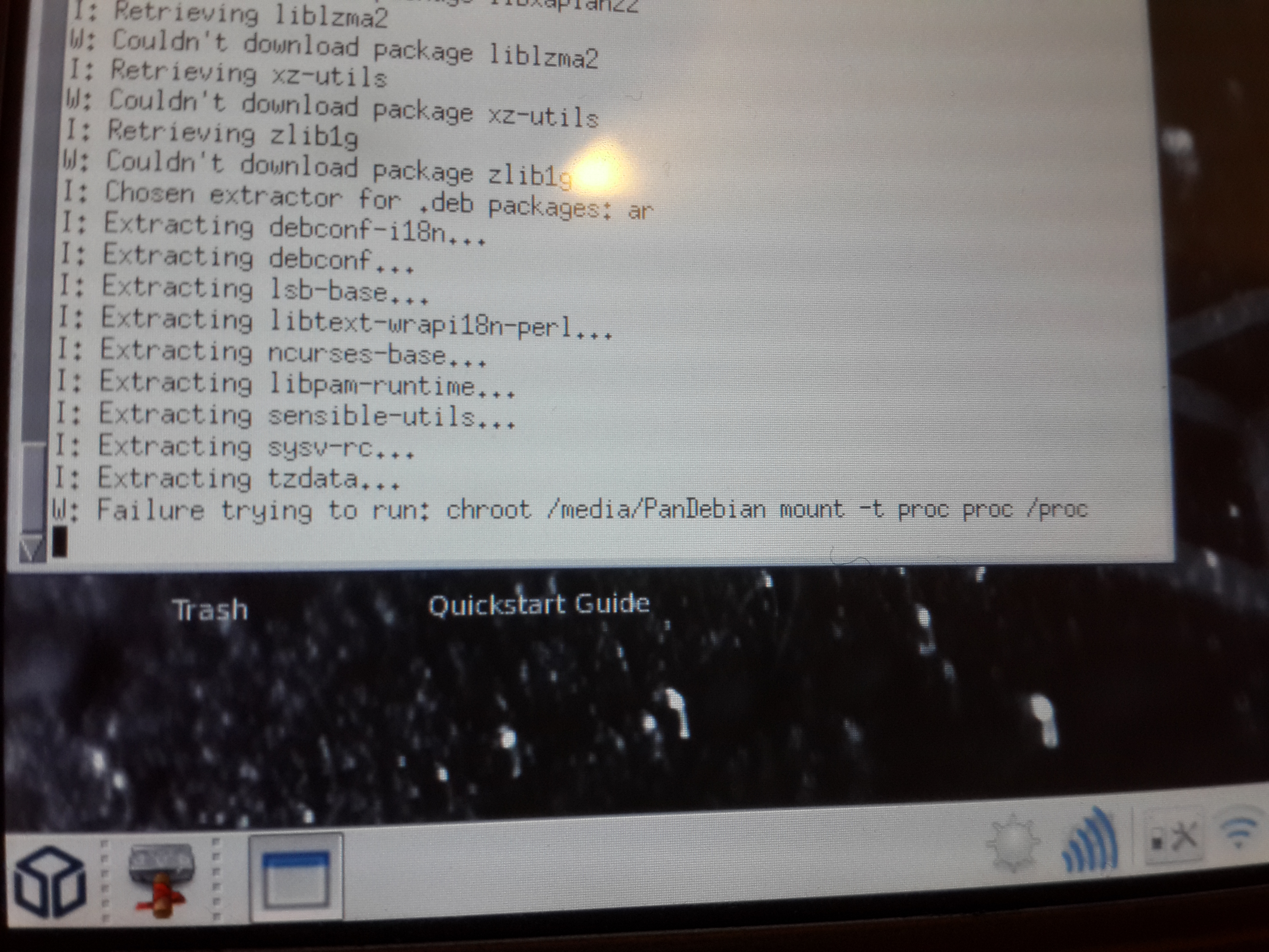

Also they all give an error like the error in the third picture.

What happened after this?  Did it still keep on going or stop.  I don't think I have those warnings in the first pic, but I had the same waring in the second pic but it then installed Squeeze fine.  Do you use internal WiFi or a USB WiFi stick?  I used USB Wifi stick.
It just stopped. Then, I will try to install it using an external WiFi USB Stick (fortunately I have one ^^)
