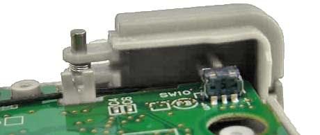

I couldn't find a pic of the shoulders for the XL but I did find one for the ND Lite if you scroll to the bottom of the page: http://www.squidoo.com/ds-lite-top-screen-replacement
The mechanics for the triggers seem sound and comparable to it's big sister. Notice in particular how smartly they incorporate the exterior of the case?
The DS Lite Trigger Buttons iFixit guide here shows they also use springs for that nice clicky feedback action.
They use metal pins for the little trigger hinge, very nice. Pandora only has plastic there and what's the additional spring at the NDS trigger pin? For keeping the trigger stiff? Also not bad. At least such a metal hinge could be used for the Pyra triggers too.

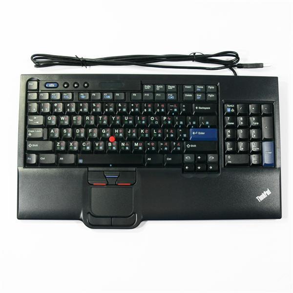

Personally, I'd like to see white, red and green labels on every key to match the different key mappings in something like this:
http://boards.openpandora.org/topic/15275-unofficial-keyboard-layoutsjune-28-2014/
Maybe even add blue if we need another mapping.
Example of 4 colors on each key of a standard keyboard:
Note that the red, green and blue characters despite being the same size do not overpower your recognition of the primary (white) characters.
For the curious - it's a Simplified Chinese & US QWERTY keyboard.  I have two of them - they work great.  No I'm not, do not speak or read Chinese.  They're great keyboards - and  I love the expression on peoples faces when they sit down behind it and go uhmmm?
I do like the red idea, and may like the green if I could see what it would look like with the backlight.  Yellow and orange sound good, too.
I'd like to stick to White (diffuse), Red, Green and Blue.
Note on that keyboard - it actually has -5- mappings for most of the central keys White caps, White LC, Red, Green, Blue.
Looking at the proposed Pyra's keys, two symbols would be easy, 3 would be compact but doable.  4 is probably right out.
So - probably White, Red, Blue?
