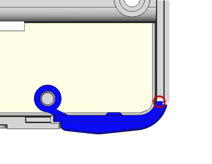

I would advice you to make the part with the red circle a bit longer (more into the case).
It's pretty close now.
Might add a little more stability and there won't be the risk of a little gap.
Just 1-2 mm would be enough to make it look better to me.
