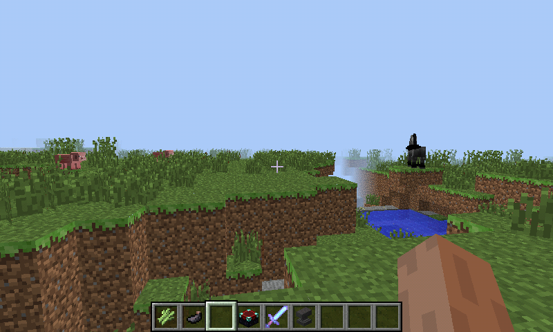

And I found what was wrong with the lighning. That was more tricky.
Let me explain what I understood (keep in mind I don't have access to minecraft sources, I can only deduce things from traces I put in glshim mainly).
The light in minecraft seems to be handled by a Lightmap (so a texture), and the light is applied with some multitexture (only case of multitexture use in fact). It always use GL_TEXTURE1 for the light texture.
The Blocks from the Land and the Mob/Yourself are drawn in a different way.
The Landscape is draw using some glDrawArrays inside glList. The issue I have was that the LightMap coordinates was send using glTexCoordPointer(GL_SHORT...) instead of GL_FLOAT like always. I was trying to normalize the GL_SHORT (meaning value/32767), but it seems it was a bad idea (because the Texture Matrix was setup for non-normalized value of course), so I just send the data as-is (just converted to GL_FLOAT), and the World had light.
But not the Mob or yourself (or your weapon).
Here, it's also drawn using a glDrawArray, but this time, no glTexCoordPointer of GL_TEXTURE1. So how was the texture supposed to be send? In fact it use a single glMultiTexCoord2f(GL_TEXTURE1, ...) before setting up the Pointers for the glDrawArrays, defining a single Texel in the Lihgtmap for the Lightning...  Interesting trick, that was not handled.
So now, lighting is working fully :)
I have uploaded the new package at the same place, you can upgrade and report.
(Note: I know there are still a few other graphics artefacts left, like the menu screen, or the enchanted items that may look weird, but that's enough for now)
