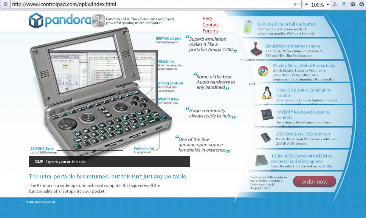

On Firefox it looks perfect, on Opera (my main Browser) it still looks messed up ^^" I deactivated all add blockers, enabled all plugin stuff that you can put into a website but no luck yet. I still try out more options and settings of course.
People use Opera? Mind blown.
I suspect there's an Opera specific prefix for the CSS transform property which I've not included. May be easy to sort that front page out. Will be replacing the transformed images with pre-transformed, pre-resized ones to increase compatibility and decrease bandwidth requirements.

I started a test on Browsershots:
http://browsershots....piix/index.html
Seems like the Opera rendering issues also occur on some more recent Chrome versions, Internet Explorer and FireFox 9 and older.
This is something that needs to be fixed.
PageSpeed rank is good (88 out of 100 points), it mostly suggests to use cache and optimize images, but I can do that right on the server.
Meta Tags and keywords are also still missing.
I think the scaling down and distorting, despite being an arduous task, will sort out the browser issues and, of course, do PageSpeed some favours. Will get to it when I can.

Just tried it out on my netbook. It mostly works, although the introduction graphic is too wide for the screen, so the layout engine puts the testimonial quotes on top of the right hand menu, which looks messy and makes it hard to click on the menu links. Also, on Firefox-based browsers, on the introduction page, the graphic seems to get rendered in front of the top menu, meaning the 'forum' link is very hard to click on. Once you switch to any of the menu pages the smaller graphics means it all works though, even on my netbook. On old Firefox 3.5 specifically (the default on Debian Squeeze currently), you get the same rendering problems as Opera. Works if you upgrade to the backported firefox though.
It does take rather a long time to load, and with most of the links being almost the same colour blue as the background, they're hard to see until the background loads in. It mostly all works without javascript too, which is nice - although since it renders as a long list of sections then, the headers and links under 'emulation' and 'movies, music, web & productivity' are almost invisible. The right menu doesn't work without javascript, but since you can just scroll down to the content, that's no biggie.
Speaking of those links, are they meant to do anything? I can't get them to do anything with either javascript on or off.

The rest of you; thanks for your awesome feedback. Rest assured that I am reading all of it, but there's just too much for me to discuss specifics. The pervasive browser testing you guys are doing is handy, and I'll be looking in particular at cutting down image sizes, perhaps adding some asynchronous loading to the slideshows and making sure the site works effectively without CSS and/or Javascript.

I've started adding some degrade support, which I should have accounted for in the first place. A test version is here: http://www.icontrolpad.com/opiix/index-degrade.html
No JS: Anchors allow the menu to work and you can click to jump down the page or just scroll to see the content. Content now has a background colour for readability. Sections have titles to distinguish them.
No CSS: Again, anchors are now present although the menu is at the bottom of the page. Sections have titles to distinguish them.
I tried using operah to test it and the big quotes where overlapping the main right curved menu.
Fixed that now, some of the responsive scaling was missing Opera-specific rules. CSS compatibility stacks suck, but I don't fancy bloating things with a javascript fix.
Below 1150px wide, the site is scaled down somewhat in order to fit on 1024px wide displays (like the iPad)
Edit: Just been through and manually skewed all the images, plus worked my degradation fixes thus far back into index.html.
