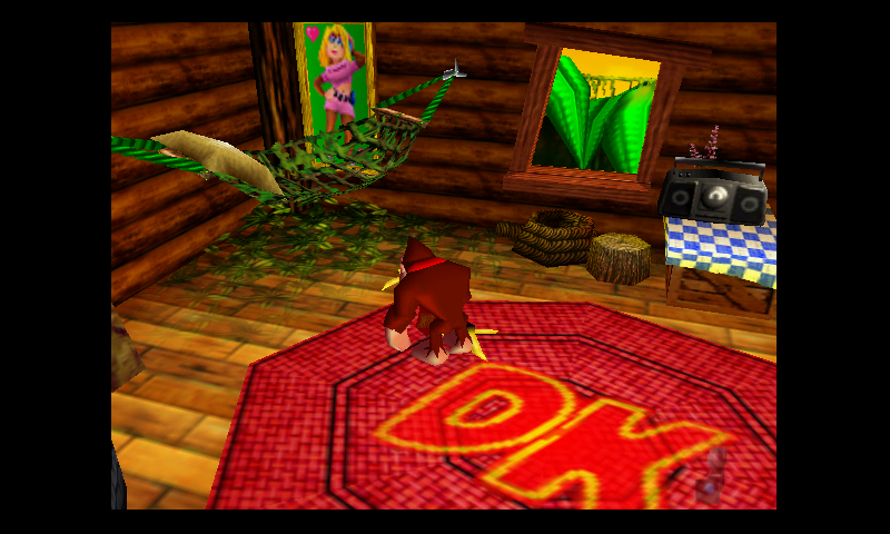

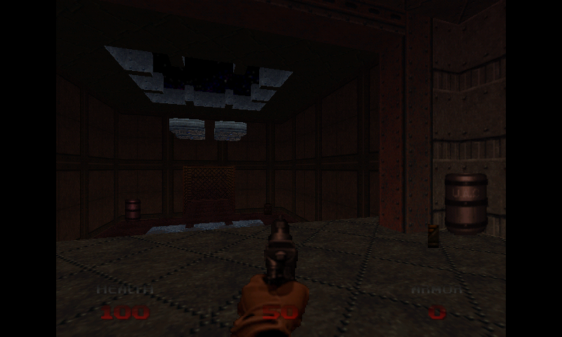

Ah, finally cheat supportCore fix for Doom64 and DK64 (DK64 is still not playable, you can still go through walls).
As described (too briefly?) in the what's new Open your gles2n64.conf (mousepad or the Config util), and make it look like that:How can I use the half resolution? I don't think I just change the window width size, right?
