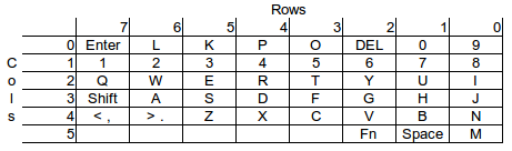

There could be a technical problem with putting 4th symbols on each key, and that has to do with the physical layout of the keyboard circuit.
The Pandora keyboard is laid out on a grid, when you press a key you don't (for the most part) activate a gpio pin specific to that key, but rather you short two pins, and the combination of which pins are shorted indicates which key was pressed. This works quite well for the most part but an important thing to note is that it has limitations on how many keys can be pressed at once. Specifically, if 3 or more keys that are laid out in a rectangular pattern on the grid are pressed together, only the first two buttons pressed are recognised. This means that if you hold down 2 keys in the same "row", all keys in the same "columns" as the two you pressed become unavailable. I have no reason to expect that the Pyra will be any different in this regard, so if there's to be any chording of modifiers on the main keyboard the keyboard matrix layout needs to be taken into consideration to avoid such issues.
For reference this is how the Pandora keyboard matrix is laid out:
Is there any chance we could get a diagram of how the Pyra keyboard matrix maps to the physical position of the keys?
Theoretically, chording the modifiers on the shoulder buttons should not have the same problem because each should get its own gpio. (I would hope)

So is there anyone who knows what is the wiring of the keyboard matrix?
Can someone at least provide info about keys which have their own wiring (I'd expect that gaming keys belong to this group, any other keys)?
