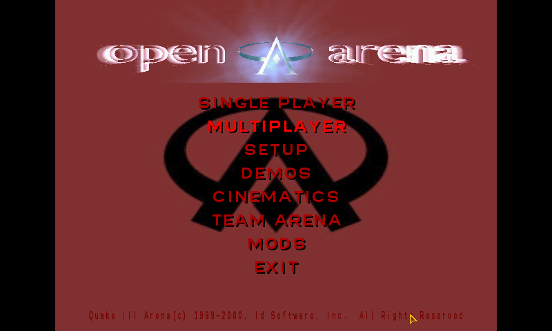

I have tested this a little. The issue of "invalid product identification" seems related to the non retail pak0.pak contained in baseoa folder. Replacing this with the one of Q3 fixed it, it's like bringing OA into Q3. Then if you copy the rest of non pak files from baseq3 to baseoa it's possible to load openarena from the mods menu option. You can see the openarena menu with some glitches yet it's possible to play some levels (with tons of glitches, others just crash). Maybe there are some Q3 modders that can invest some hours in making a proper adaptation of the OA content to Q3. Or maybe some talented dev could just port OA to pandora. It's been a very long day, going to bed now.
Edit: Follow WizardStan advice to fix openarena pak0.pak.
Ok, get a legit copy of Quake3, open baseq3/pak0.pk3 in your favourite zip application and extract productid.txt
Similarly open baseoa/pak0.pk3 and add the previously extracted productid.txt. Now you'll still have all the OpenArena assets and ioquake3 will proceed thinking it's the real quake3.
Did you mean NanoGL? Or does this only work on IOQuake?
It was already working in IOQuake. It didn't work in Quake 3 NanoGL because of that "invalid product ID" bug. Gausen solved it by copying the entire pak0 file overtop of the OpenArena one, but this has the unfortunate effect of losing some of the OpenArena assets which could cause graphical glitches. I remembered that pak files are just zips, you can uncompress them, extract the specific productid.txt file it is looking for, and stick it into the OpenArena pak0 file without losing any of the assets. Everything works perfectly now in Quake 3 NanoGL, and the graphics look much better.
