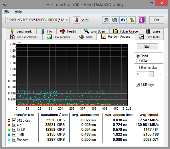

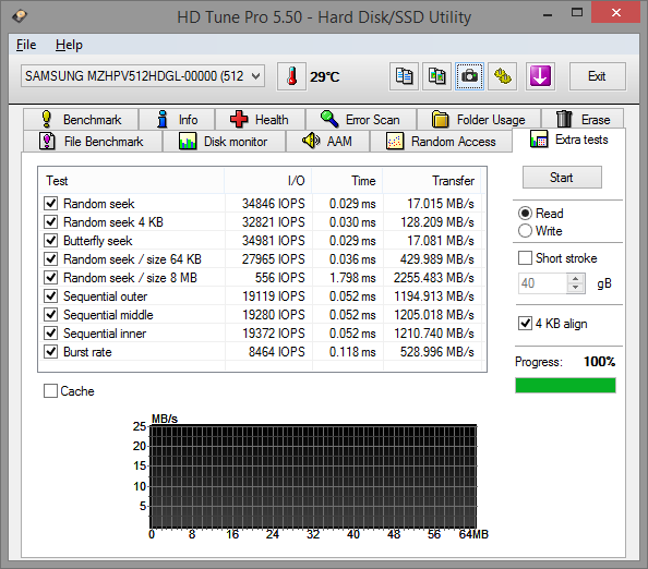

I'm arguing that for a system drive, sequential speed is irrelevant. You want IOPS over all else.
That is a good point, although to be fair there is a correlation between sequential reads and IOPS: if you get something that can read a single file fast odds are good that it can also hit multiple files and vice versa. Not strictly, of course, but generally a good marker.

Screw that. 30MB/s or so is good enough for a system drive as far as sequential access speed goes. What's more important is random access IOPS. Is the production NAND chip chosen already, and if so, were there any benchmarks done on that?
 Sounds like M.2 /SATA3 POWER! :D
Source: http://www.tweakpc.de/hardware/tests/ssd/samsung_sm951_m2/s05.php
Samsung SM951 M.2 in that case, over 1.5GB/s write and 2.2GB read speed are nice values, DO WANT! ^^
