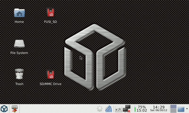

Last question, since there is a ugly gap in between my desktop icons (I've deleted the quickstart link), how can I sort the Icons on Desktop? Somehow, the location of the SD icons stays the same,even afer removing, rebooting, new inserting the SDs... and I can't find the usual Icon placement/sorting options in XFCE. ^^"
