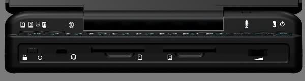

I'm a bit late to the party, but a couple of comments:
  • Aside from logos, stick to a single font. Certainly don't mix serif & sans-serif fonts without reason. The sans font you're using (Myriad?) looks fine.
  • Personally, I have an aversion to Courier for almost all uses. I don't see any reason not to use the sans font for the SD icons (and "First Batch", if printed).
  • Try to keep all the icons as close to the same size as possible.
  • Mixing icons & text labels is a bit messy; I'd iconify the BT label (just putting it in a rounded box as suggested earlier would do). If there is indeed no fee for using the real BT logo, you should definitely look into it.
  • The wireless icon is probably too fine-detailed to print clearly. I'd use a bolder, simpler antenna icon than that one.
  • Wherever practical, use the same baseline for all labels across the whole casing. (You may need more than one line, but align labels in rows, rather than the tops of the connectors)
  • If you're worried about localisation with "First Batch", the same applies to all other labels. Use symbols wherever appropriate (eg lock for hold) or widely-understood names/abbreviations.

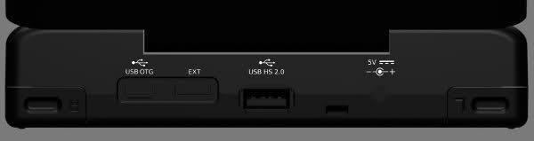

    • The GP2X labelled its expansion port as "EXT" (external/extension?) -- this is fairly common, keeps a legacy association (as was done with the game buttons), and is less tightly coupled to English.
    • I don't think there's any licensing restrictions on using the "trident" USB logo, so that should be used on the back.
  • Should the power connector label include the current (eg 5V 1A)?
Front - courier changed to sans, simpler wireless icon, BT iconified, "first batch" logo separated from labels, lock icon for "hold":
Back - USB logos added, "Expansion Port" relabelled "EXT", labels set to same baseline:

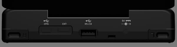

If you're using the USB logo, "USB" is then arguably redundant:

I also feel that the of the text on back is pretty ugly and useless. I also don't like the SD card icons. They don't fit the style and numbering may not match what the OS labels it. I would like them to be removed from the SD slots. I don't know what to do about the LEDs however. The HOLD text also seems wierd...
