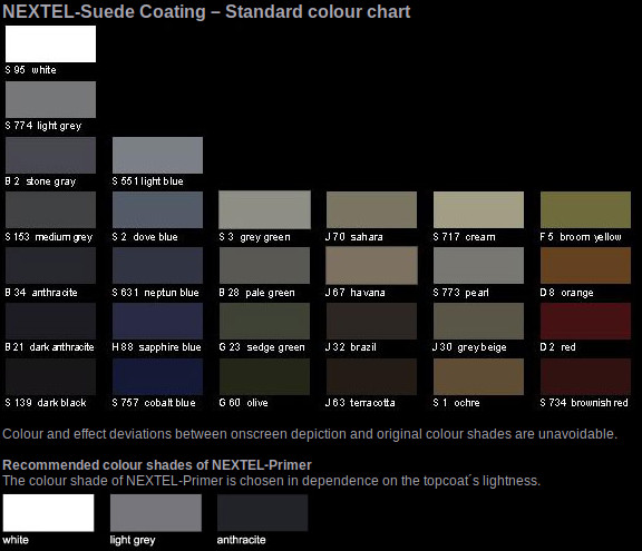

The paint used here was a normal one which is not scratch resistant. The color we use for the final version will be from here: http://www.nextel-coating.com/nextel/default.asp?lng=eng
This is an extra scratch-resistant casing. It just didn't make sense to wait until the color is here but use one the manufacturer had at hand for the test run.
Now we know it looks good, we can order the shells from Uniqueplast whereas the coating company can order the color from Nextel and do a quick test run as soon as it arrives.
This reduces the waiting time.

And there are some interesting colors....:
Edit: this way better...
I would go for B21 dark anthracite.
Pitch black (as S139 dark black) tends to attract stains more easily, despite being matte.
