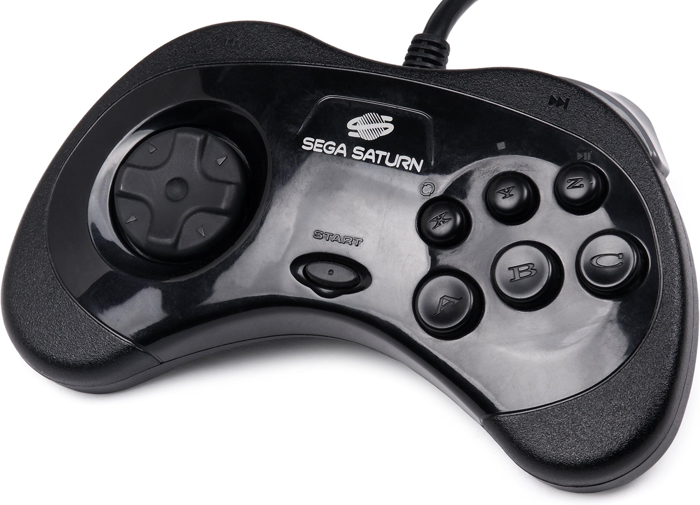

I think by "rough" textures, they meant the really textured plastic, like you'd find on the outer edges of Saturn Model 2 controllers.

Yes, and that's what the case has. Just not that rough, it's a bit finer, but it's there. Otherwise, it would look even more ugly without paint :D
Couldn’t agree more! Frankly, that rough surface finish on the Saturn Model 2 controller looks like something you would find on a cheap gardening tool, not on a high quality piece of technology - what were SEGA thinking?!
To be fully honest? They were thinking like industry-leaders. (Which I wish they had done for the rest of the design of the Saturn)
That rough texture made the controllers great to hold, and the contrast between that texture and the glossy center of the controller created a nice two-tone aesthetic.
Have you ever actually used that controller before? Because your comment gives me the impression you have not.
-God Ginrai
You’re right, I haven’t but I was purely commenting on the visual aesthetic (which if I’ve understood correctly is the principle concern behind painting the Pyra).
I accept that it may well have good intentions but I have seen other plastic grip surfaces that don’t look like cheap gardening equipment, which is why I’m surprised SEGA went for something that looks like that (and am glad that the Pyra won’t). But then that’s just my own view and tastes are subjective.
