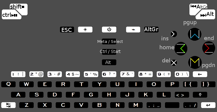

Sorry to disappoint, but can we please put this one to rest? It simply will not work.
Not DosBox/QEMU compatible. Keys and their shifted pairs are broken.
Not desktop/dock compatible. Keyboard cannot be used without the shoulder buttons accessible.
Illogical/random symbols to decipher and guess at instead of clear markings. Game pad symbols do not exist in any 'normal' character set.
Use of 6 colors for key tops (black, purple, yellow, red, blue, green) would rapidly escalate production costs.
Several keys from a standard keyboard are simply missing. Where is the Escape key? Print screen?
Symbol keys are seemingly randomly placed far from their original positions.
Commonly used Linux command line keys are difficult to find and use. Took me a bit to even find ~.
Mixed key background color may be eye catching but will not be possible unless you want to finance TWO keymats. The design as pictured would requre SIX individual keymats to handle the key background color changes (yes it's black and white - but look at the positions and carve it up).
Sorry CK, but I consider this layout and scheme to be dead on arrival. It's pretty in a techno-fusion-disco kind of way, but it is completely impracticable.

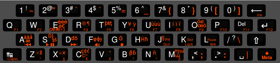

Added five explicit dead key diacritics as meta-keys: acute, umlaut, grave, caron and circumflex. I think that covers a lot of languages. Plenty of letter keys are still empty, so you can still put Ä€ÖÜß on Meta+AEOUS if you're German and have other mappings (e.g. these: http://www.keyboard-layout-editor.com/#/layouts/86df760fd41803365c8390943101d4e1)to have direct access to your popular special letters. But I would prefer not to print those on the keymat.
Preferably I would make it a bit more obvious that the dead diacritics are actually dead diacritics, e.g. by making them look like this: ◌́
(but the placeholder dotted circle should be really thin and the actual diacritic should be big and fat).

What I think is it will be much more difficult for your layout and the others to garner acceptance without the four labels per key wile.
Seriously though, ", < ; : " ? per key? Even four in a line would be farcical, and we haven't even considered the backlight penetration. How small will the dots in ; and : become then? I'd say very but you'd likely say not much.
