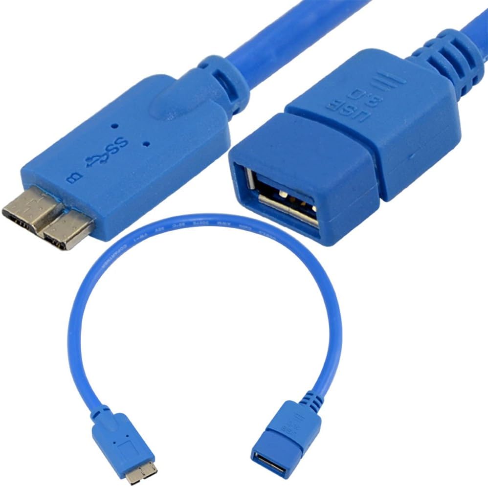

The above cable references for people wanting to find a 'good OTG' cable for the Pyra deals with using the Pyra as the host over the same type of connector. I.e. being able to connect USB 3.0 SS -devices- to the microUSB 3.0 port on the Pyra. For that you need a different type of cable. It will have the same connector as @matzesu pictured above, but will typically have a female USB 3.0 port on the other end to plug -whatever- into for the Pyra to see as a device connected to the Pyra.
This is what a microUSB 3.0 OTG cable looks like:
