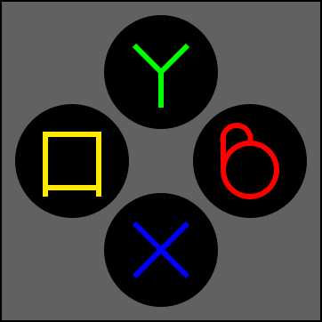

What about "PlayStation-style ABXY"? With or without the < > v ^...
A red thingy on an X, or just a big red X, might help get across the idea of delete.  Not sure how well it would translate in other places.
I think keeping the button markings simple will look better, and if done right it will make it easier to remember or see what other functions it has.  Right now I like the idea of a colored diamond split amongst the buttons best of all the recent ideas.  What FZERO came up with works, and looks good to me, and we can swap insert and delete if needed.  I suspect that once you explain the meaning behind the markings it will serve as a reminder of their additional functions.
You are right. Red both looks good and makes sense for back/delete.
The playstation colours arent pretty, so its really just three different types. SNES, Sega dreamcast, and Xbox
Also, same as with playstation-esque things, this is a nintendo trademark. I dont really know what that means in terms of getting sued, but not doing it is certainly the safe bet.
Snes is the only one with red in the vertical plane, but at the right hand side. There is nothing wrong with dreamcast, and it can be emulated.
Xbox i dont know about, and honestly both sega and MS have copied nintendo.
Meanwhile nintendo was busy doing everything else, but have now found their way back to the roots

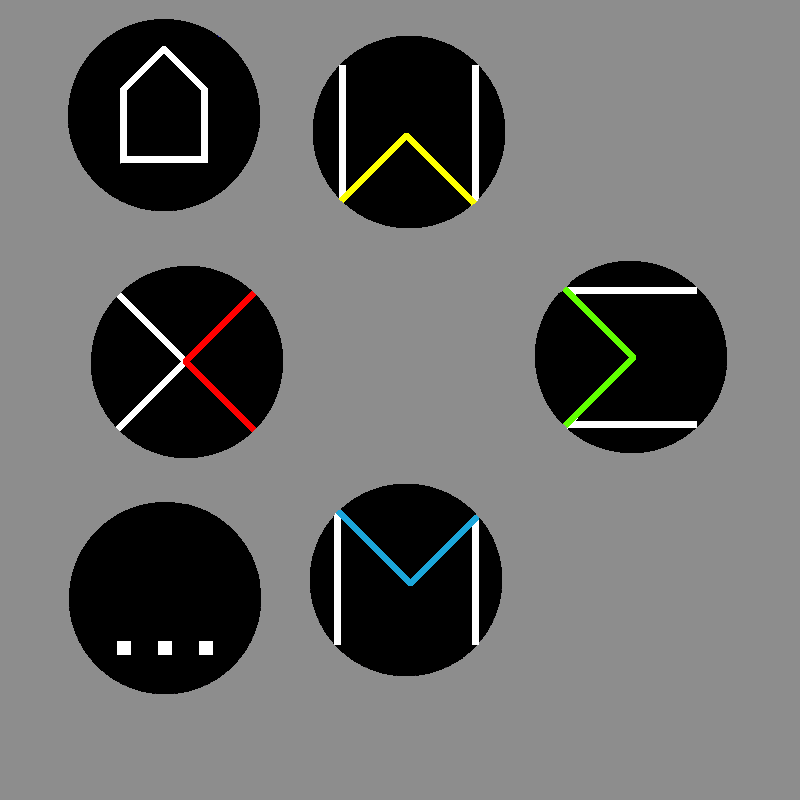

Yellow top, SUN. Then green for the most used button, EARTH. And the neutral blue SEA bottom, is nice.
Red on the least used, with the combo for android-buttons (home back menu), that also signify what they do, and point out the direction they are in,  I really like.
If you want the order to be insert on the left, and delete on the right, you can do so by swapping those buttons. If you also swap the top and bottom, you have the snes-layout.
But then you have a layout where all the arrows point inwards towards the centre  :)

ABXY isnt good. To someone picking it up, it is arbitrary. The alphabet (the one we use) is arbitrary to basic intuitive function, direction and colour to add with it.
There is sadly nothing standard about ABXY, its either ABXY or BAYX or an even more inept variant thereof.
ABXY is arbitrary to <^v> but it is even more so to BAXY, when what you are trying to decipher is button to direction, or combos of buttons.
<^v> is to any variant of abxy a one-to-many relation. (instead of the many to many cluster ****  in the case of abxy to itself) when you add colour to that mix, it adds insult to injury, because there is no common way to remember it, so you are bound to learn by picking at straws, only to lose them and/or add exceptions. Which means you re-learn forever and ever, with it only getting uglier and uglier over time.

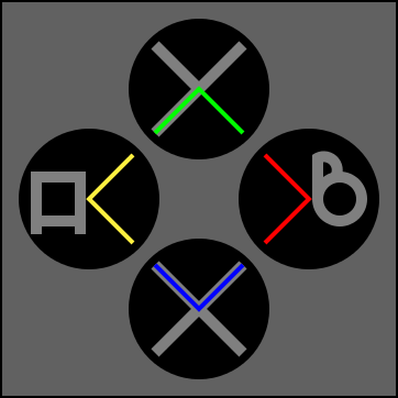

I tried the colours against black for all colour-blindness impairments, and it isnt counterintuitive. Sadly there is no way to have everyone see the same thing though.
The white lines against black is for people with bad eyesight to have the maximum contrast. I like the more advanced version artistically, but functionally the simplest is best, because it is recognisable.
A good buttoncluster is iconic. One reason for not copying someone else, other than it being impossible to do fully because of legal issues, is that it looks cheap when its a bad imitation. What you are left with other than that, are exactly the parts that dont make sense for this community, because we arent huge, and we want compatibility.

PS layout is exclusive to SONY game division, used on everything they make

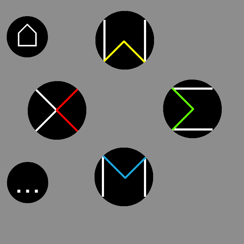

I tried to reflect the size of the extra buttons.
The white lines are all page/screen type visuals. Up page ^, Down page v , Into page > .  The X is delete. Or back (<) if you use android.  The house is home on both, and the ... is end (and menu on android)
And before we all collectively start hating on android. It is the most used OS in the world when you combine all devices...  If 1000 out of the billion people that use android buy a device because the buttons make more sense for android, then that is a huge deal for the pyra community.
