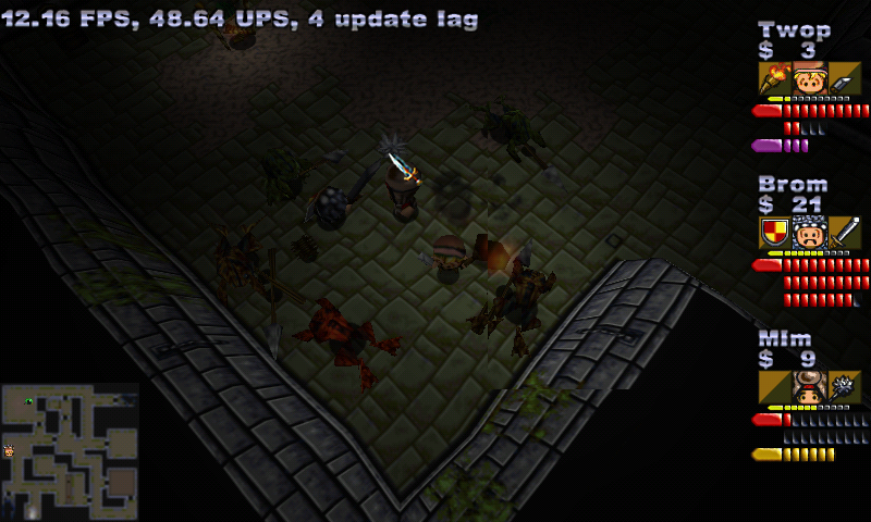

Here is Egoboo, the OpenSource 3D Dungeon Crawler
This version use gl4es, and is playable with correct framerate (> 15fps) on Gigahertz. You get around 10fps on CC (removing shadow and using low res textures). The game doesn't need fast framerate so it is playable even with that low framerate.

Wow Egoboo on the Pandora?
I runned it and it look nice but very dark here.
It was difficult for me to play with that Darkness.
Never played this before here and i must say ..its a realy difficult Game.
Even with 2 Stars(Beginner Mode) i died often in the first 5 Minutes.
Do i earn Exp to get stronger?
How can i Pickup the Weapons from the others?
And where i can see how much Life Points my Opponent have?
Unfortunaly a hard working Day again for me here today.
Thx for releasing it :D

So, the game is a bit dark, and there is no otion ingame to make it brighter. So I added a Gamma option in glshim, and use it to boost gamma at start (option is LIBGL_GAMMA). Also, if you don't like my value (2.0), you can overide it by putting the value you want inside a file named .gamma inside appdata/egoboo
Build 02
  • Boosted Gamma to 2.0 at start
  • Added an option to set custom gamma (put value in .gamma in appdata/egoboo)
