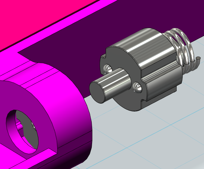

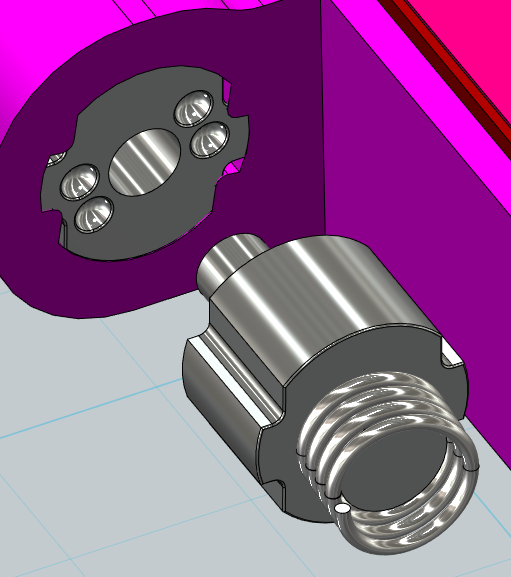

Hinge mechanism Idea:
2 lock bulbs for stability instead of one, and 3 (or more) lock positions (closed, open some 160ish degrees, full open) metal, simple, FCK Nintendo! :D
The strenght of the spring decides about how stiff the lid acts, in theory this should produce enough friction to have a save and solid lid positioning.

At least make it to lock at 145° as Fusion_Power said. :(
As mentioned above, already done (but not at 145°, as that would not match with a proper holding / viewing angle.
ED, this statement has me confused.
IF:
0° is 'closed' with the lid down over the keyboard.
90° is lid perpendicular to the keyboard.
180° is 'open flat' with the lid flipped over to be in the same plain as the keyboard.
Something midway between 90° and 180° (roughly 145°) is the most used position for my Pandora's screen.
I generally want the screen vertical to perspective.
If I set it on the desk to use as a media player, I look down from an angle at it.  ~145°.
Used lying down - 145° or so.
Used sitting in a plane, hands resting on the tray table, 145° or so.
The only use case I can think of to have it 'fully open' to it's 170° is when standing on a train and running the Pandora at belt level.
Personally I'd like to have 'no tension' from 0-60°, fantastic tension from 70°-180° (or wherever full stop is.)
But, nevertheless, somewhere between 130° and 150° is the most used screen position used on my Pandora.
