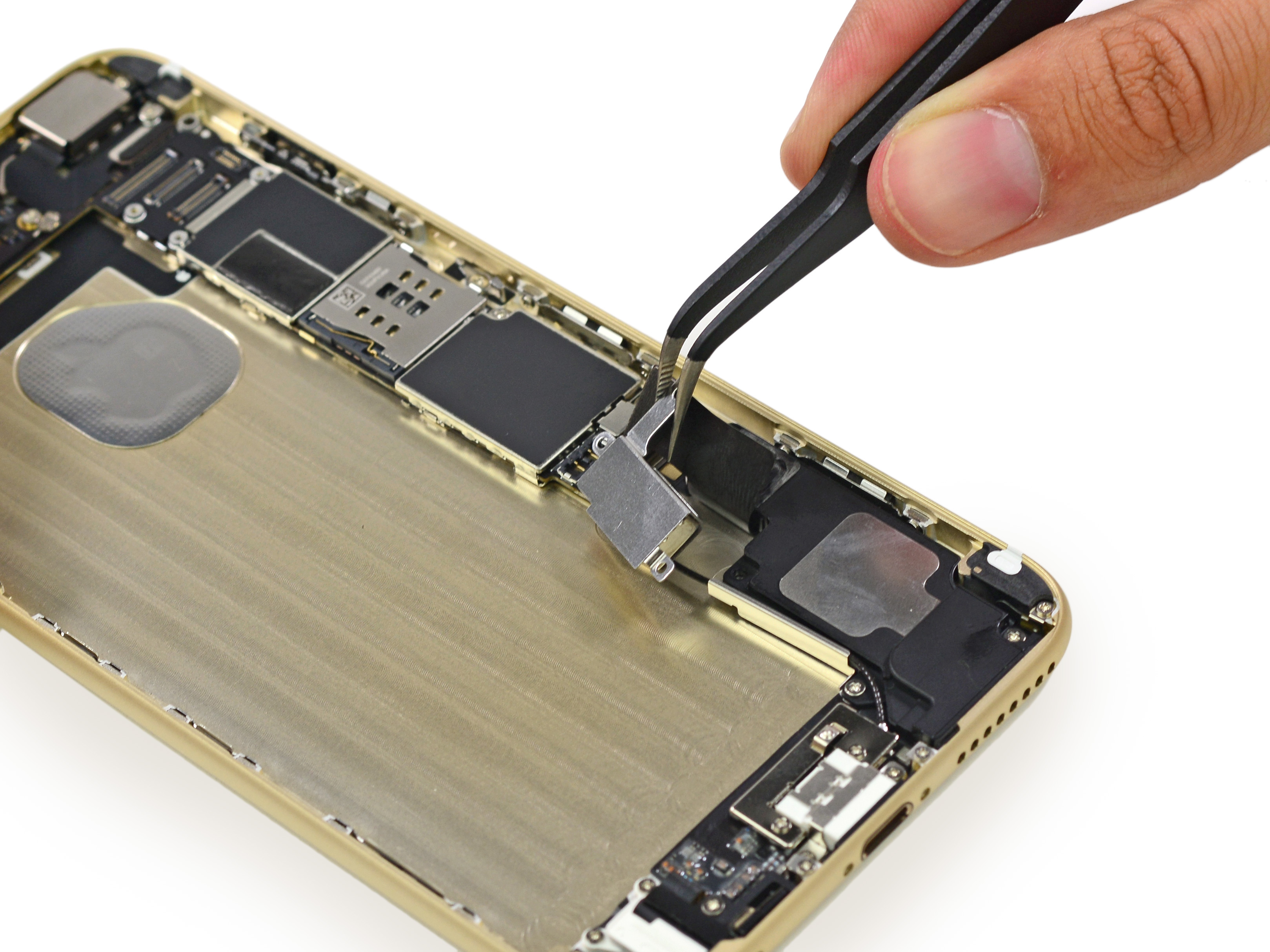

What do you think, how long will it take to make one complete Alu-case? I just thought about that recently when I was reading about the iFixit iPhone 6 Plus article ( https://www.ifixit.com/Teardown/iPhone+6+Plus+Teardown/29206 ). It seems that the metal iPhone hull is milled or at least partly milled. ( https://d3nevzfk7ii3be.cloudfront.net/igi/gphoSAywifZrXOxU https://d3nevzfk7ii3be.cloudfront.net/igi/mTp2hFEggGxOIM6P.huge ) Assuming there will be millions of these phones, how do they make that in recent time? Maybe they have thousands of Milling Machines in a row for that job, somehow impressive.
I'm going to resist making a crude joke involving sandpaper and low-wage countries ...
It doesn't look like it's hand made (look at the pattern inside of the metal, clearly machined). But of course there is still alot of pure hand work in the iPhone.
I'm not so sure if the milling process will be / was used to produce the cases directly. Much more probable is pressing and then brushing. Milling was probably only used to produce the dies into which the aluminium sheets were punched, and of course the draw punch itself, as it is MUCH more expensive to remove material from a block than to conform it into a die form (for 99% of practical cases)! :-)
Therefore, instead of "thousands of Milling Machines lined up", they have a single one or a few precise machines, that produce the dies for cheaper processes!
Pure milling would be used if just one or few units were to be produced. In this case, with an order of 100 units, it is hard to say, but probably is more profitable to produce one die / draw punch pair and mold sheets of alu.
In case of phone / computer manufacturers, where thousands, maybe millions of equal parts are produced, only a mad man would use milling to cut them from blocks opposed to conformation processes!
