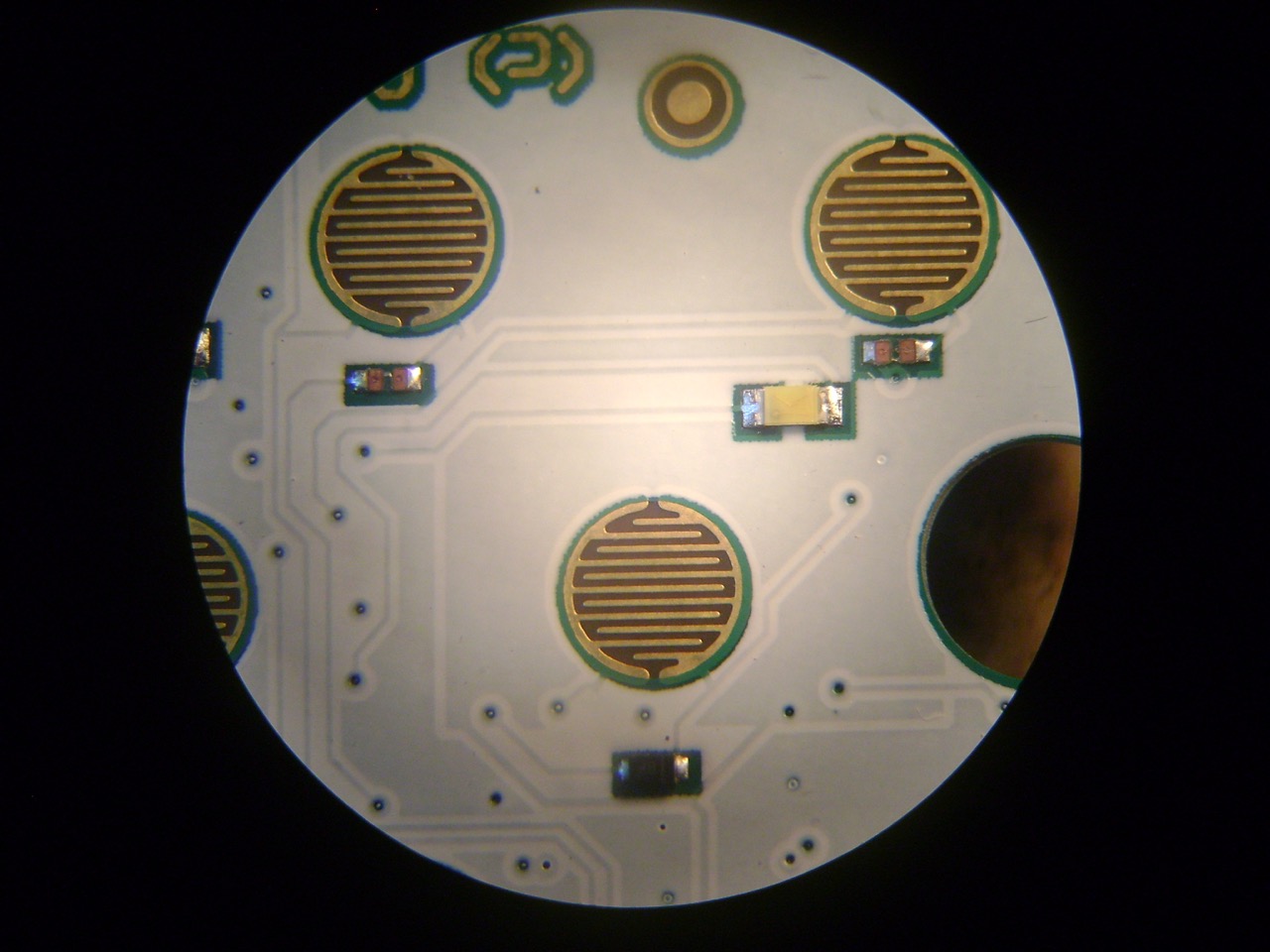

2. Keys: An issue where keys weren't working has been fixed by Nikolaus and is likely an issue caused by the testing equipment at Global Components as the diodes for the keys were broken off the PCB as pictured
This would explain why it's often the same keys that were affected. We will be reaching out to Global Components to get this fixed!

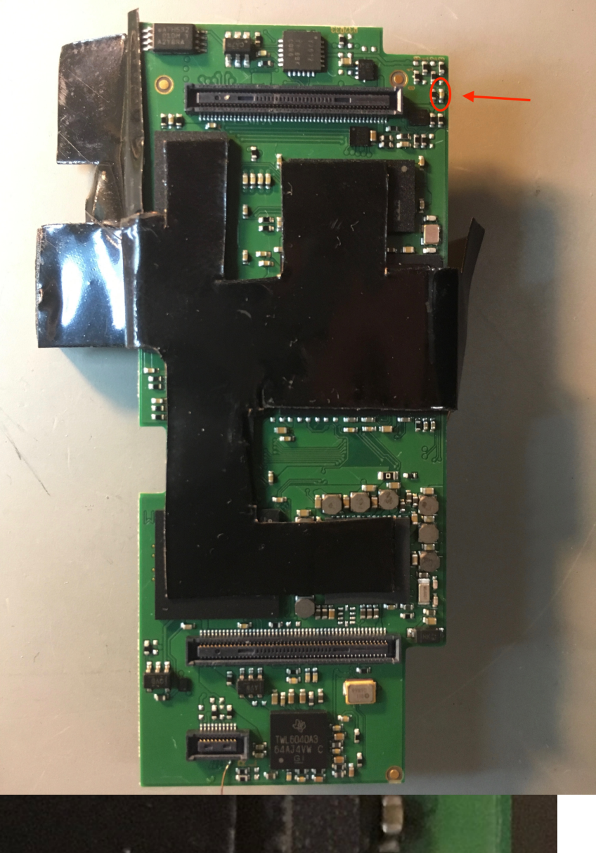

3. Boot issues when lid closed: When the lid is closed we found that the Pyra wouldn't boot which was caused by the OMAP5 debug mode which is triggered when one of the lid sensor or shoulder button GPIOs is closed when you turn the device on or put in a battery. We replaced the capacitor (As pictured below!) to one with a different value to increase the delay required. This can be fixed on prototypes and will be fixed for mass production.

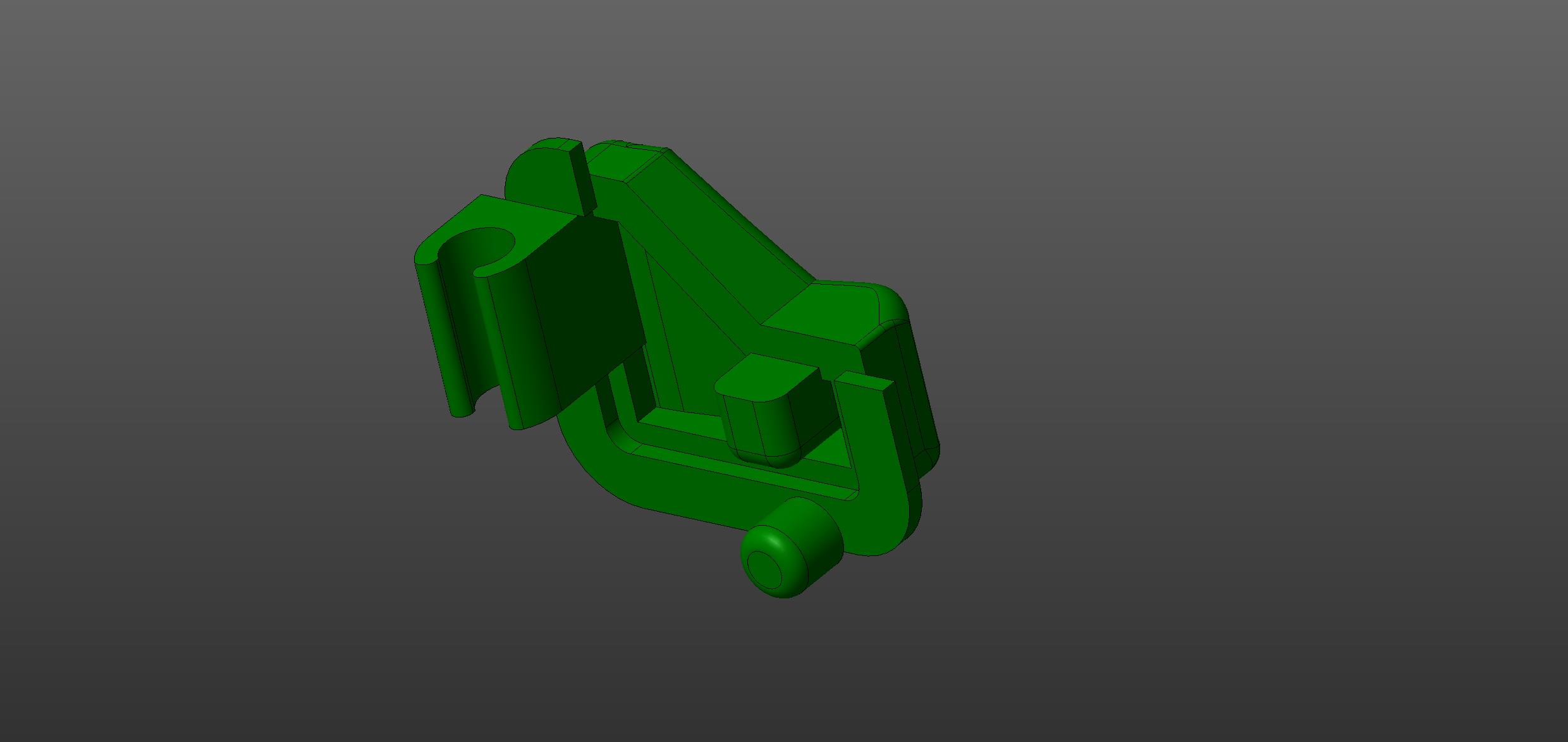

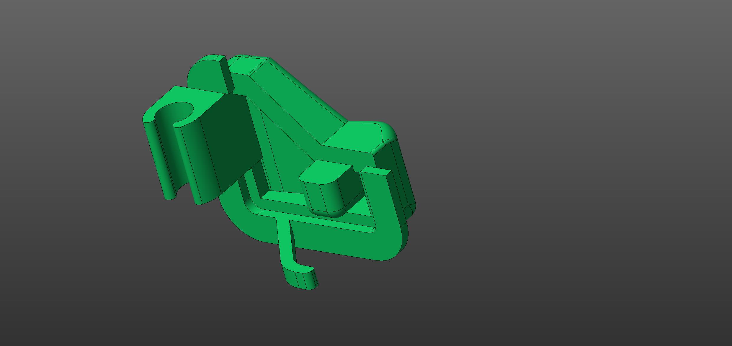

6. The case: The new case company has modified the moulds so that the top shoulder buttons can use a metal spring (Left) and have also fixed the data of the button with the plastic spring (Right).
