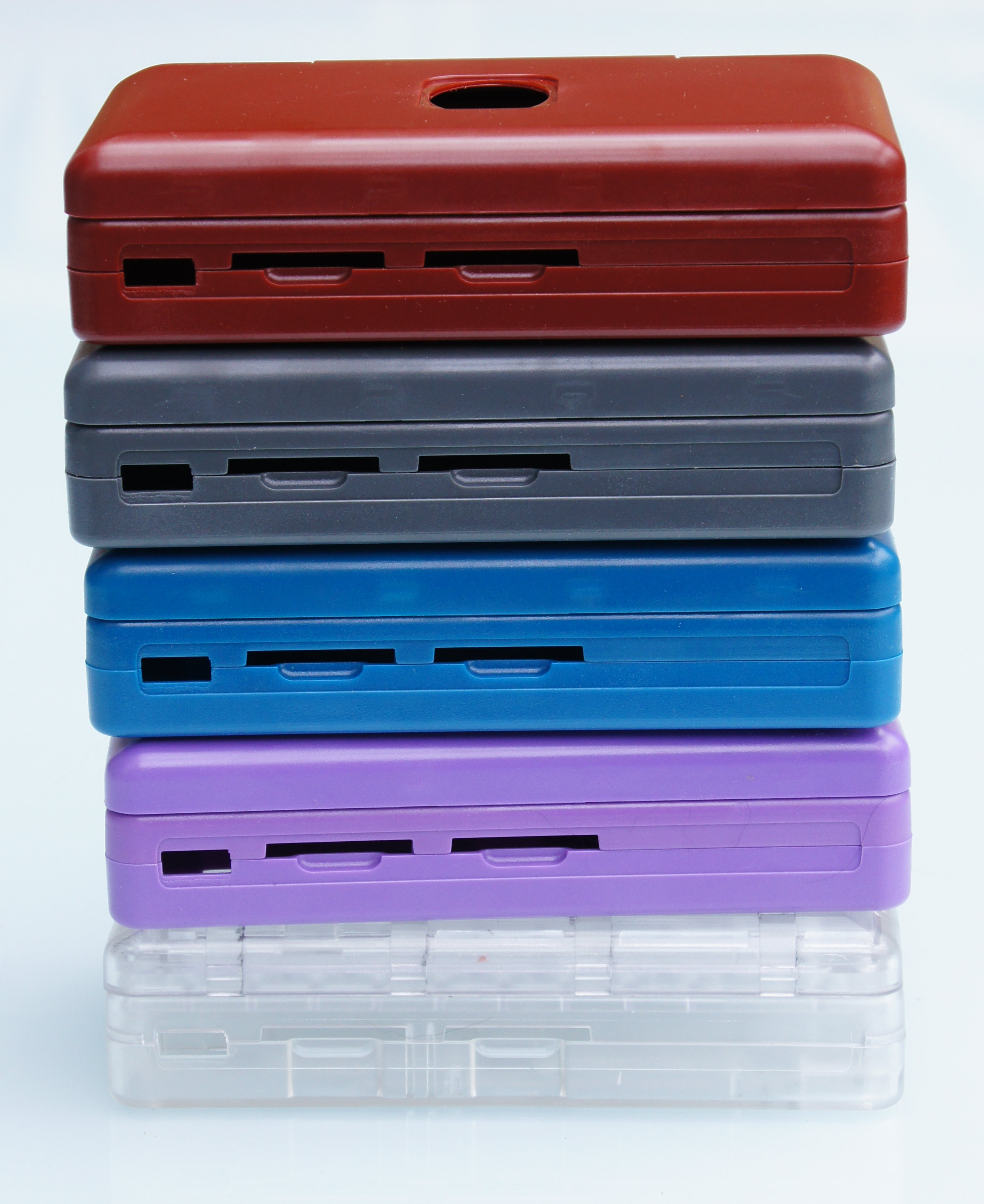

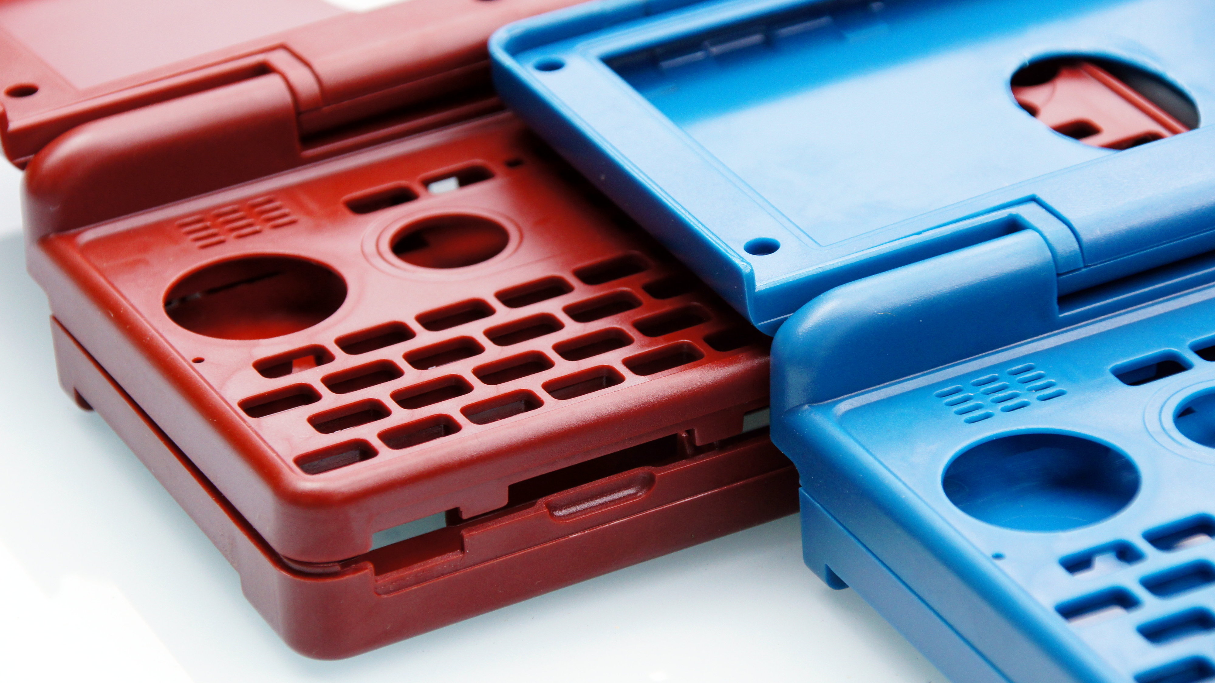

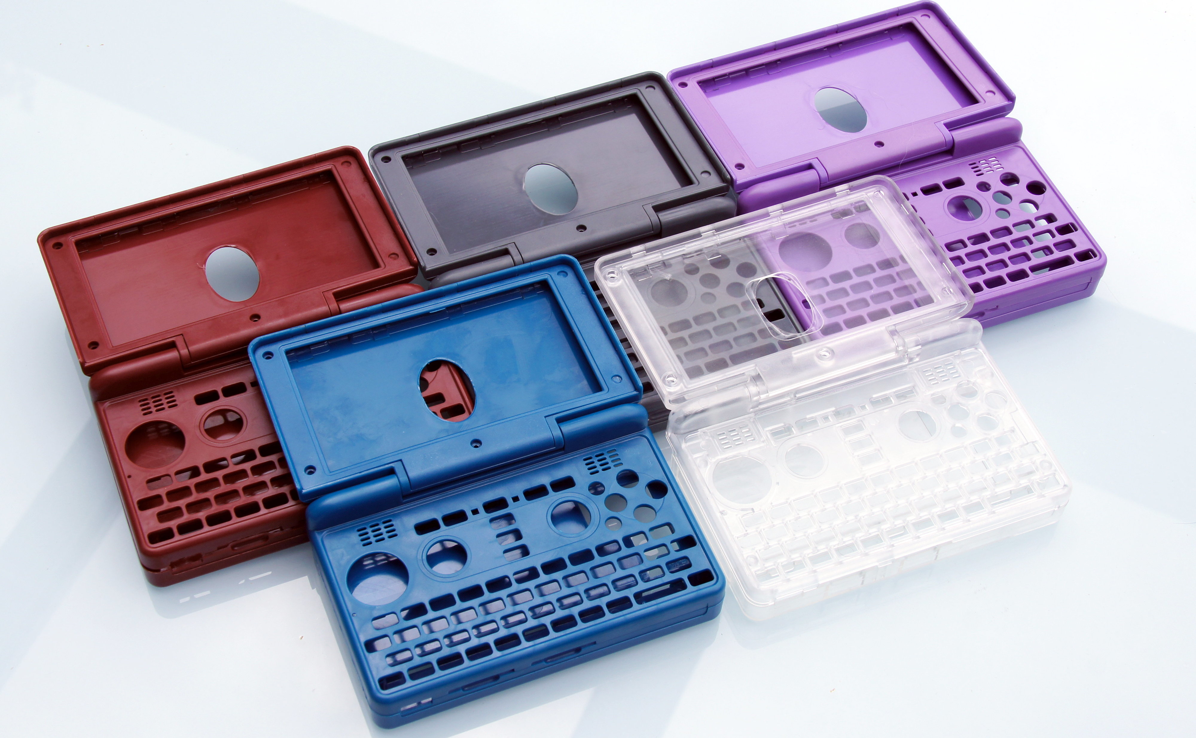

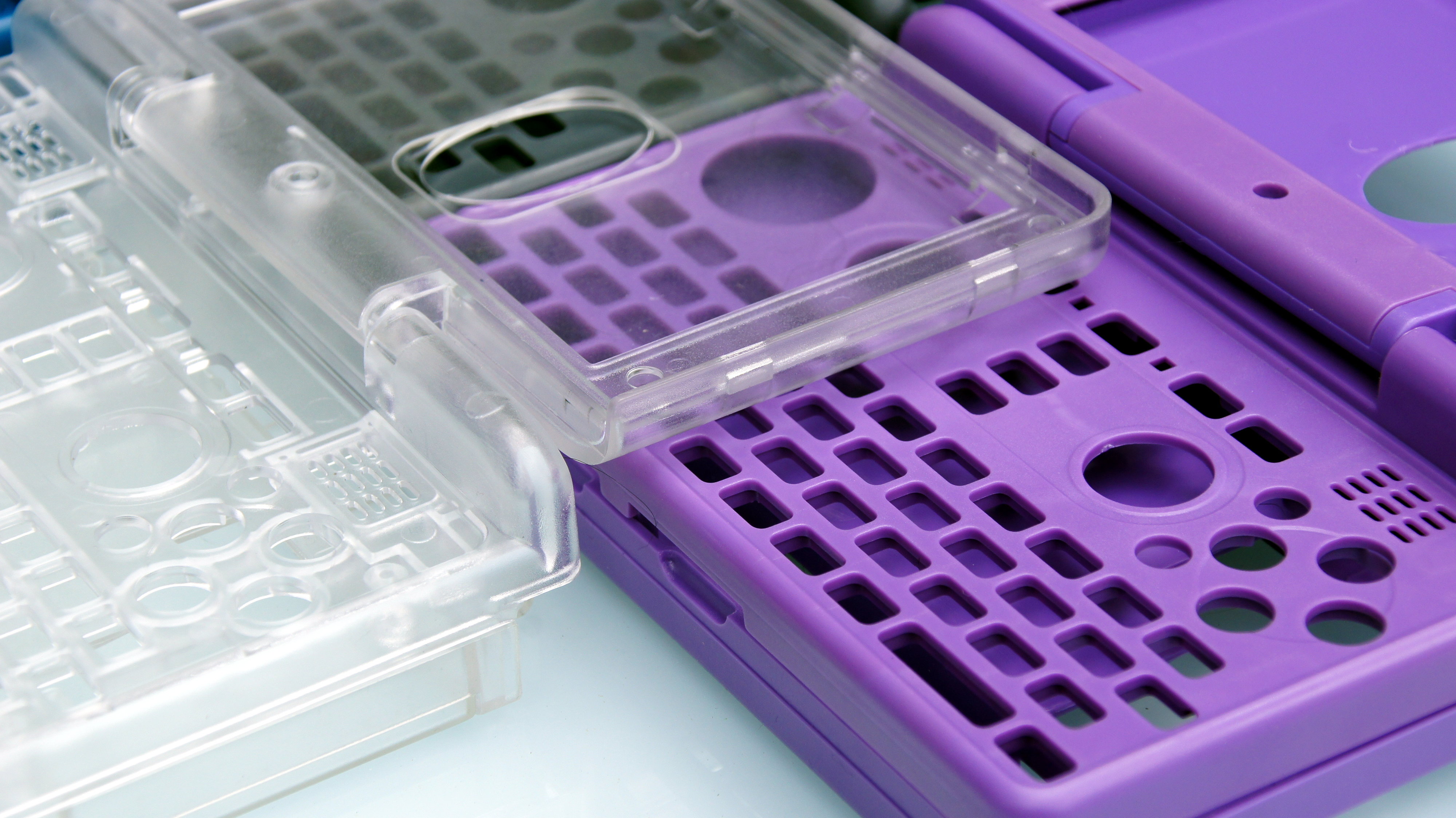

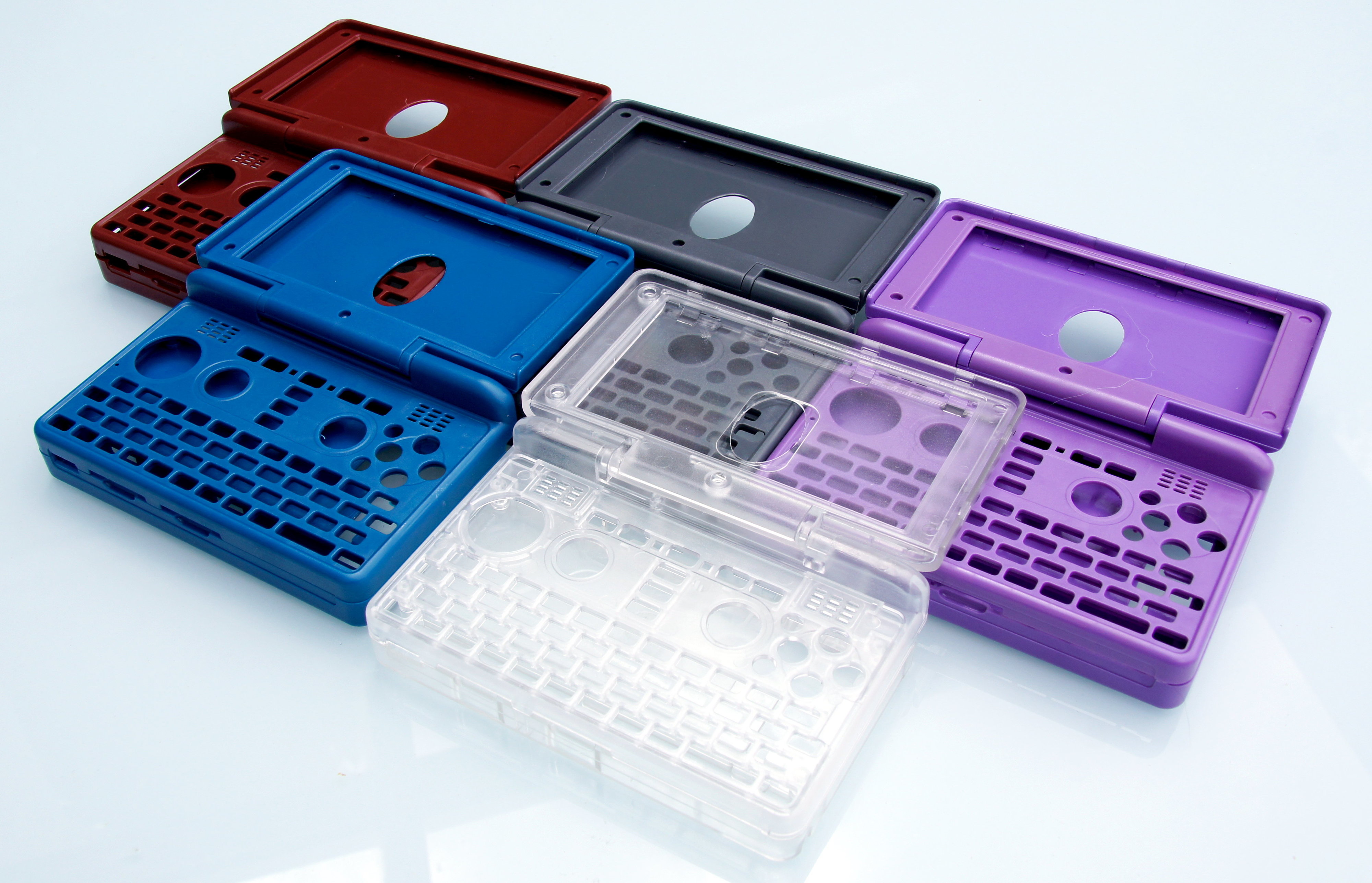

Getting proper colors is actually harder than I thought. Well, not harder: more expensive.
Black, Transparent and various vibrant colors you often see used in kids toys are easy to get: These are standard colors which you can buy in any quantities from the market.
However, if you want to get a REALLY good looking color (like dark metallic or non-metallic red, blue, or whatever), you need to get the color custom made from the manufacturer.
All RAL-Colors (http://www.ral-farben.de/en/PRODUCTS-SHOP/) are available, not only plastic ones but also effect ones.
There are some that really look gorgeous - however, the minimum order quantity is 1t. And that's quite a lot.
I still want to do an awesome looking color version at some time, but maybe that'll have to wait until the first batch is out - or we could do some Kickstarter / Indiegogo for that.
Nevertheless, here are pictures of four standard colors have right now:
The red, grey and blue one looks okayish... but still not what I imagine as awesome looking color
But black is always a proper solution, eh?
