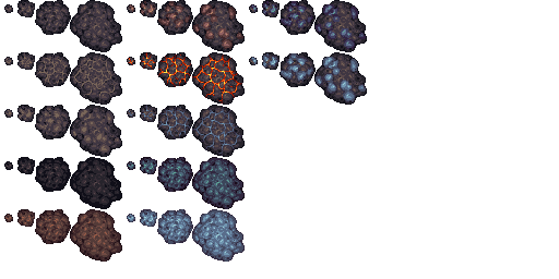

Themed asteroids incoming!
Now I just need suitable backgrounds... :p
Oh, also keyboard support for high scores and other smaller fixes.
Not yet but soon.
Lava-Planet in the bg for lava rocks, Ice Planet system for ice rocks?  There are many beautiful space pix, I'm sure something will fit into these themes. ^^
I'll go by what both fits the theme and offers enough contrast. Lots of nice suitable pictures here. IIRC the license is Public Domain as well. Need to check before using :)
Hmm yeah, played again and I was able to build up my Pulse level freely, but it would seem as if something kept resetting my laser and beam level to 1 (my Spread level also ended up less than half of my pulse level, but I never spotted that going backwards). Are there some powerups that reset other levels to 1? I've not managed to catch it happening red handed, but I suspect one of the ? powerup possibilities may do that.
I don't think it's anything to do with Notaz' SGX now - just that now I can tell them apart I'm paying more attention to what they do perhaps.
