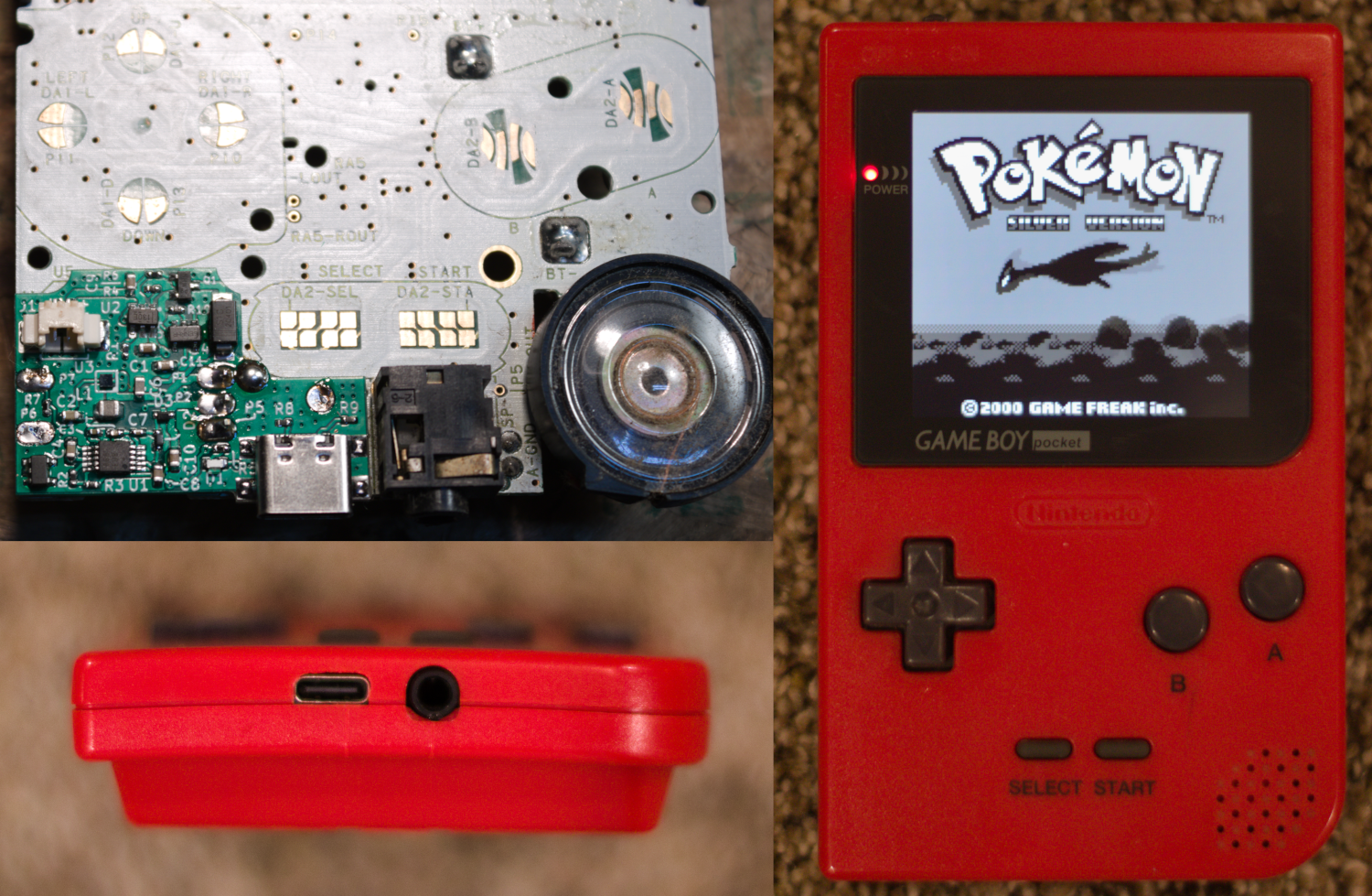

I designed a mod for the gameboy pocket! I'm pretty pleased with how it turned out honestly.
It's a USB C and replacement regulator for the pocket. The thing I think is the neatest part of it is that it just solders in place using the existing solder pads on the gameboy.
I've got a more detailed write up on it here
That is pretty cool! Actually, could this be changed easily to work with the GameBoy Color?
McWill's LCD Mod includes a charging mod as well - however, it does not replace the full power circuit of the GBC, which is pretty flakey.
My own unit doesn't start anymore when I add the Charging mod and the new LCD.... it works if I only use the new LCD or only the charging mod with the old LCD, but both doesn't work.
And some customers had the same issue... so that circuit would need to be replaced.

A GameBoy Color version is actually in the plans! I've ordered the first batch of 50 for the gameboy pocket, so while I wait for those to arrive, I'll probably start development of the Pocket Power Color. Originally, I was considering not bothering with replacing the power circuit, since the Colors I have have been pretty rock solid, but, if that's actually an issue, modifying the Pocket version wouldn't be too terrible. The GBC just needs 3V, 5V, 13.6V, and -15V instead of the Pocket's 3V, 5V, and -18V rails.
I'm definitely interested in working with you! I have no good way of getting these to europe, and I'd love for people to have it there as well. When I get the design finalized, or close to finalized, we ought to discuss an arrangement of some sort.
