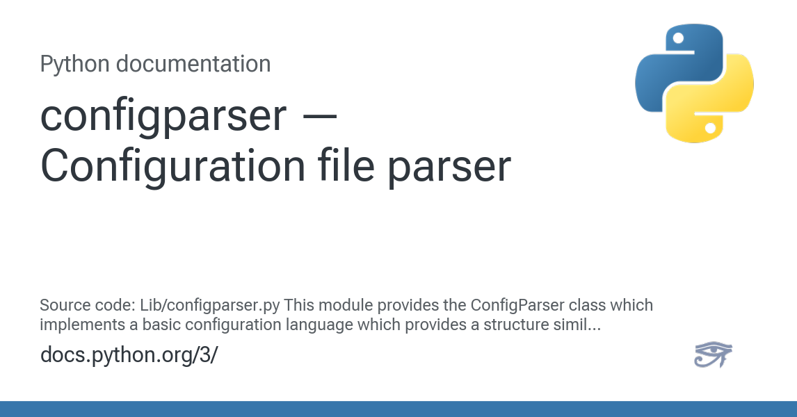

Options.txt has a horrible format. Stick to a format (yaml, ini, conf) and make comments start with #
I like the ini format a lot, why don't you use that?
And rename it to options.ini or vid_dload_ui.ini
I'm fine with my format, why don't I use that?
