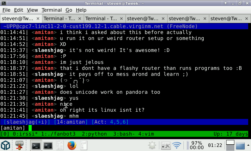

Not sure I like it :p
That's because you missed the point of putting a 4:3 screen in a device of this form factor ;)
- Neelix
