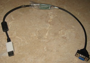

I have a serial adaptor for my dreamcast from back in the day and have experienced the slow data transfer speeds, but it does work.

it looks like this:
