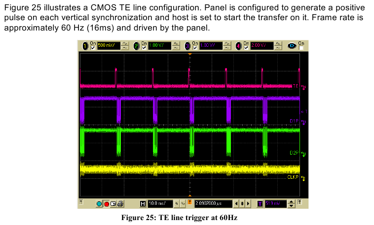

Can the rotator chip be configured to generate the TE (tearing effect) signal on vsync? According to this PDF the OMAP can be configured (3.1.2 CMOS TE line) to send video data when triggered by the TE signal from the panel. If rotator chip can generate that signal then that would fix the issue, I think.
Of course, that PDF is all the knowledge I have about MIPI, so probably I'm talking nonsense. :lol:
