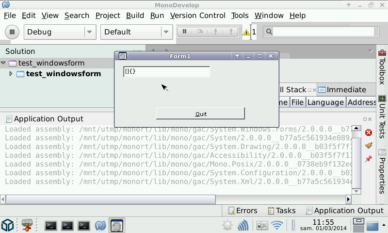

The VB compiler seems to be missing, and the tabs in MonoDevelop still do not display the filenames.
I also noticed that you have the same bug in Mono sebt3 had (or are you just using his build?) where if you make a .NET form with a Textbox in Visual Studio and run it via mono, you can't type brackets into the app

You cannot type [ and ] in Textbox ? Every Textbox (from gtk too for example) or only the one from .NET ?
Also, no VB compiler in Mono to my knowledge, only C# (but should be able to run VB.NET already compiled code).
Just from .NET as far as I can tell so far.
Sure there ishttp://www.mono-project.com/VisualBasic.NET_support
Edit: Don't worry about the VB.NET support - I can code in both; just used to the VB syntax more
Ok, for [], I'll try to take a look...
For VB compiler, I'll also take a look, but the VB compiler is writen in VB.NET, so I have to see on how to do (chicken and egg problem, but I suppose I can always just use precompiled binaries ;) )

Hum, I tried an EditBox in a GTK# solution, but I can enter bracket without issue.
And MonoDevelop don't have Wizard to create new .NET solution...
I'll try to fireup my VS to create a dumy test to try tomorrow (I suppose the issue is linked somehow with the keyboard mapping that are defined in the Windows.Forms class ressources, but I'm not sure if it's there and how to read / write thoses...).
*EDIT*: ok, the ressources to create the keyboard mapping tables are only available on the git of mono, not in the tarball of stable release... Still, I need a samble first, than understand which keymap is used before trying to add Pandora keymap...

Hum, I created a windows form sample from a Visual Studio C# 2008 (so .NET v3.5), compiled it on the Pandora, and I can enter brackets in EditBox...
I don't reproduce the issue, so @pmprog, I need a sample from you to be able to (try to) fix it.
That screenshot only has square brackets and braces - no normal brackets - ( )
Ah, oups, didn't tests thoses, I was sure problems was with square brackets... Will retest...
