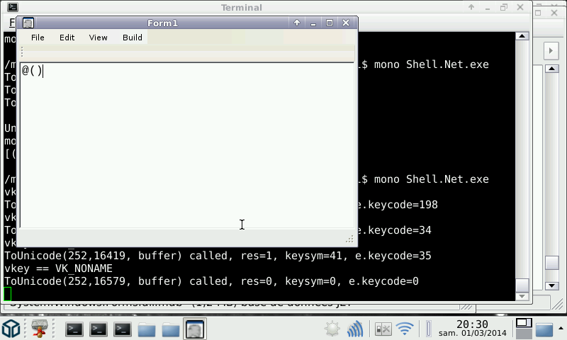

So, the problem is around a function called ToUnicode that is inside mcs/class/Managed.Windows.Forms/System.Windows.Forms/X11Keyboard.cs (around line 430, depending on the version).
By putting some trace like
Console.WriteLine("ToUnicode({0},{1}, buffer) called, res={2}, keysym={3}, e.keycode={4}", vkey, scan, res, keysym, e.KeyEvent.keycode);
I have seen that all non-working keys are just not recognise, and have a vkey = 252 (i.e. NONAME).
I could try to fully understand how it works and fix it the right way, or do it the quick and ugly way.
So I choose the 2nd  :P ...
I get all "scan" code for the non-recognises keys, using the keysym value from the X11/keysymdef.h, and add a switch just after the last check

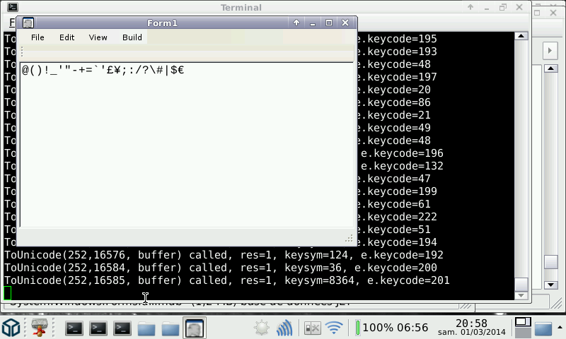

if (pandora!= 0)
e.KeyEvent.keycode = XKeysymToKeycode(display, pandora);
And it seems to works...
