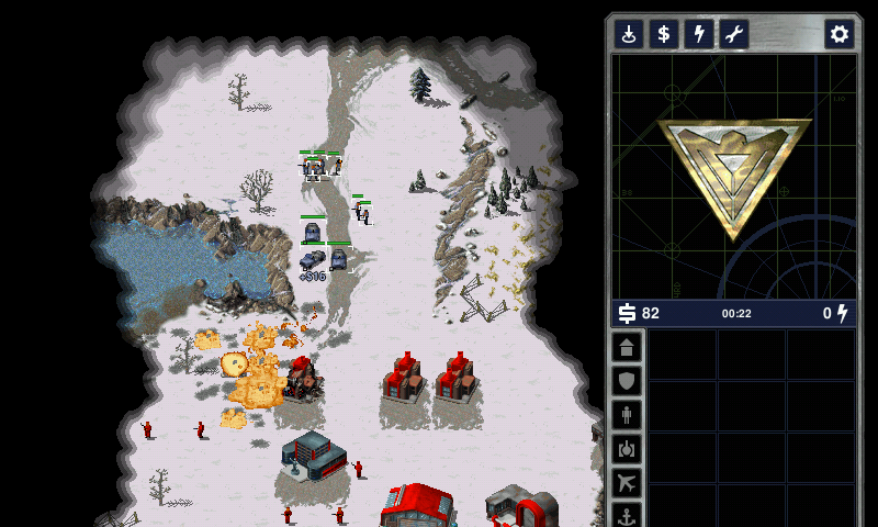

Here is OpenRA, the open source re-implementation of Red Alert and CnC games
This PND use the MonoRT pnd, so be sure to have it installed (i.e. simply copied) on your Pandora.
The games is an OpenGL 2.0 game and use the new experiemental GLES2 backend of gl4es.
Also, beeing C#, the game can be a bit sluggish at first, when the JIT trigger. It should be smoother after the initial hickup.
/!\ You'll need a swapfile for this game, for any Pandora model /!\
/!\ While it seems playable on Gigahertz model, it may be too slow to be playable on other models /!\
You can use CD data or let the launcher download datas.

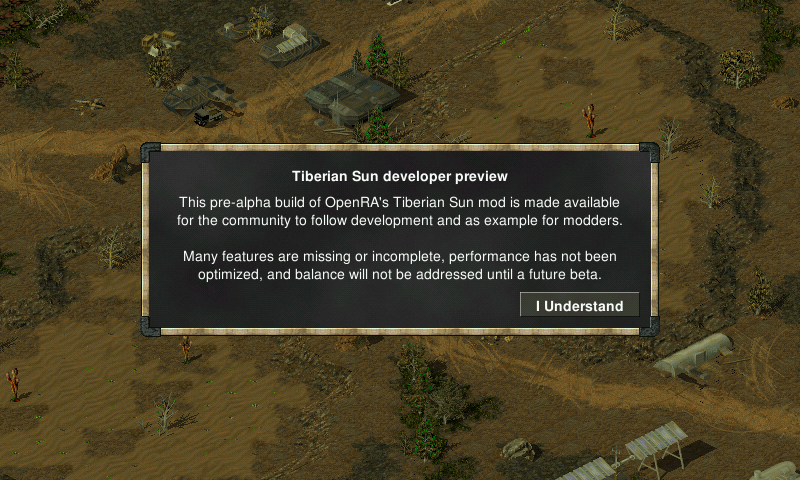

  • Added Tiberian Sun WIP Module

@ptitSeb did you compile this with all mods supported? I read that the engine already support tiberian sun and ra2, but you have to compile it with some extra flag set.
thanks a lot anyway! this is pretty awesome.
No, I haven't added the WIP Mods. But I can have a look at them if it can be usefull?
___
Advanced Member
Jan 31, 2006
3,376
that would be great. I'd love to try how far ra2 is already developed. judging from what I have seen, the skirmish mode is pretty much done and I've been dreaming of a portable ra2 for a long while :D
