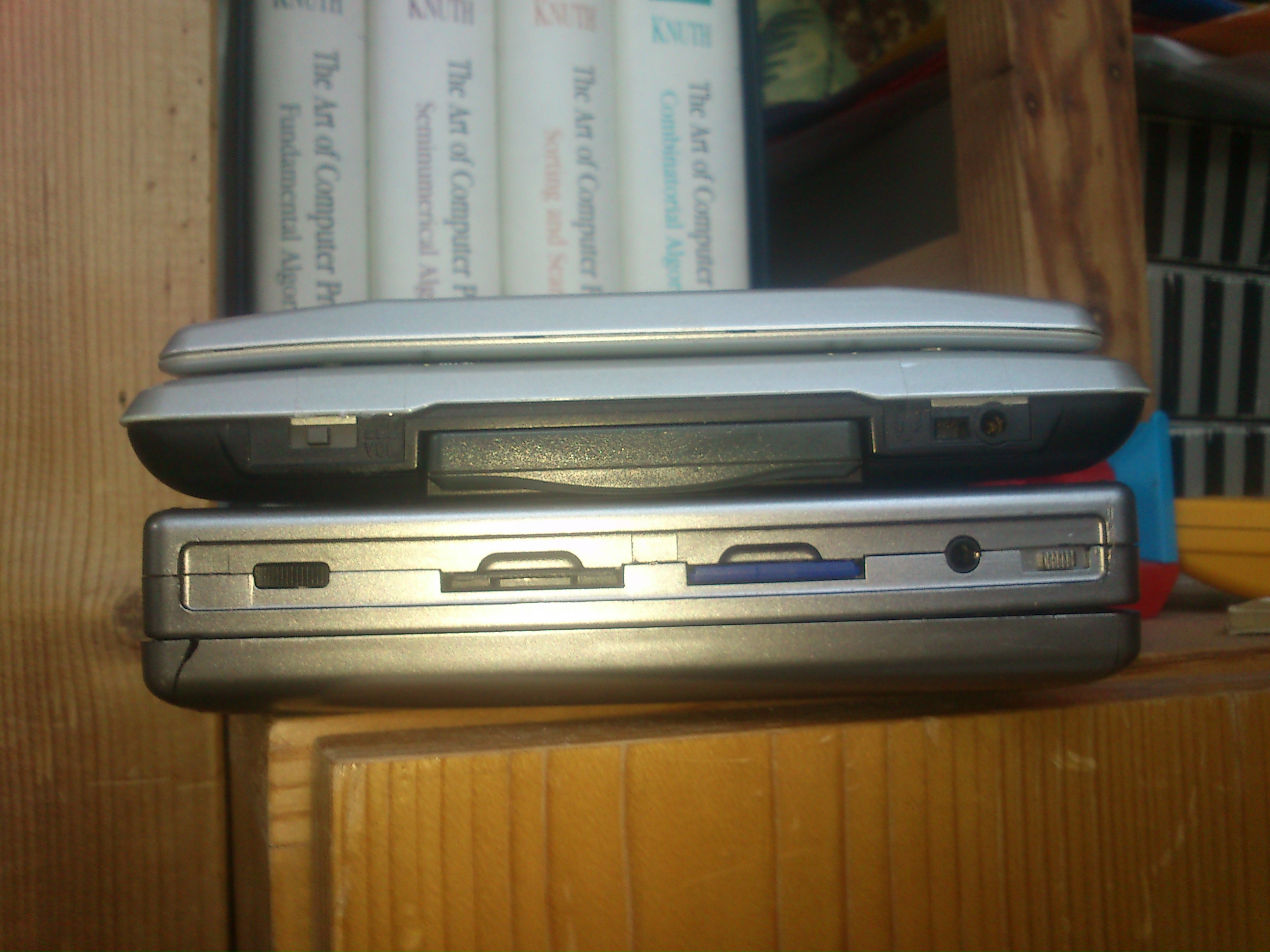

@EvilDragon Is the SD card fully inserted? If yes, was it intentional to make it stand out like that? Do you take it out by pushing it?
Nice video, please keep tweaking Pyra till it be the best it can be.
Yes, it was fully inserted. We had to change the SD card slots shortly before we produced the PCBs as the old ones were out of production and didn't see that the news ones were a bit different physically.
That will be changed with the final boards, we'll simply move them back a bit.

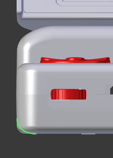

Is it still possible to make the edges thiner and rounded like on the Original Nintendo DS (Which is exactly as thick as the Pandora but wider than the Pandora but still fits into my front pocket nicely BTW)?
Or how about only changing the Bottom Mould for minimum Thickness? Maybe as Stretch goal?

Is it still possible to make the edges thiner like on the Original Nintendo DS (Which is also thicker and wider than the Pandora but still fits into my front pocket nicely BTW)?
the plastic molds which cost 10's of thousands of Euros are already made, changing them now would be costly.

But rounding the edges could make the Pyra even thicker (as adding material is easier than removing), so I'm not sure if thats a good idea.
Depends on how you do it. If there is some space left at the insides, the rounding could be more to that side. I see some mm space, not much but could be used (the battery limits that space of course).
Like that, just a little bit, but can make a difference:
As far as I understand it, the problems would be the molds. You can add material relatively easy by removing material from the molds. But if you want to to remove material from the case, you have to add something to the mold. If the need of ventilation slots may occur, you perhaps can solve that with some inlays, but just for a bigger rounding radius it probably will not be worth the extra hassle (and money), i think.
