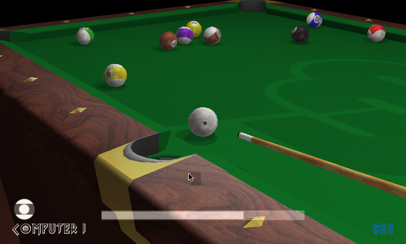

Here is Foobillard, a full featured billard/pool games (with sound).
The Game is fully functional, but the reflection on the ball eat some CPU (the GL_SPHERE_MAP needs neon code optimisation).
Also, in the option, you should not change the reflection to "RENDERED" has it need CubeMaps not yet implemented in glshim, nor "RENDERED+FRESNEL" that also need CubeMap and NV Shader.

Nice, runs at a decent framerate on my Ghz pandora at 1Ghz.
No offence though, but how do you play this?  I can spin the table round with the arrow keys, select power with up and down (or pgup/pgdn), make the cue appear with C (and also move the camera to it sometimes), and shoot with enter or space, but I can't figure out how to aim, and having aligned the camera with the cue with C, can't work out how to move the camera up off the table again.
Also, if I close the lid when in game, the screen doesn't come back on on reopening it, and I have to reset.
This one is very mouse oriented. So use "middle button" to shot ("mouse button nub" down). It plays much better with a real mouse attached.
Ah right, just figured out that I can look up by holding down left click and moving the left nub, and zoom by holding right click and moving up and down on the left nub.  Still can't aim though.

But the Left button is the one to aim. You then choose power with the wheelmouse or Up/Down, and middle button to shot.
Ok, so I've done something. I find the Control usable now on the Pandora:
Build 03
  • Added usable keyboard control
    Use DPad to aim
  • Use {A}/{B} to change power
  • Use {X}/{Y} to Zoom In/Out
  • Toushscreen still usable to finetune the aim
