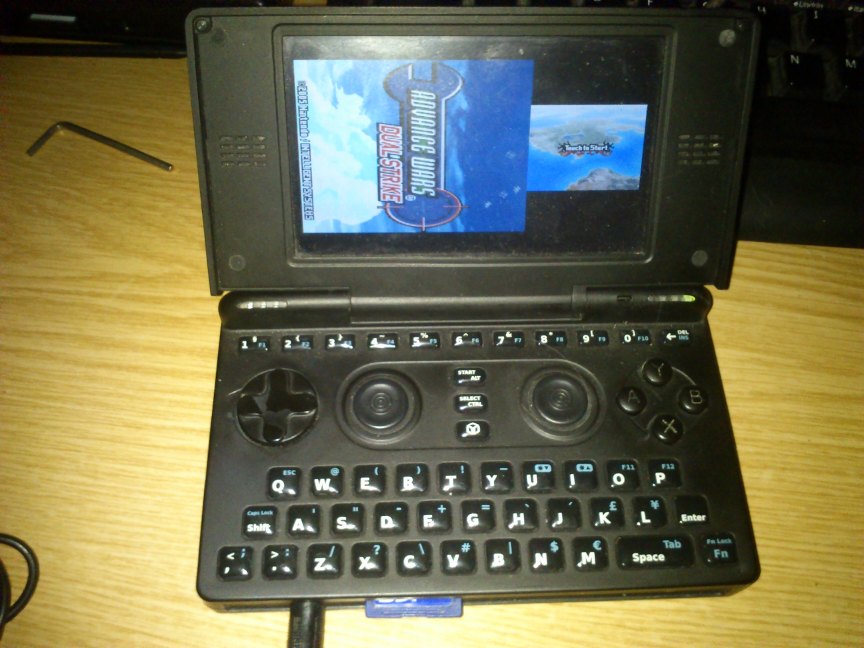

The software rotation is probably not a huge deal since the emulator does a final conversion pass on the scanlines, just need to do rotated versions of those and the performance hit won't be that much. It's probably more work actually setting up the screen parameters to match it.
Well, there seems to be some hardware support for rotation in the OMAP overlay featureset.
Maybe an opportunity for notaz to patch up his SDL once more ;)
http://omappedia.org/wiki/Bootargs_for_enabling_display#Mirrorring_and_Rotation_of_OMAPFB
Hmm I wasn't aware about DMA rotate capability, and it works on OMAP3!
Currently there is no way to enable it without root and there is no ioctl to do it, I'll need to think how to expose it to applications.. (which means firmware update will be needed).
Haven't noticed any bad effects on performance.

Okay you are clearly going to need to tell me more about what you did here ;) (or maybe you left it in the channel and I'll see it when I get home)
Yay, Advance Wars DS! :D  This could work well, you can play the game with Stylus, not only D-Pad and buttons (these of course would be not that great in rotated mode).
