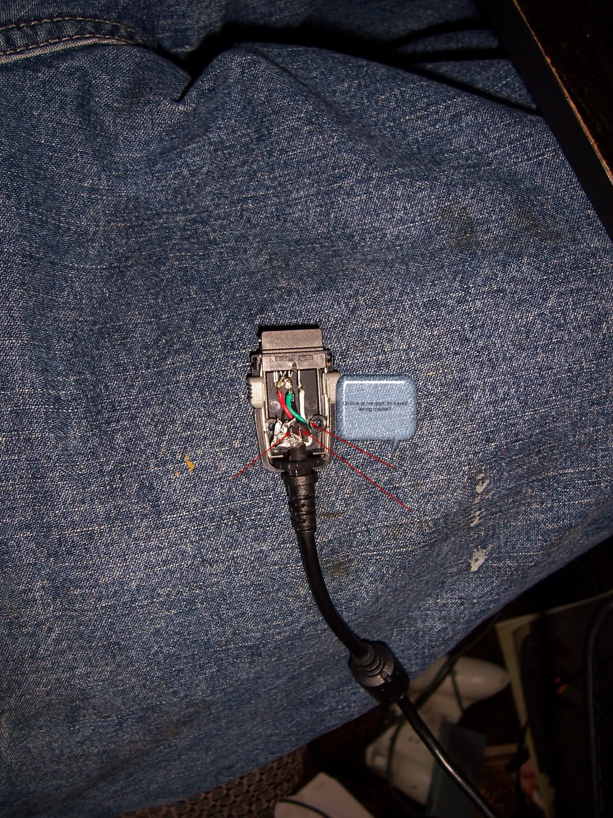

opened it up to take a peek and saw some loose silver wiring or something, go max zoom you can do to see it, put arrows on them, anyone have a working USB they can post a picture of, also is this USB specifically for the wiz or is there another cable out there that will fit it.
Those wires look a mess alright. Red and Green wires soldered together (is that normal?)
Cant tell about the "fraying" looks like some of the USB wires have been cut back.
In fact i'am no wiring expert but can you even transfer data with only 3 connections?
This looks like a charger only... In face it would be worth checking if this is an offical wiz product and not a phone charger.
I've got a USB mains adpaptor for when I get mine but if the wiring is like this I won't be plugging it in!

Those wires look a mess alright. Red and Green wires soldered together (is that normal?"]
What did you do to open it up?
Oh and clean your jeans you mucky pup :D[/quote]No wire expert either, so no idea.
This is an official wiz product, it came in the retail packaging and everything. The usb male part has GPH logo on it as well.
as for my jeans sir, jsut got off work :P their stained with machine oil and paint :P
Oh and clean your jeans you mucky pup :D [/quote]I'm not an expert either but it looks like there are 4 wires there, which is sufficient for USB - D+, D-, 5V, and ground. Charging is working okay so the 5V is probably connected fine. The frayed wires and foil parts are shielding from where they cut the cable, I think it's pretty normal for a hack job like this. But the other cables look like they were soldered poorly like others have said.. then again I've never soldered anything in my life, but I can't imagine that the red and green and possibly black are NOT shorting.
The colors are supposed to be:
Green: D+
White: D-
Red: 5V
Black: Ground
Assuming that the wires are going to the correct EXT port pins in the first place.
It seems to me like you can scrape away some of the excess solder then wrap Kapton tape or somethnig else that offers good insulation around the ends, then perhaps tape them down/apart from each other. So long as you're careful not to snap anything that should clean it up, but you'd probably better listen to someone who knows what they're talking about instead of me.

My wiz cable came through in a the same crappy condition as yours last week, it would shut my pc off when plugged in and not even charge the wiz. I tidyed mine up and wrapped some tape around the cables to ensure they weren’t shorting each other out, it works fine now but was annoying to have to hack a brand new cable to get it to work .;)
Sorry, I only saw 3 wires there.
Didn't see the black one. :huh:
Long day staring at a screen doing graphics.
Need eyes tested!
