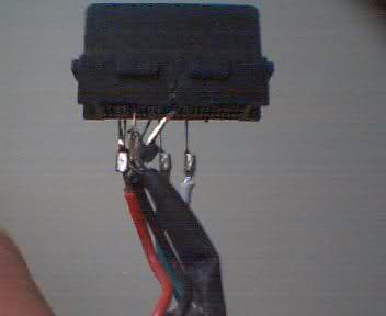

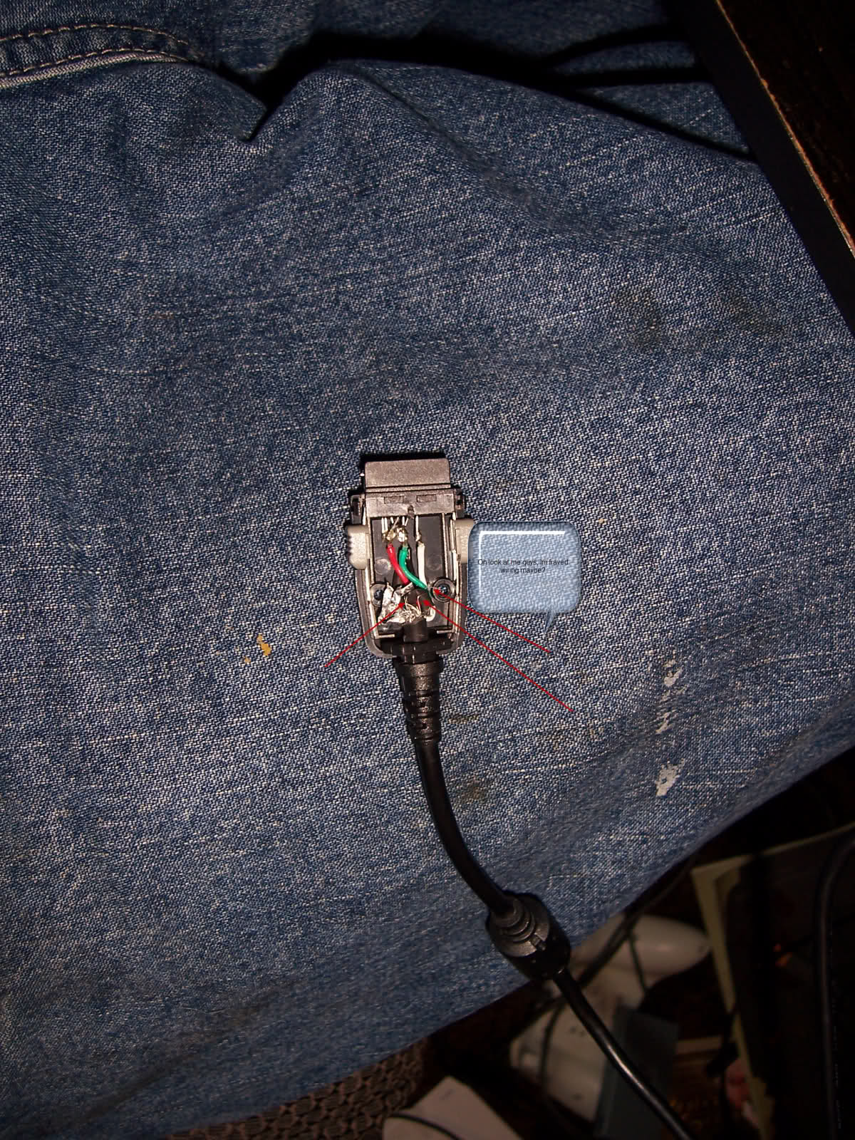

opened it up to take a peek and saw some loose silver wiring or something, go max zoom you can do to see it, put arrows on them, anyone have a working USB they can post a picture of, also is this USB specifically for the wiz or is there another cable out there that will fit it.

I believe your lead is soldered wrongly.
Nevermind about frayed wires - I believe they are just some of the earth or shielding from the black wire, quite normal, and as long as they aren't touching any of the metal of the other 3 are ok.

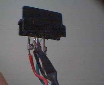

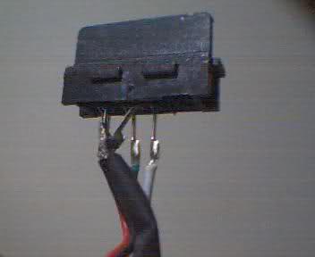

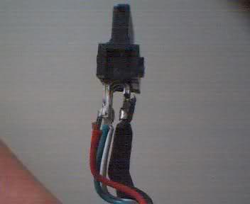

Got my Wiz yesterday, my USB lead didn't work. I took it apart, my red lead wasn't connected! :wub:
I soldered it, it works.
I took photos of mine to show my black wire green wire are reversed to yours.
Sorry for poor lighting. The same side as yours is showing on the first 3.
